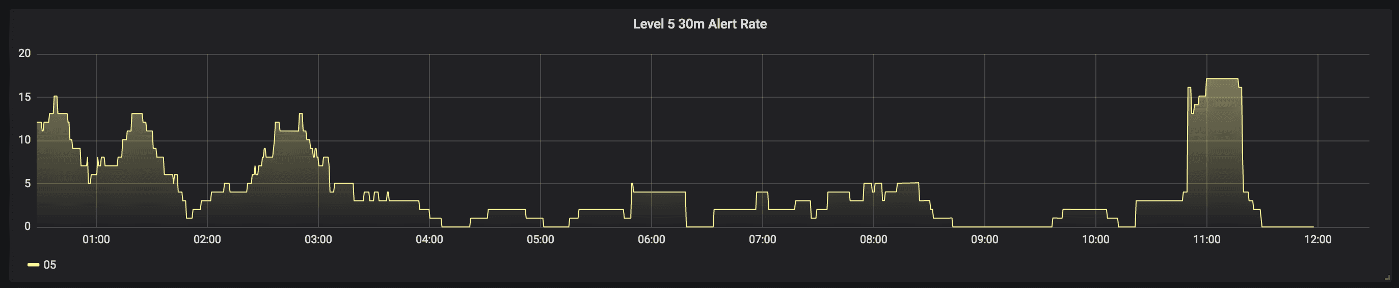

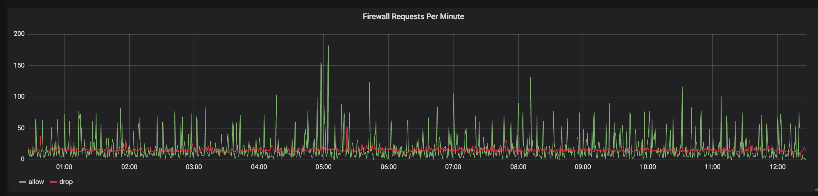

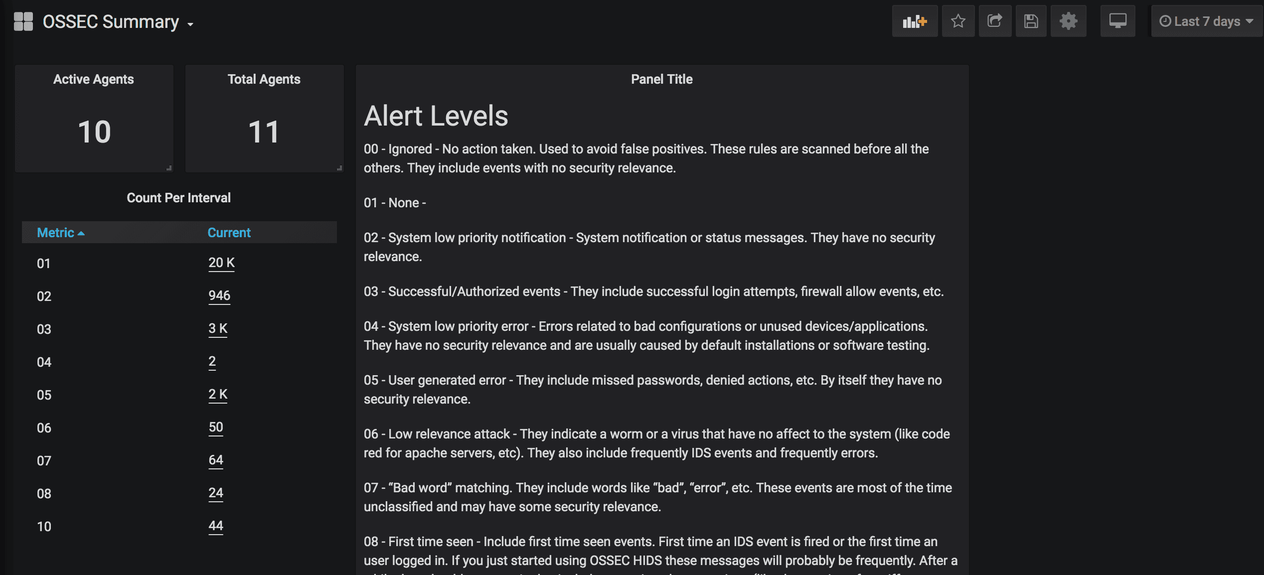

In other words, no more logging in via ssh and combing through logs to search or view alerts!
Here are a few examples:
Embedded imageEmbedded imageEmbedded imageEmbedded image

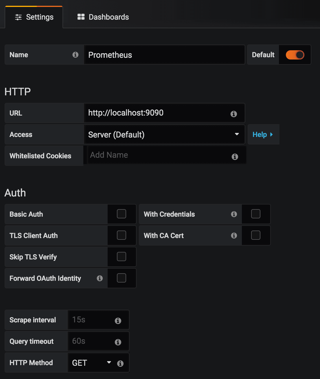

Log into Grafana and add two new datasources. First a Prometheus datasource:
Embedded image

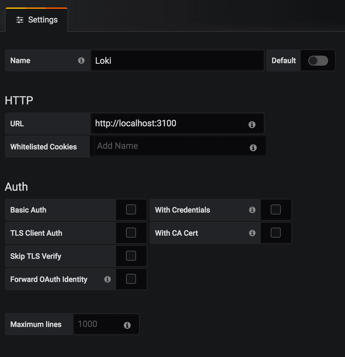

Then a Loki datasource:
Embedded image
Now you can import the two dashboards I created by hovering over the + symbol on the left panel and selecting Import.
For the OSSEC Trends dashboard, paste this JSON and load and save the dashboard.
For the OSSEC Summary dashboard, repeat by going to the + and Import, pasting this JSON.
