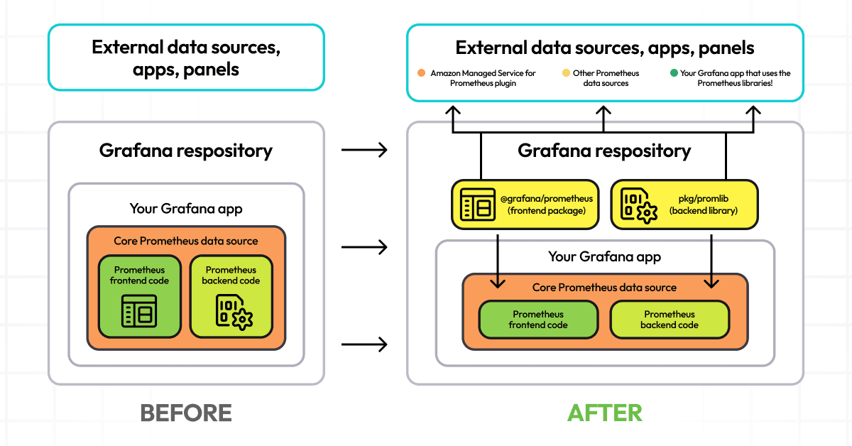

Embedded image
The challenge at hand
The Prometheus data source has long existed as subfolders inside the Grafana application. It included all sorts of code from Grafana, and over time the data source made its way into many features related to our OSS projects, including Grafana Loki, Explore, and Grafana Alerting.
The code, however, couldn’t be reused outside Grafana, so over time custom configurations were added to accommodate third-party vendors. For example, the code config had logic that enabled AWS users to create a Prometheus data source connection inside Grafana to query their Prometheus data in AWS. This code lived next to generic Prometheus code, even though AWS authentication was related to Amazon managed services, not OSS Prometheus.
But when the idea was first proposed a little over a year ago, there was reluctance internally because of the heavy lift and requisite code changes. In fact, Grafana Labs had never undertaken a rewrite of this scale before. There are ~70,000 Prometheus queries in Grafana every day, and we were essentially suggesting that we tear out all the guts and put them somewhere—all without impacting that high volume of people who relied on it every day.
Building a POC
We began with a research spike and proof of concept. POCs are critical for this type of work, as we needed to show stakeholders that it was actually possible. We also needed to establish a reasonable estimate of the work that would be required, and we needed everyone to have confidence that it was the right move.
We used the existing code scaffolding to support the creation of new external data sources, such as the Amazon Managed Service for Prometheus plugin. We copied and pasted the core frontend code and the backend code into the new data source. We also eliminated over 250 import errors, and we created workarounds where those fixes weren’t enough, which will be addressed in the months ahead now that the code is stable.
We configured the data source successfully. Then we successfully queried the new data source, proving the work was doable.

Splitting responsibilities and cutting code
Once we got buy-in from the rest of the org, we decided to split the duties so we could work simultaneously. (Brendan on the frontend; Ismail worked on the backend.) This decision saved us at least six months of time and gave us additional confidence knowing two sets of eyes were checking the changes.
Along the way, Ismail removed more than 3,000 lines of legacy code, which improved readability, reduced the size of the codebase, and ultimately made it easier to maintain.
We looked at multiple ways to separate the frontend and backend code:
  1. Create a separate repo only for backend code
  2. Move all the frontend and backend code into an entirely new repo
  3. Create workspaces
We went with the third option, as the other two would have created more problems. As a result, we introduced GoLang workspaces to the grafana/grafana repository for the first time. We started by making a small package as a module to test, then we updated our build pipeline in Grafana and our linting code. We also made a Prometheus backend as a module and iterated from there.
By having Go modules, we improved our grafana/grafana repo and allowed other engineers to have their own modules inside grafana/grafana. So while the code is still in one place, it’s separated thanks to go workspaces, giving us separate versioning and total control of our code.
