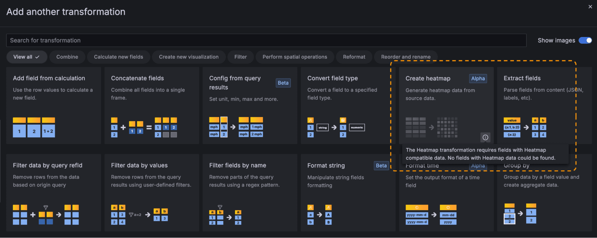

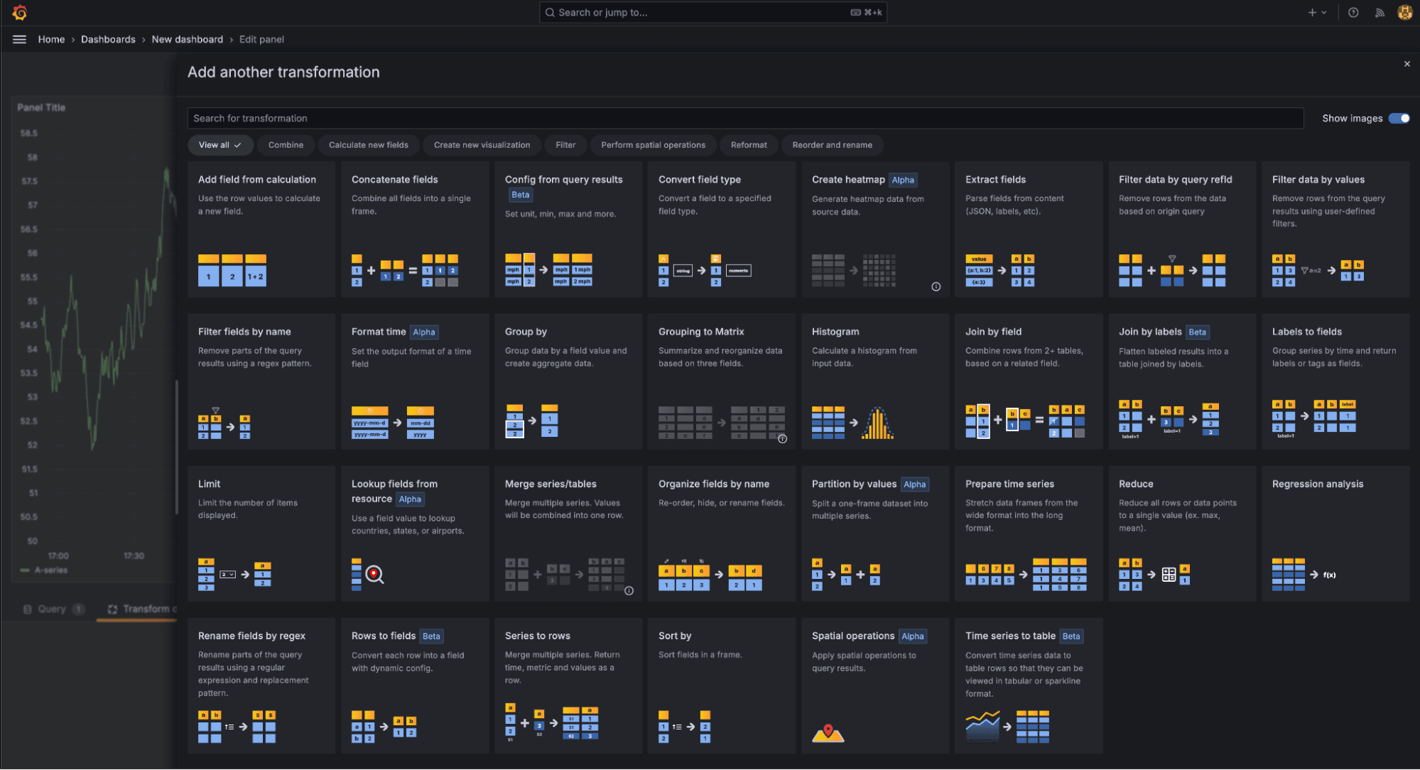

Add another transformation menu
This is when the transformation drawer comes into play. With the new UI you can:
  • See more transformations at once, helping you understand the possibilities. You can also change the width of the drawer.
  • Search or filter transformations based on actions or outcomes you need.
  • Understand what a transformation does thanks to improved descriptions and images visualizing the nature of a transformation.
  • Clearly identify transformations that are in the alpha or beta stages of maturity.
Add another transformation menu with Create heatmap and Extract fields boxes highlighted
Additionally, Grafana will detect the current data coming from the queries and gray out (or mute) the transformation tiles that might not be appropriate for the particular data returned by the data source.
