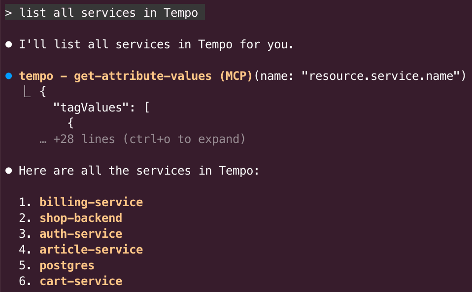

Tempo 2.9 now includes an MCP server that has direct access to your distributed tracing data through TraceQL queries and other endpoints. This means you can now leverage LLMs and other agents to more easily understand interactions between your services, as well as investigate and diagnose issues faster.
For instance, you could ask Claude to list all the services in Tempo.
A terminal window displaying MCP server results for a list of services in Tempo, including billing-service, shop-backend, auth-service, article-service, postgres, and cart-service.

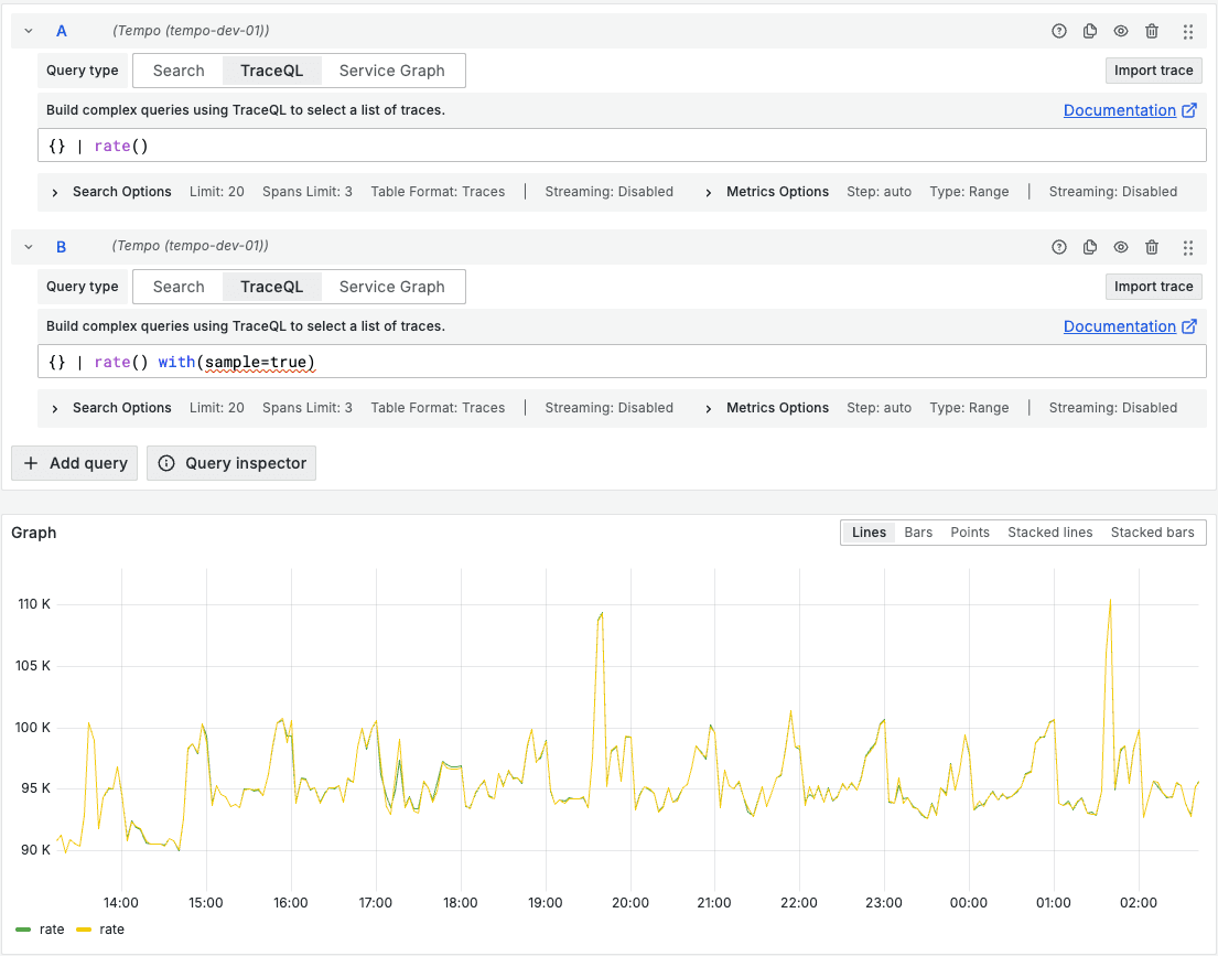

We can run the following two queries and see how they compare, as well as how long they take by checking the query inspector for each separate query.
{ } | rate()
{ } | rate() with (sample=true)
A screenshot of a Tempo graph showing a fluctuating yellow line labeled "rate" over time, with options for query settings and metrics.
The green line represents query A, and the yellow line is query B with sampling. We can see that they look quite similar, but there is a noticeable difference in how long they took to run. When we didn’t include the query hint the total request time was 7.35 seconds; when we did include the query hint, the total request time was 2.89 seconds.
Note: if you don’t see much of a time difference when you include the query hint, it’s possible your query results have already been cached.
