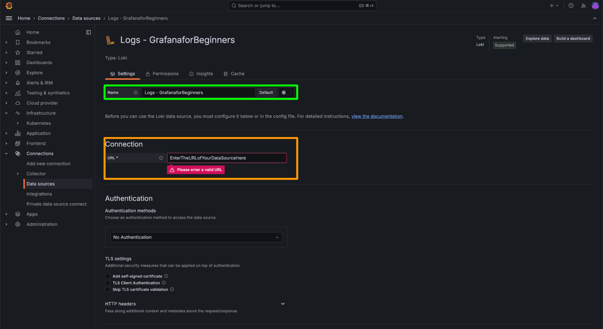

Provide a name for this data source and make sure it’s descriptive, so you can easily tell what kind of data it contains. Next, enter the URL for the data source to indicate to Grafana how to find it.
A screenshot showing how to enter the data source URL.

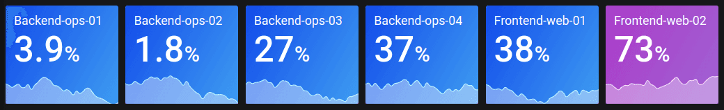

Stat panel
A stat panel displays your data in single values of interest — such as the latest or current value of a series — with an optional graph sparkline. A graph sparkline, which is only available in stat visualizations, is a small time-series graph shown in the background of each value in the visualization. You would use this if you want real-time stats about a value that you’re interested in. For example, if you’re monitoring the utilization of various services, you can use a stat visualization to show their latest usage.
A screenshot of a stat panel.
Stat panels are a great way to monitor key metrics, such as the number of high-priority bugs in your application or total number of sales, at a quick glance.

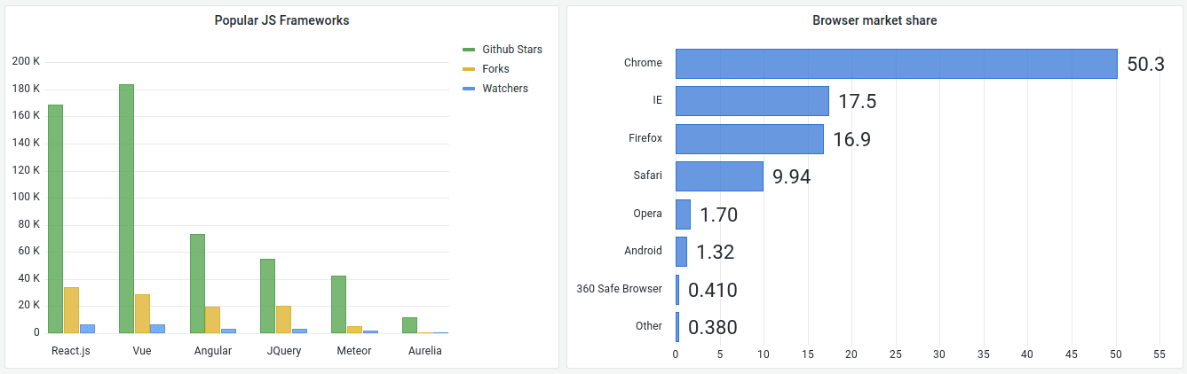

Bar charts
Bar charts allow you to graph categorical data. These are useful when you want to compare data by categories. For example, let’s look at a bar chart for web browser market share. On the y-axis, it displays different categories of browsers such as Chrome, Firefox, Safari, etc. On the x-axis, it shows you the value of the market share. You can clearly compare the market share of each browser by looking at the size of the bars.
A screenshot of bar charts.

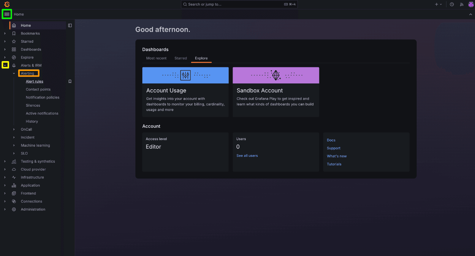

To start, go to your Grafana instance and expand the menu option. From the menu, locate the Alert and IRM option, then click on the arrow to display the sub menu. From there, click on the Alerting option to get to the Alerting page.
A screenshot showing how to access Grafana Alerting.
