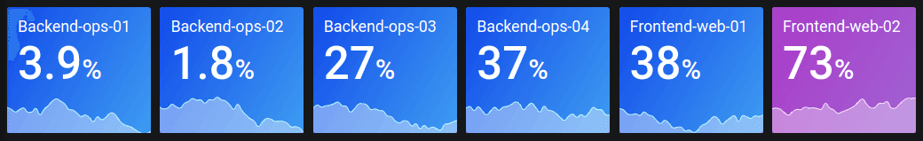

Stat panel
A stat panel displays your data in single values of interest — such as the latest or current value of a series — with an optional graph sparkline. A graph sparkline, which is only available in stat visualizations, is a small time-series graph shown in the background of each value in the visualization. You would use this if you want real-time stats about a value that you’re interested in. For example, if you’re monitoring the utilization of various services, you can use a stat visualization to show their latest usage.
A screenshot of a stat panel.
Stat panels are a great way to monitor key metrics, such as the number of high-priority bugs in your application or total number of sales, at a quick glance.

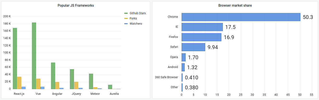

Bar charts
Bar charts allow you to graph categorical data. These are useful when you want to compare data by categories. For example, let’s look at a bar chart for web browser market share. On the y-axis, it displays different categories of browsers such as Chrome, Firefox, Safari, etc. On the x-axis, it shows you the value of the market share. You can clearly compare the market share of each browser by looking at the size of the bars.
A screenshot of bar charts.
These are just three (of many) visualization options in Grafana. To learn more, check out our documentation and click on each type of visualization for step-by-step instructions. You can also watch the video below.
