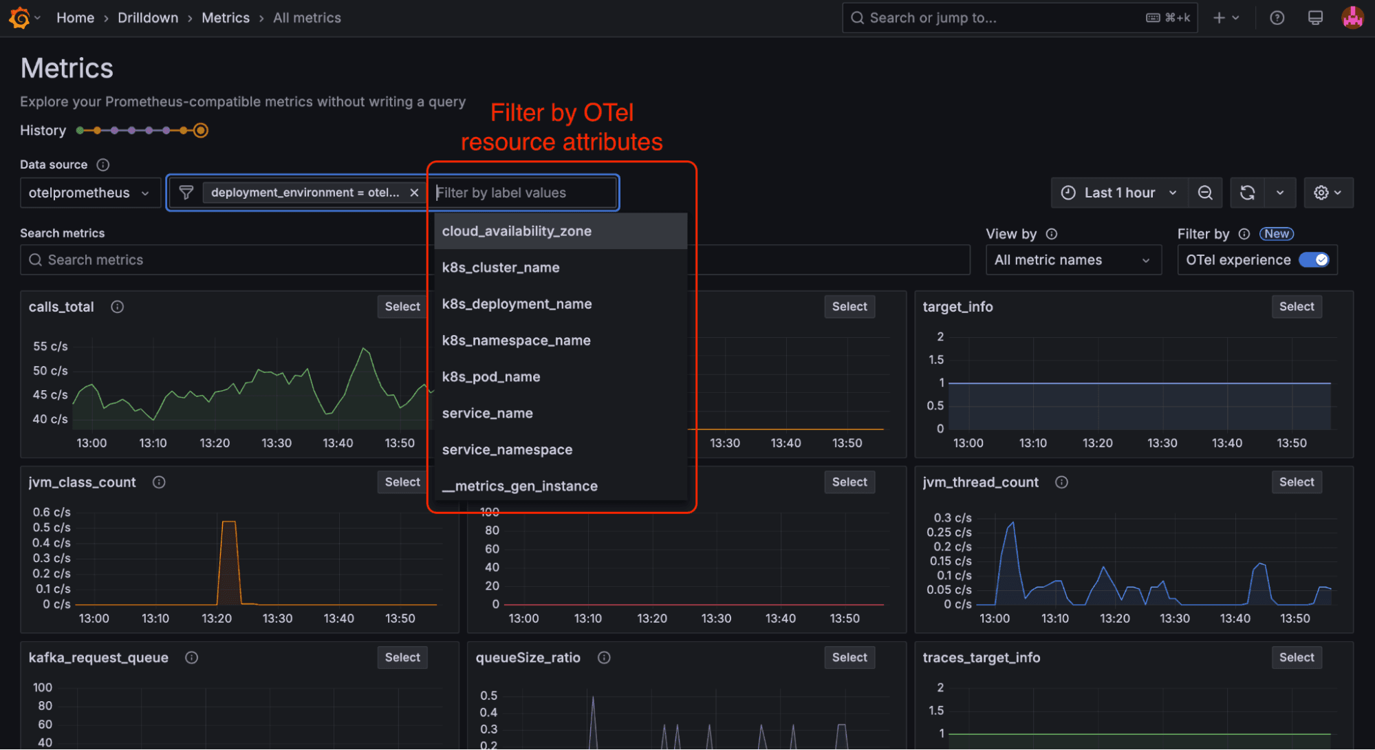

Now with first class OpenTelemetry support in Metrics Drilldown, imagine you just selected the k8s_cluster label, selected your cluster, and the join query was written for you!
How we added first-class OpenTelemetry support
Adding first-class support means OpenTelemetry resources are treated exactly like metric labels in Metrics Drilldown. You don’t have to write complex queries or build variables that expose their OpenTelemetry resource attributes.

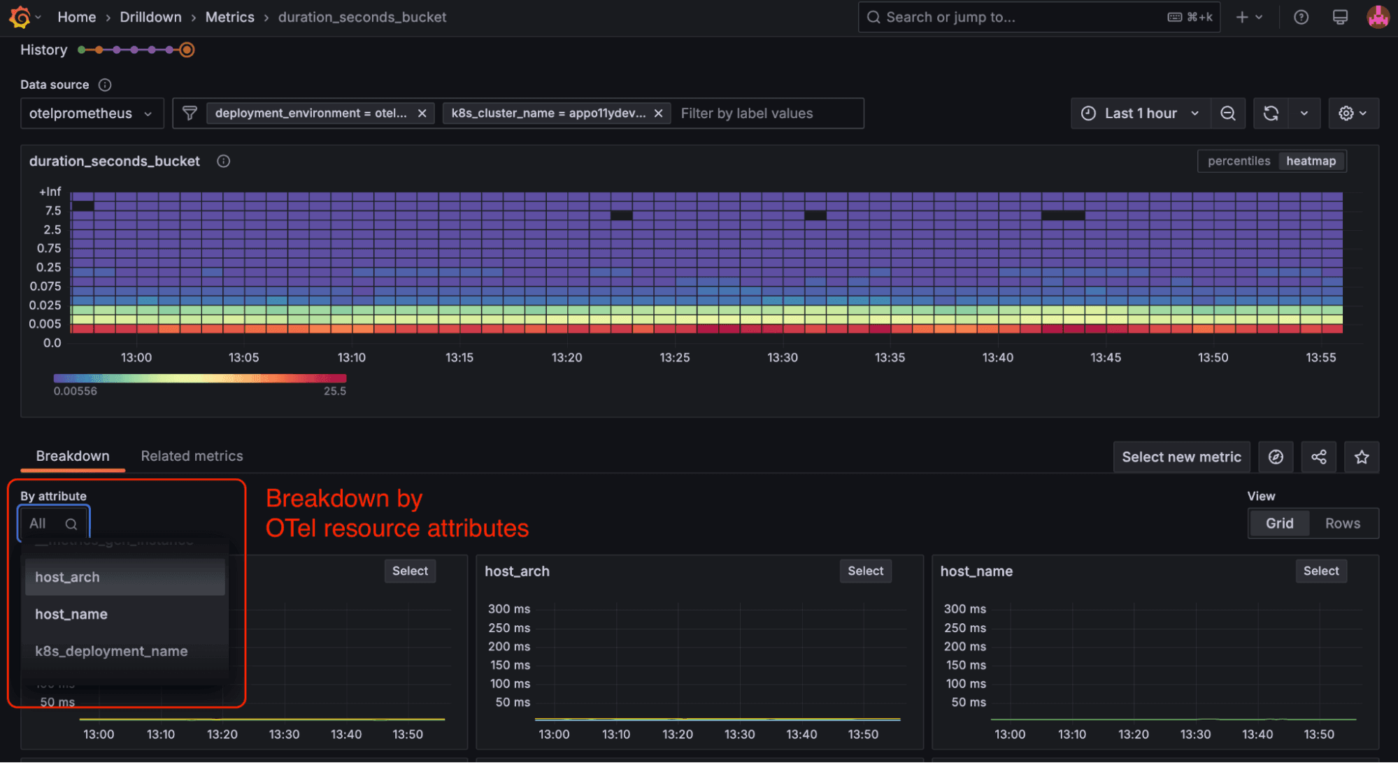

To make the process easy for you, we automatically fetch the attributes and write the complex queries. Here are some more details: * OpenTelemetry resource attributes and Prometheus labels are presented in the same filter. * Each type of filter is automatically interpolated correctly into the queries generated by Metrics Drilldown: * Prometheus labels are filtered on the selected metric * OpenTelemetry resource attributes are filtered on the metric target_info, which is joined to the selected metric * Example: my_metric{metric_filters_here:"value"} * on (job, instance) target_info{otel_resource_attribute_filter: "value"} * If an attribute is present on both the selected metric and on ‘target_info’, we filter on the metric. * When breaking down a metric, we may be breaking down by Prometheus label or resource attribute—both of which are done automatically.

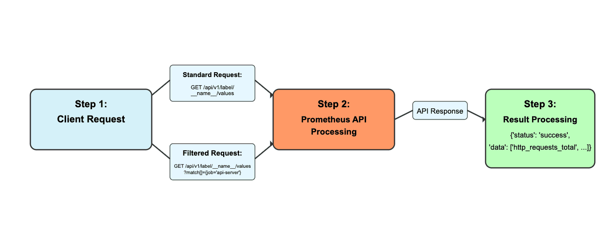

In Metrics Drilldown, we present users with a list of metrics. We offer normal label filtering to reduce this list. The method we use is to call the Prometheus label values endpoint with the chosen filters represented in the match parameter.
But what if we filter the list by resource attributes? If a resource attribute is not promoted to metrics, we must then use information on the target_info metric to reduce the metric list. We do this by getting all of the unique identifiers in target_info that can join metrics. This means that we build a list of job and instance label values. These job and instance values can be passed to the label values endpoint to retrieve metric names.
This presents a problem: the label values endpoint is a get request and parameters are limited to ~2048 characters. In many Prometheus instances there may be so many job and instance values that you exceed the character limit for the label values request. Exceeding the character limit results in a 414 URI Too Long error.
