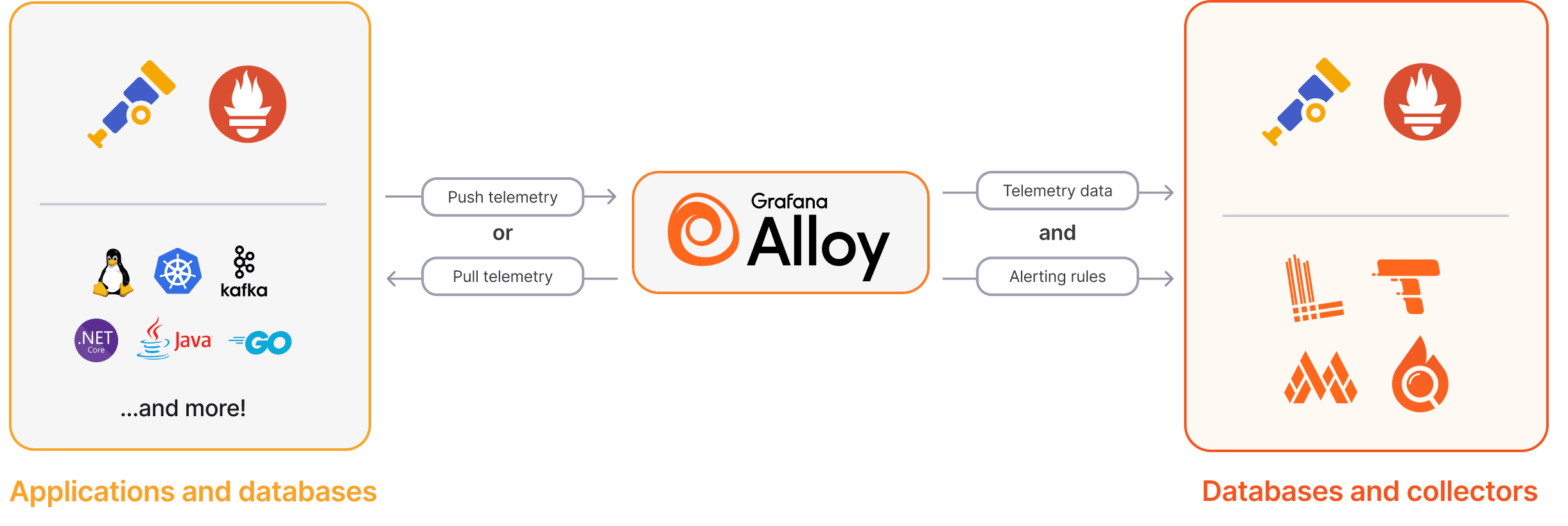

We believe that the most operationally sound observability system looks like a blend of these two leading open source technologies. Alloy is compatible with both the OpenTelemetry Collector and Prometheus Agent, which means it can be used as an alternative to either of these solutions or combined into a hybrid system of multiple collectors and agents. Alloy can also accept existing vanilla OpenTelemetry Collector and Prometheus Agent configuration files natively or convert them automatically to the Alloy configuration syntax for advanced use cases.
Architecture diagram for Grafana Alloy
Alloy can also be used with Grafana Cloud or any compatible backend from other vendors. You can configure Alloy with your observability solution to fit on-prem, cloud only, or a mix of both. It’s also flexible enough to cater to different users, large and small, at different phases of their observability journey.
