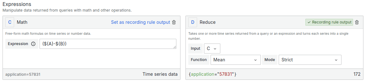

Much like alert rules, your data needs to be collapsed to look like a Prometheus instant query. You can easily accomplish this by adding a Reduce expression in front of most data source queries. This should be familiar to most Grafana Alerting users.
When dealing with more complex expressions involving multiple queries, you can mark which expression you want to record by clicking Set as recording rule output in the query builder.
Recording rules are modeled as an extension of existing Grafana alert rules. That means you can view, search, and manage them in exactly the same way you would alert rules.
Grafana rule groups and folders can contain a mixture of alerting and recording rules. If you define your alerts as code, recording rules are supported in all the same provisioning systems and APIs that you’re already using.
In the screenshot below, you can see a single expression that is already selected as the rule output:
And here, the left expression is showing the Set as recording rule output action link:

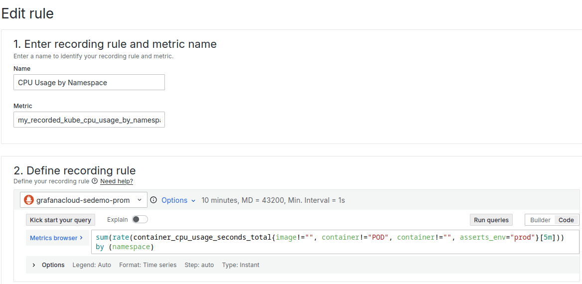

Let’s say we often want to visualize the CPU usage of several Kubernetes pods, broken down by namespace. If we make the same query in several dashboards, it makes sense to record it:

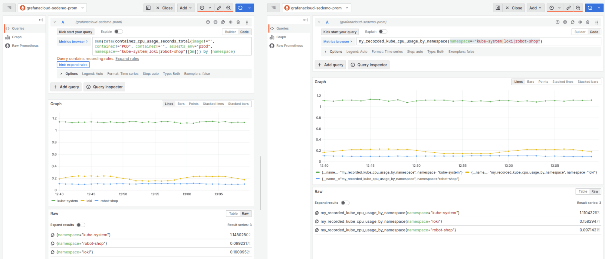

Then, we can reference that data with my_recorded_kube_cpu_usage_by_namespace. Here’s what the underlying query looks like next to the recorded series:

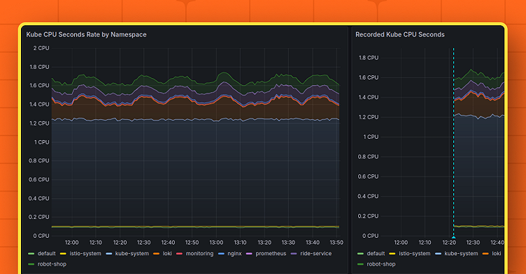

You can see the recorded data following the queried data very closely. The recording rule saved every dimension from the original query — like with Alerting rules, you can query many series with just one rule.
Note how the recorded series also inherits the labels from the original query. This means you can still correlate and filter your recorded data, the same way you did before! Also notice how the same label matcher works for both the original and recorded series: namespace=~"kube-system|loki|robot-shop".
Recorded data often has a “sampling lag” when directly superimposed onto the original query. This is because the recording rule runs once a minute, which may not line up perfectly with the time that you issued the query from the browser. This is especially common for data with high variance. To reduce sampling lag, try increasing the evaluation interval of your recording rule.
