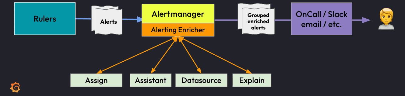

This is where enrichment comes into play. Alert enrichment is the practice of adding contextual information to alerts. This could be in the form of additional labels, annotations, and even log lines. This context travels with the alert all the way through to notification delivery.

Rules point to alerts, then to Alertmanager and Alerting enricher, to Grouped enriched alerts, to OnCall, Slack, email, etc. to a human. From the Alertmanager box, arrows point to and from assign, assistant, datasource, and explain

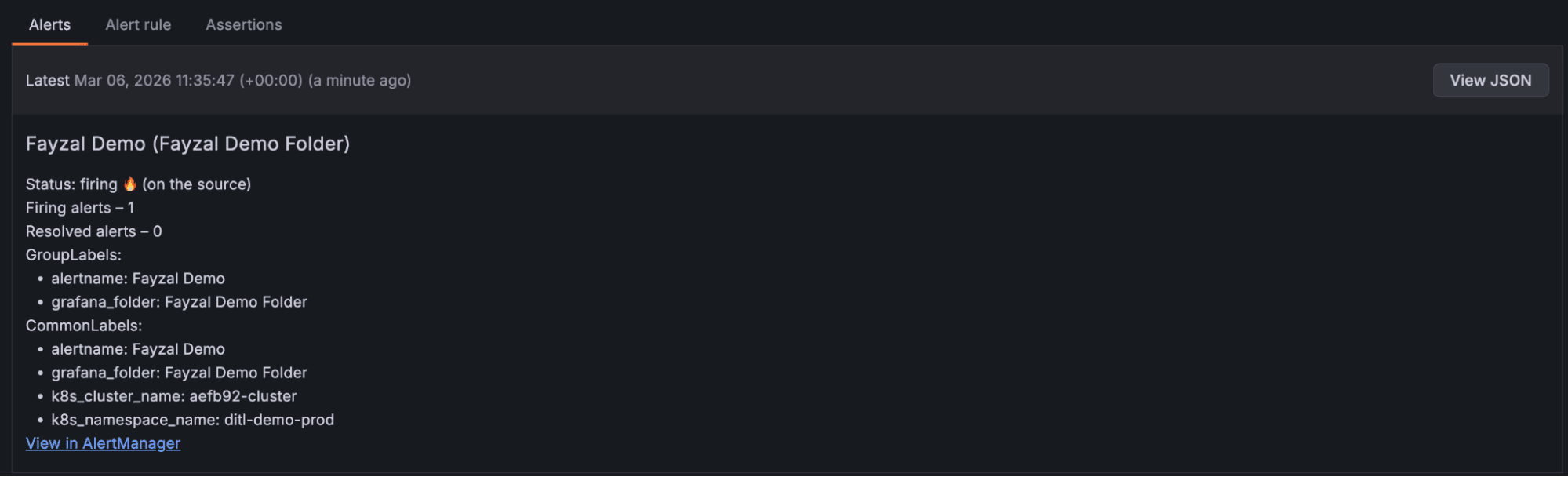

Before: An unenriched alert
Alert status and labels displayed in Grafana Cloud
The screenshot above shows a regular alert. There isn’t much information there apart from the cluster and namespace that triggered the alert. It’s not immediately clear for a user where to go next: it might be searching through logs, checking some metrics, or opening a dashboard. All this context switching costs precious minutes, especially during an incident.

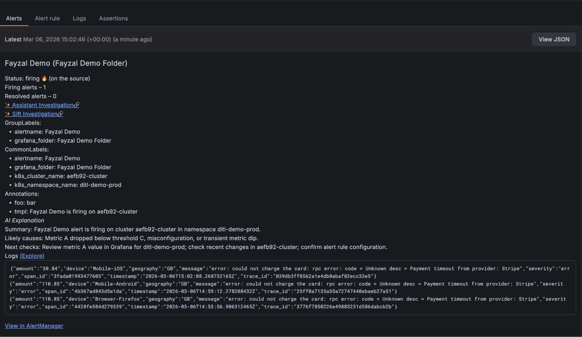

After: an enriched Grafana alert
Alert status, along with labels, annotations, AI explanation, and logs
This is the exact same alert, except it has been supercharged with multiple enrichments. Links to Assistant and Sift have been added, offering users a click-through to AI-powered investigations that were triggered in the background.
There are two annotations assigned via an "Assign" enrichment for demonstration purposes:
  • foo=bar
  • tmpl={{ $labels.alertname }} is firing on {{ .Labels.k8s_cluster_name }}. As seen above, this template has been executed before being added as an annotation value.
The "Explain" enrichment has added a human-readable explanation of likely causes under the “AI Explanation” header.
Finally, the "Datasource" enrichment has pulled in relevant log lines, as well as a link to explore these logs in further detail. From the logs, the issue is immediately apparent, there is a timeout from the payment provider. Now the user knows exactly what the problem is directly from the alert itself and can concentrate on mitigating the issue, rather than spending valuable time triaging.

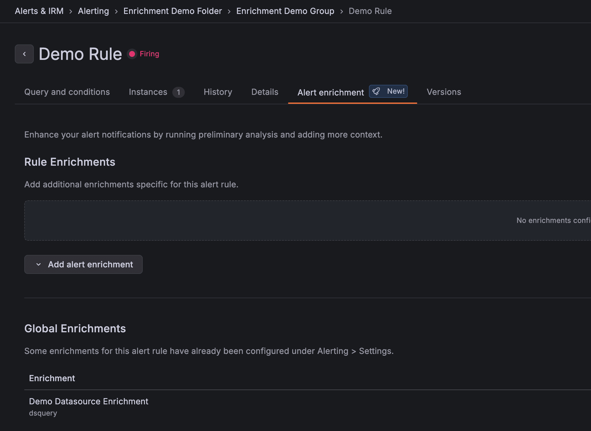

Rule enrichments
Getting started with configuring your own enrichments couldn’t be easier. On the rule page, you will find a new tab called "Alert enrichment":
Alert enrichment UI in Grafana Cloud

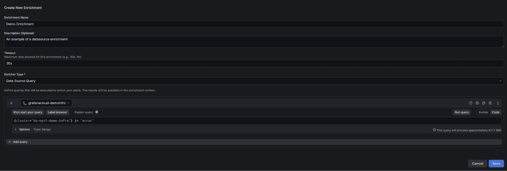

From here, you can configure the enrichment of your choice by selecting the “Add alert enrichment” dropdown:
'Create new enhancement' UI
Once saved, the enrichment will run every time for that rule before alert delivery. In the enrichment shown above, an alert for that rule will contain the log lines from the query specified, as well an Explore link taking you directly to the query to view the logs in more detail.

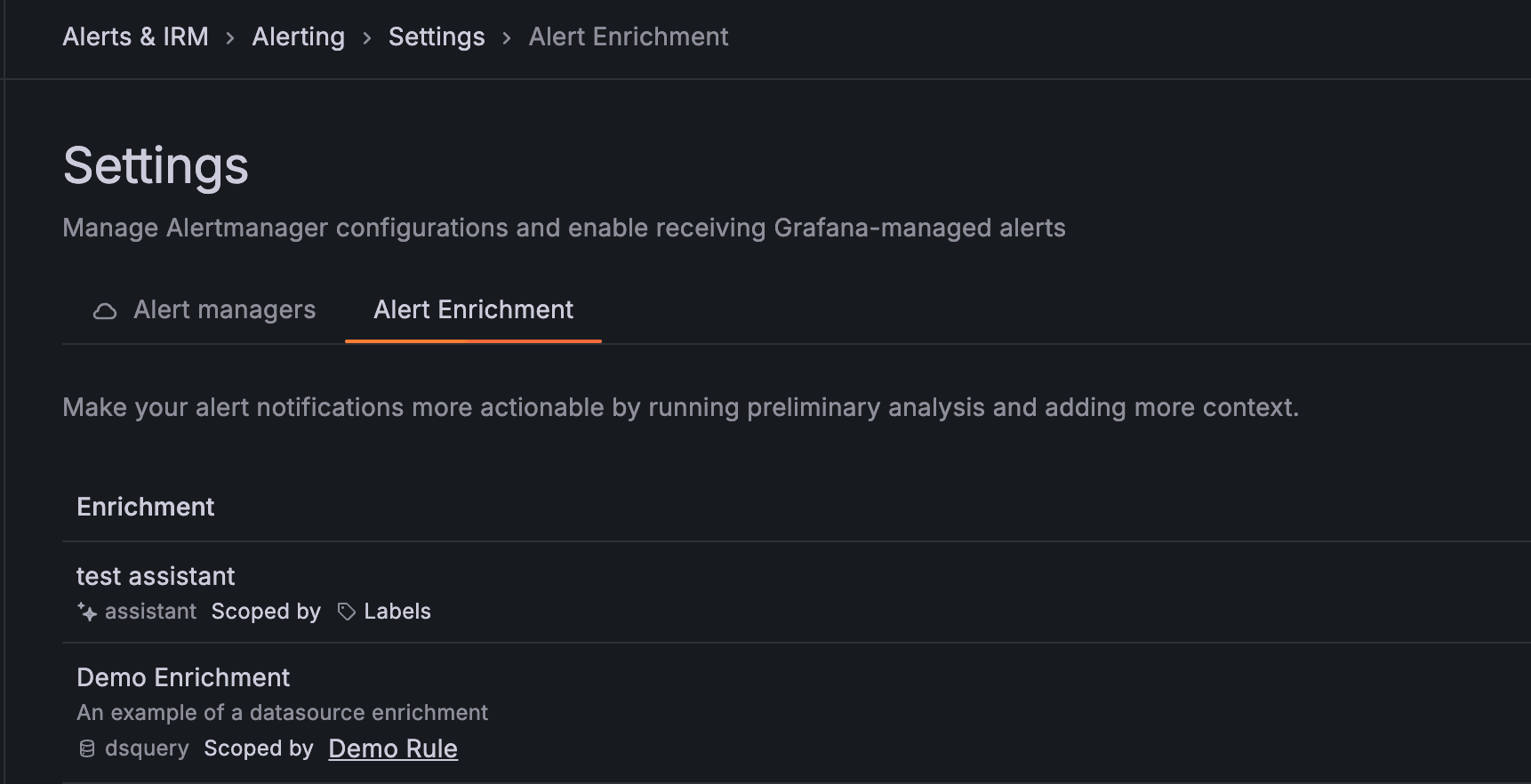

Global enrichments
Alert enrichment settings UI

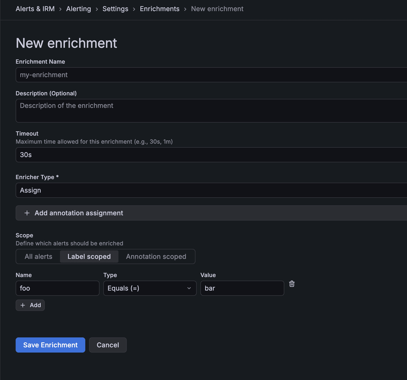

For users with Admin privileges, the "Alert Enrichment" tab is visible under Alerting > Settings. From here, an enrichment can be configured to run on all alerts, or alternatively scope them by labels or annotations. In the following example, the enrichment would only run for all alerts containing the label foo=bar.
New enrichment creation menu
You can find more info on how to get started on setting up alert enrichments in our docs.

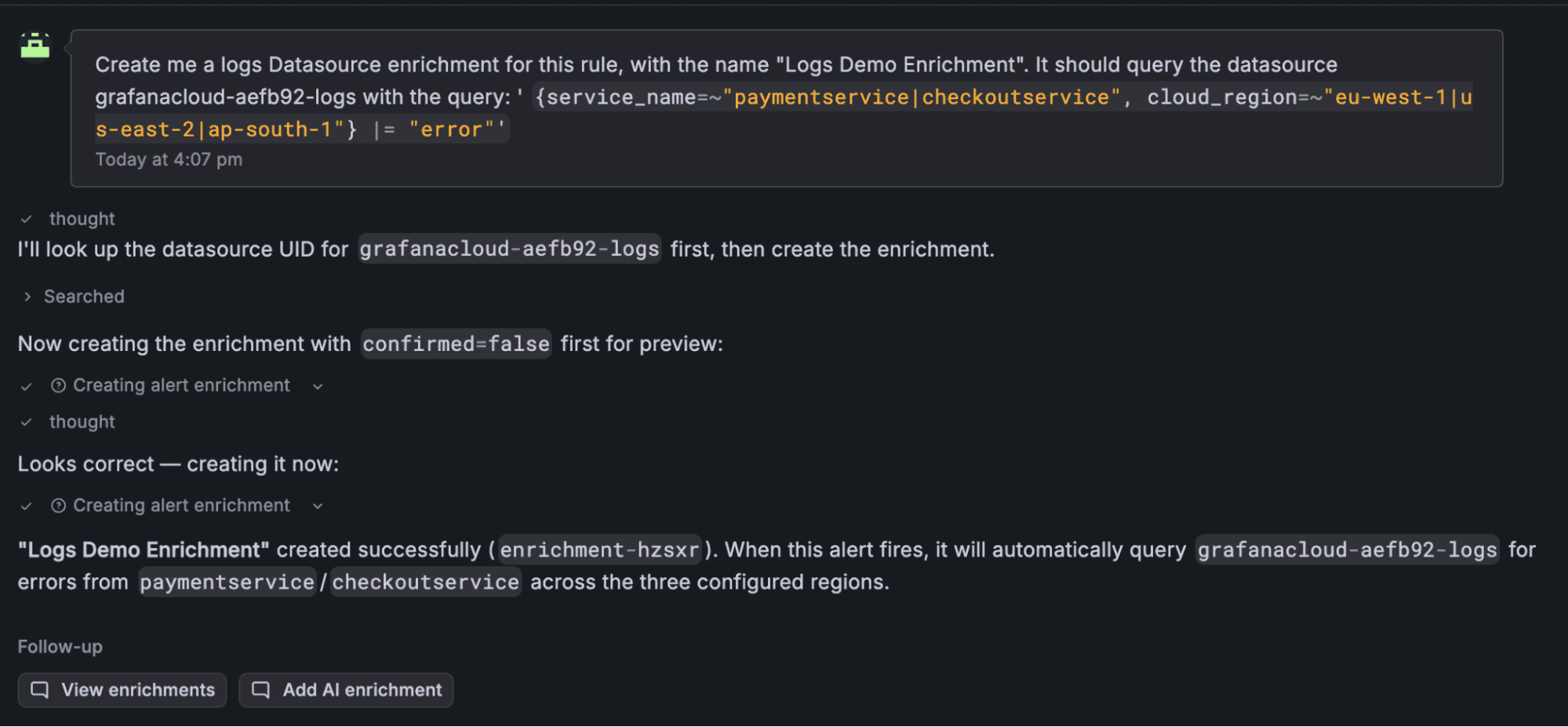

Grafana Assistant is already capable of listing enrichments, as well as creating and deleting a few types such as Assistant enrichments, which will trigger an investigation, and Datasource:Loki enrichments.
Grafana Assistant used to create an enrichment with natural language
We plan on supporting more enrichment types via Grafana Assistant in the near future.
