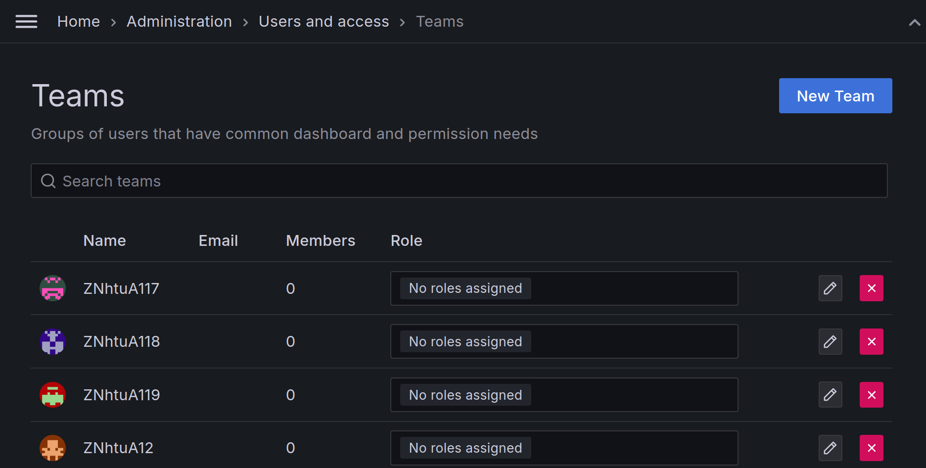

Team selector menu
Under Administration > Users and access > Teams, you can select the New team button, there you will be presented with the Team’s name choice and role picker. The name you choose is used solely for display, so be as descriptive as possible.
Through the role picker you can assign your team some basic functionality in the form of roles, such as the Datasource Explorer role, allowing team members to access the Explore menu to iterate on their queries.

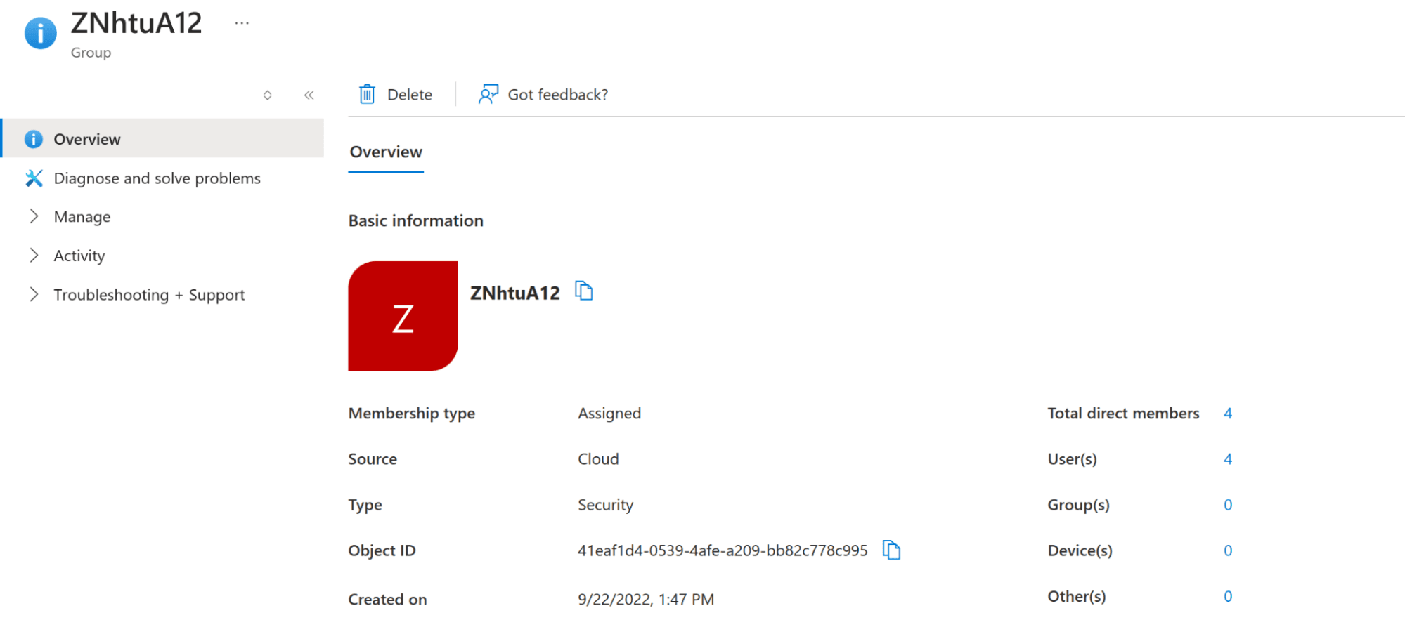

Entra ID UI
In the case of Entra ID, the team’s External Group ID must match the Object ID in the Entra interface.

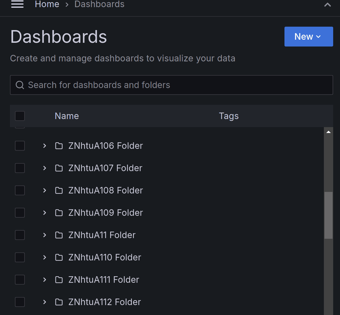

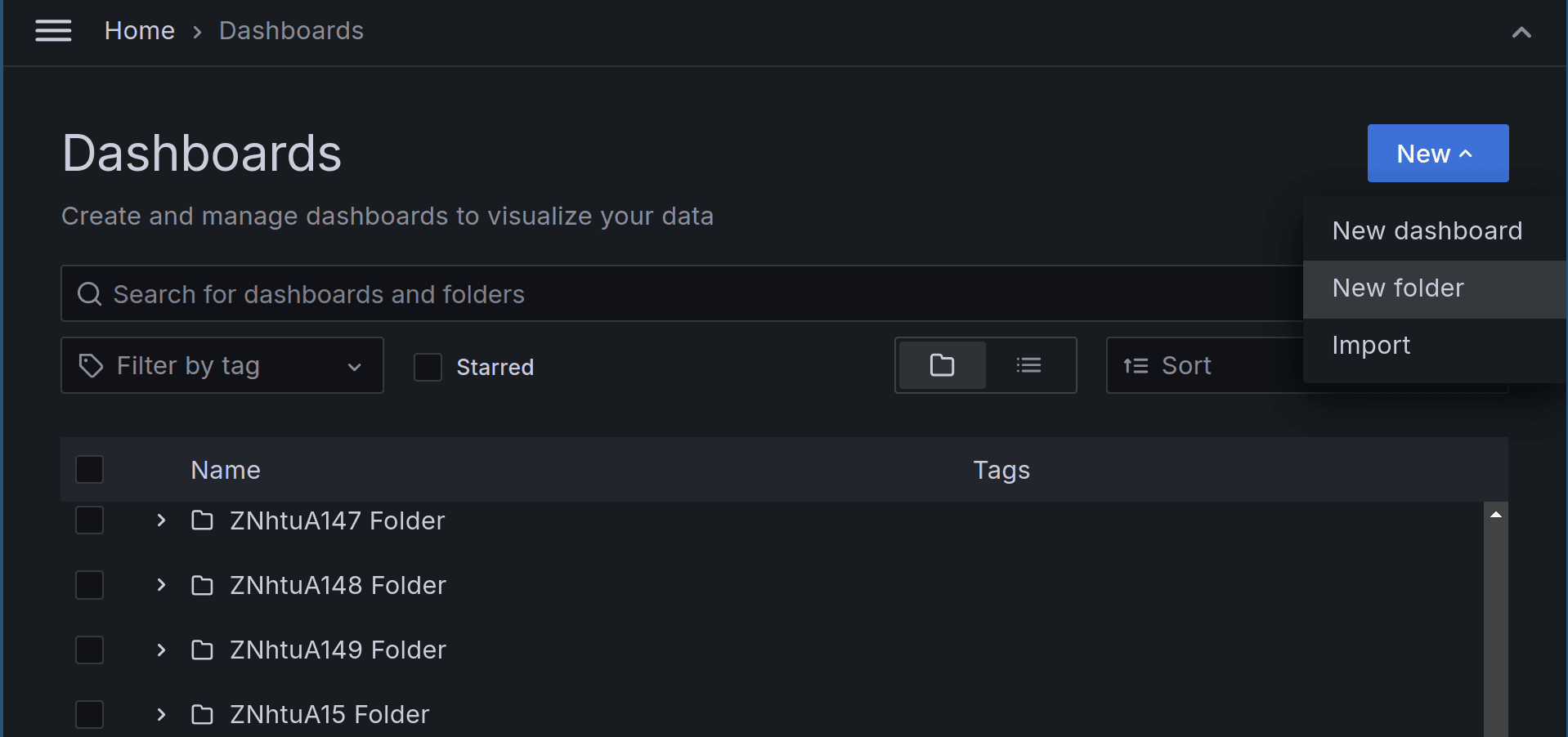

Folders allow a team to have a place to store their projects and collaborate while being able to optionally share other content with the rest of the organization.
New folder selection

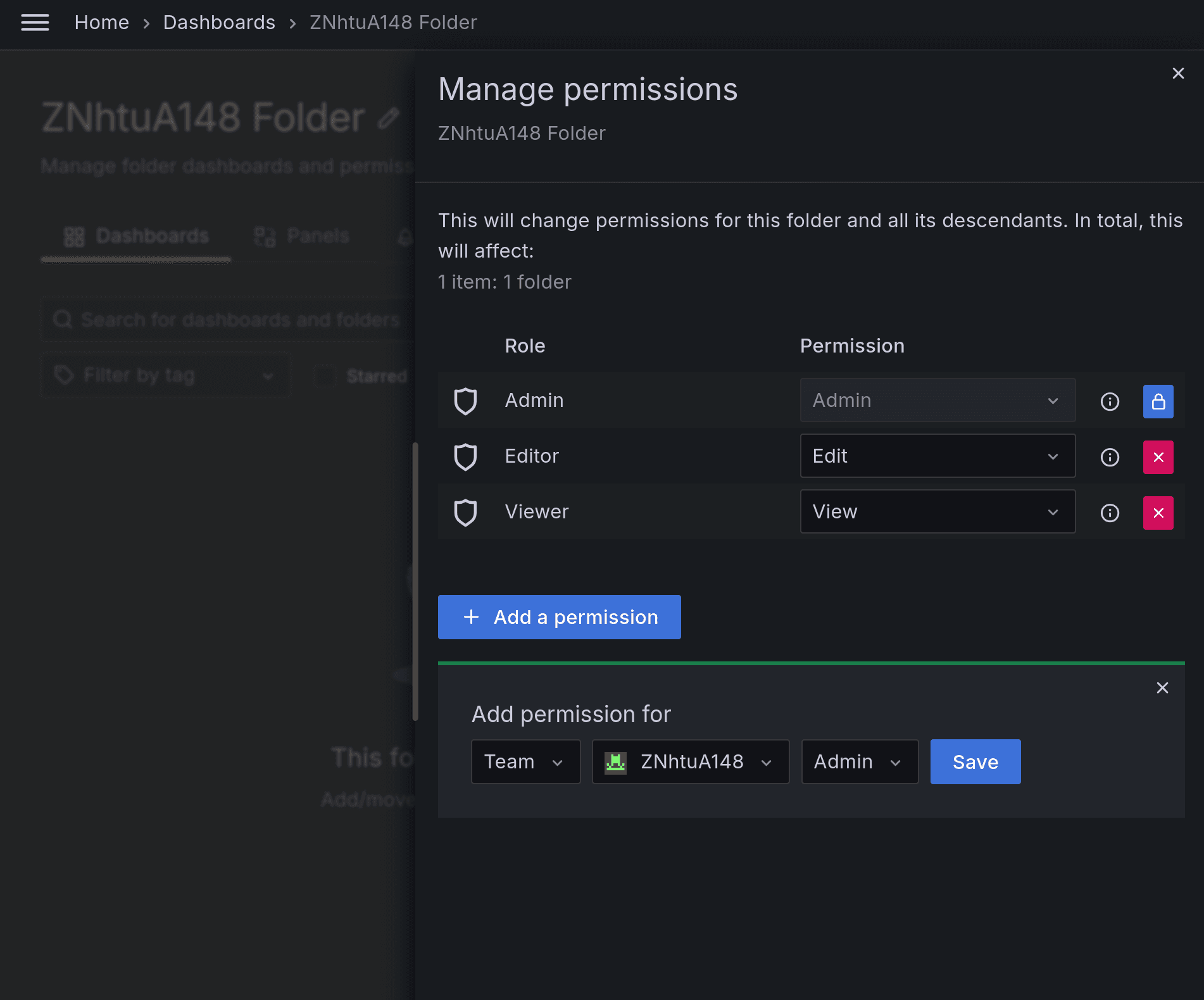

To create a team folder, create a folder in the dashboards view, then head on over to the permissions tab of your newly created folder. There you can add a new “Admin” permission to your team and, optionally, remove existing permissions.
Adding Admin permissions will allow your team, with users whose basic role is None, to create new dashboards and resources in the folder, while not exposing them to all of the organization’s folders and dashboards.
Removing the existing permissions will make this folder only accessible to your team instead of the original folder creator and anyone with basic Viewer and Editor roles. It is not possible to remove Admin access from folders, so you should be mindful when assigning this basic role.
Manage permissions menu

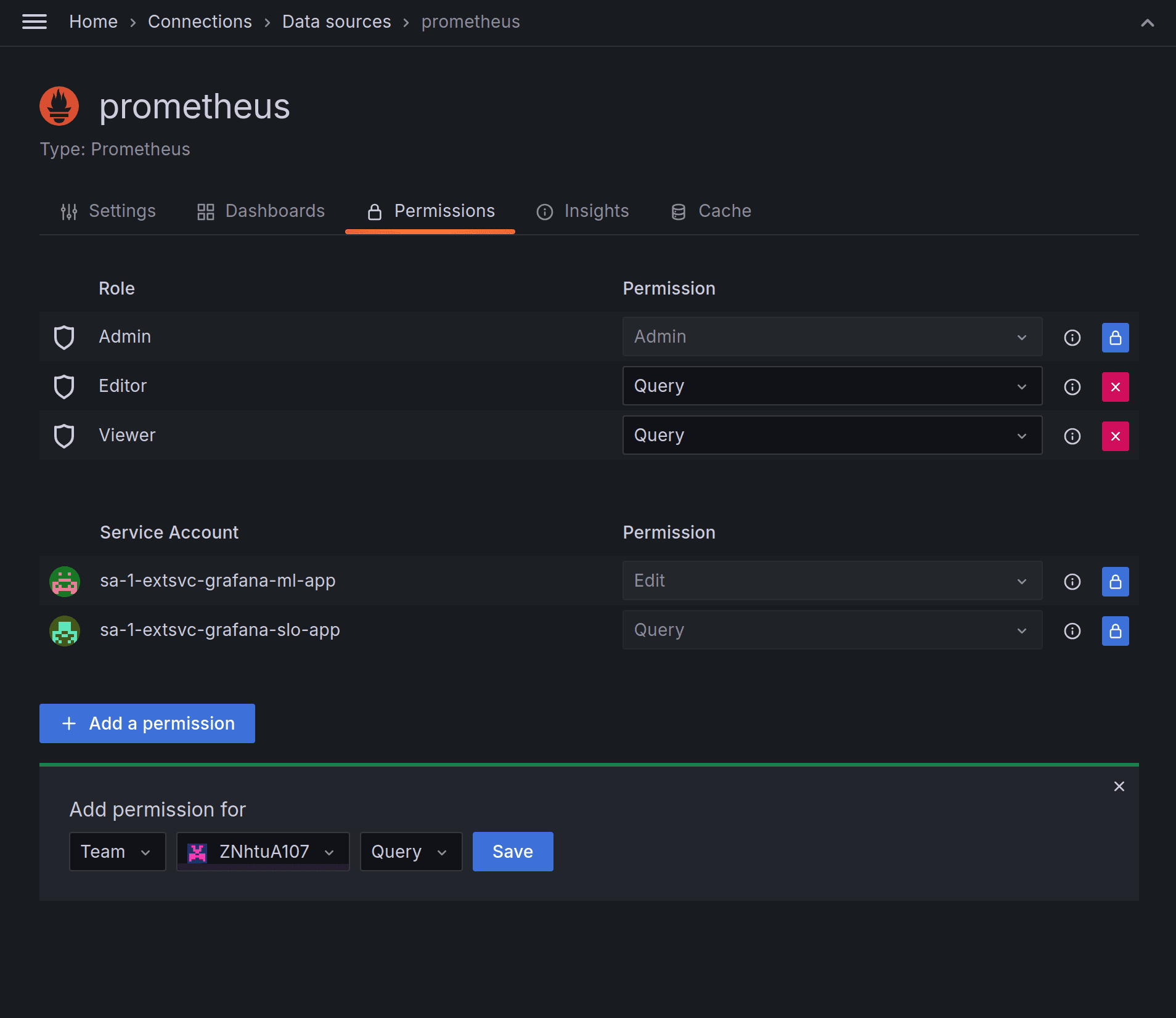

Connect your team to data sources
Don’t forget to give teams access to the data sources they will be using; go to the permissions tab of your data source and add the “Query” permission to the team. You can also remove existing permissions from Editors and Viewers to make this a team-exclusive data source.
