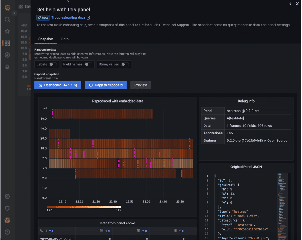

In the Grafana 9.2 release, we introduced a new panel help feature designed to help dashboard editors better communicate issues with our support teams. Now when you encounter problems with any of your visualizations, you can send the panel’s JSON model to Grafana Labs technical support and request help with your issue. The panel that you send includes query response data (with sensitive data randomized!) and all visualizations settings. This will help eliminate some of the friction that comes with troubleshooting panel problems.
Grafana panels: How to request help in Grafana 9.2
When you navigate to Panel menu > More, there is a new menu item that says Get help. This opens up a wizard that will create snapshots of data that can be sent to our support teams, either as a GitHub issue or within the Grafana help system (support tickets can be sent via the Grafana portal or to support@grafana.com), to better help communicate any panel issues.
Embedded image
The wizard creates a standalone Grafana dashboard that has all the original data, some overview info, but most importantly, what the structure looks like and what the configuration was at the time of the issue. You can also download snapshots and include it in the help issue. For panels that are more complicated with complex transformations, these snapshots will also provide the data both before and after transformation.
On the receiving end, the Grafana Labs support teams will see exactly what users are looking at and have a simple way to copy the dashboard and import it into a new instance in order to see what is happening within our development environments. With this new Grafana panel help option, the Grafana Labs support team will be able to reproduce, diagnose, and fix the issue in a more seamless way.
