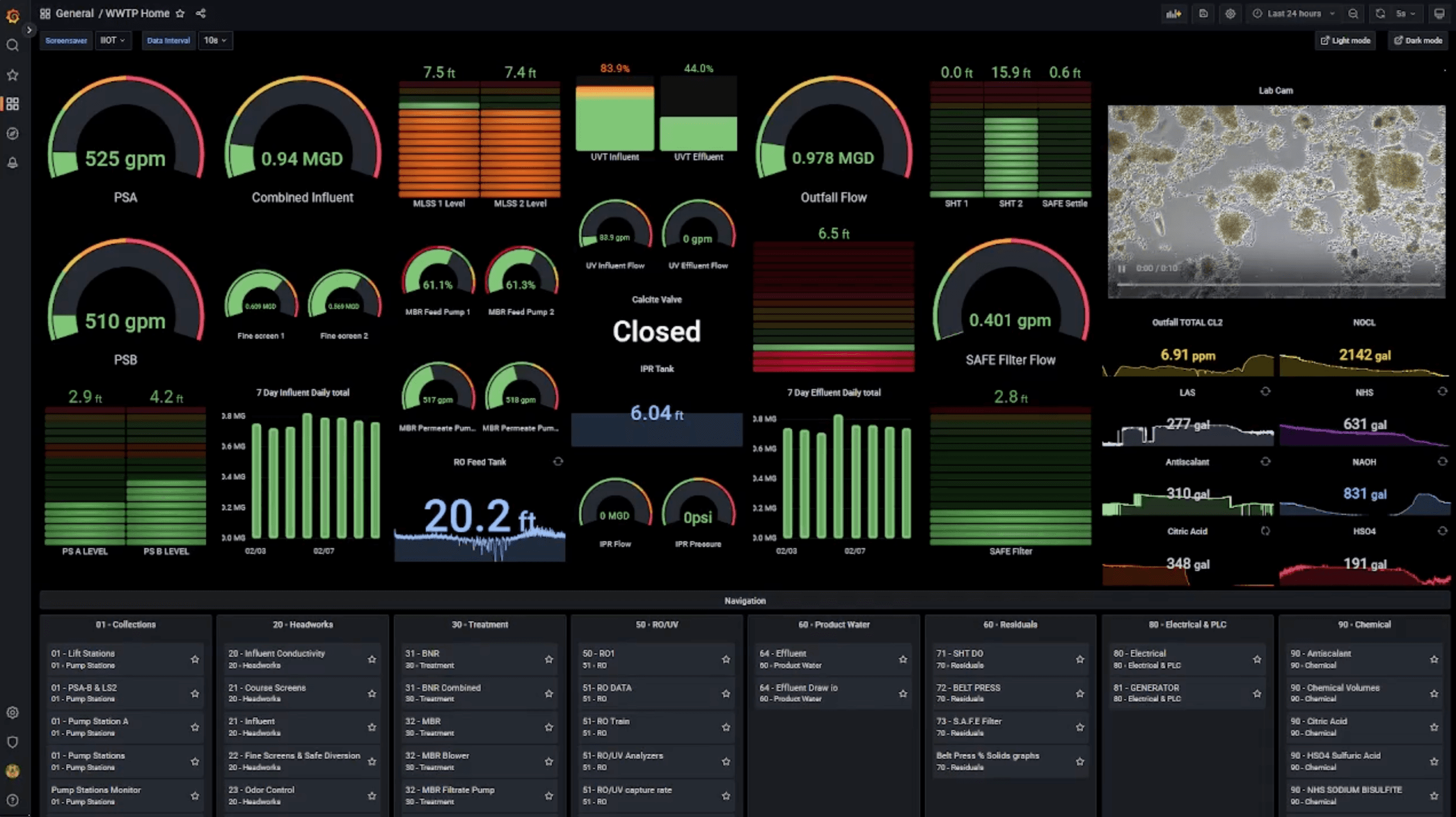

Ultimately, Grant built a real-time, highly contextual dashboard that’s become the go-to resource for operators, engineers, and lab staff alike at the new treatment plant. At the heart of this award-winning dashboard is a homepage designed with purpose: a left-to-right visual journey of wastewater treatment, intended to be a “navigational springboard” for users.
A screenshot of the Grafana dashboard Grant Chase built for the city of Morro Bay wastewater treatment plant.
“Each column represents a process area, and below that are navigational buttons that let you go deeper into that particular part of the system.”
The dashboard helps teams visualize data from hundreds of sensors, motors, analyzers, and off-site lift stations. It dynamically adjusts data resolution for second-by-second accuracy, integrates lab data for compliance monitoring, and even includes embedded video feeds of the microorganisms found in the basin.
“That really creates a complete, or more complete, data model for us,” Grant said. “We know what the process is, what the samples were like, and what microorganisms were observed at a given period of time.”
