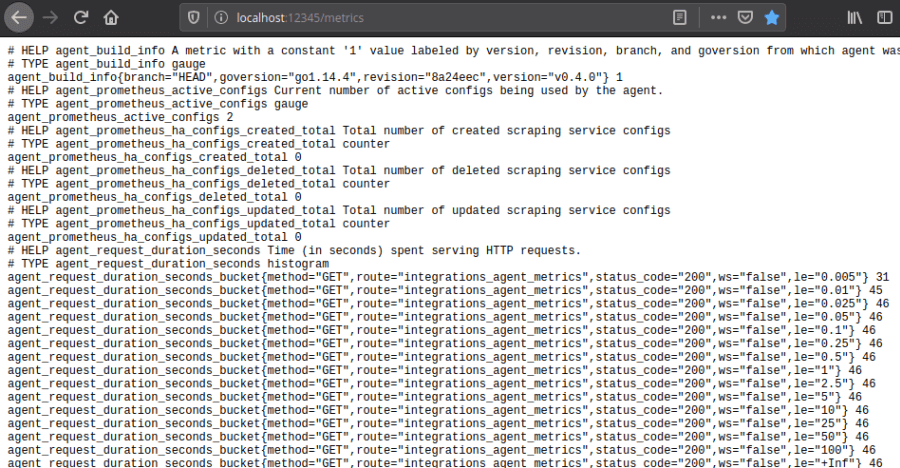

I want to verify that, though, so first I’ll check my local metrics endpoint. Since by default the port of server is set to 12345, I’ll check http://localhost:12345/metrics:
Embedded image
Notice there are now a bunch of metrics available prefixed with agent_. This is good; we now know the agent is producing metrics.

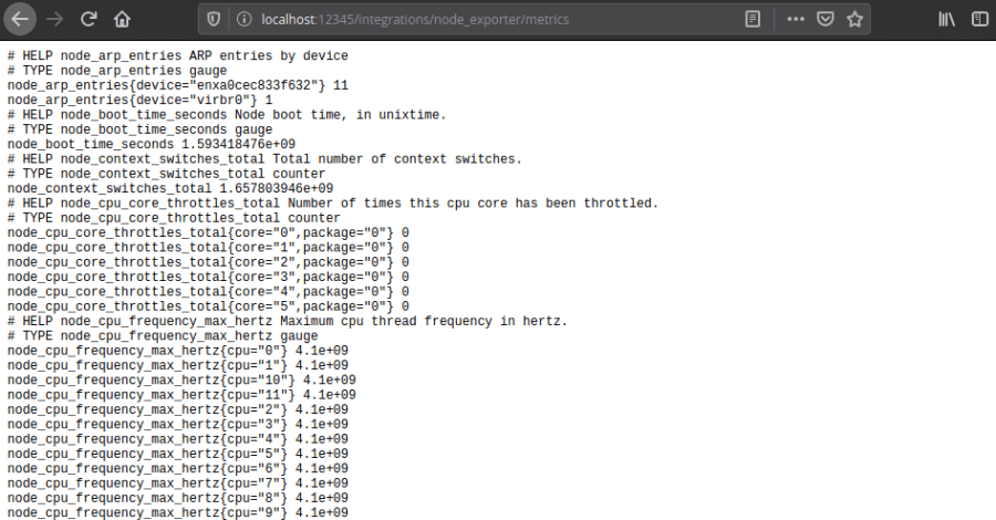

This is a great question. When using the Agent’s integrations, the metrics for those integrations are each actually available at a slightly different path. The reason for this is so that they can be scraped separately. For example, the node_exporter metrics could be configured to be scraped every 5 minutes, while the agent metrics could be scraped every 1 minute if desired.
So to find the node_exporter raw metrics, I’ll go to http://localhost:12345/integrations/node_exporter/metrics.

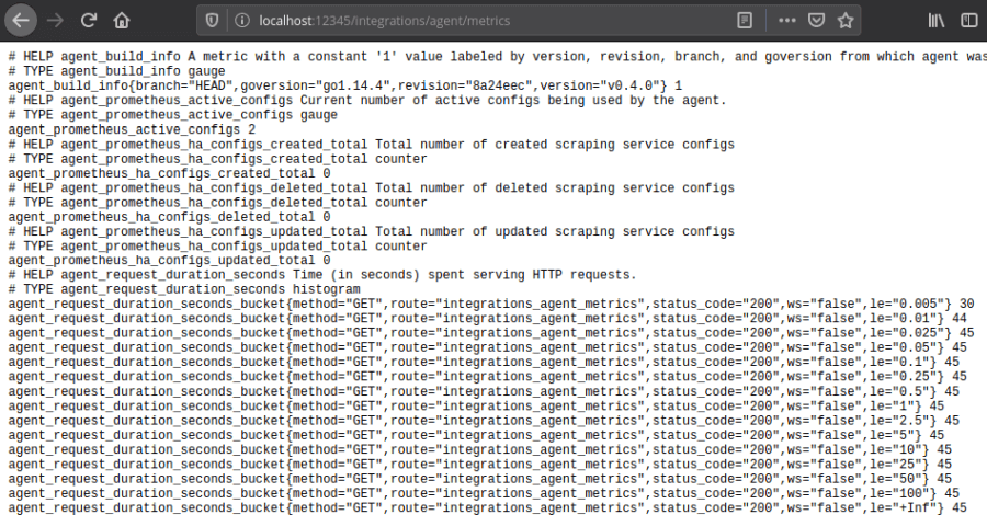

Now, you might say, “But Éamon, didn’t you say the agent metrics themselves are an integration? Why aren’t they available at a similar path?”
The answer is they actually are available at both the root /metrics path as well as /integrations/agent/metrics, and the content is identical:

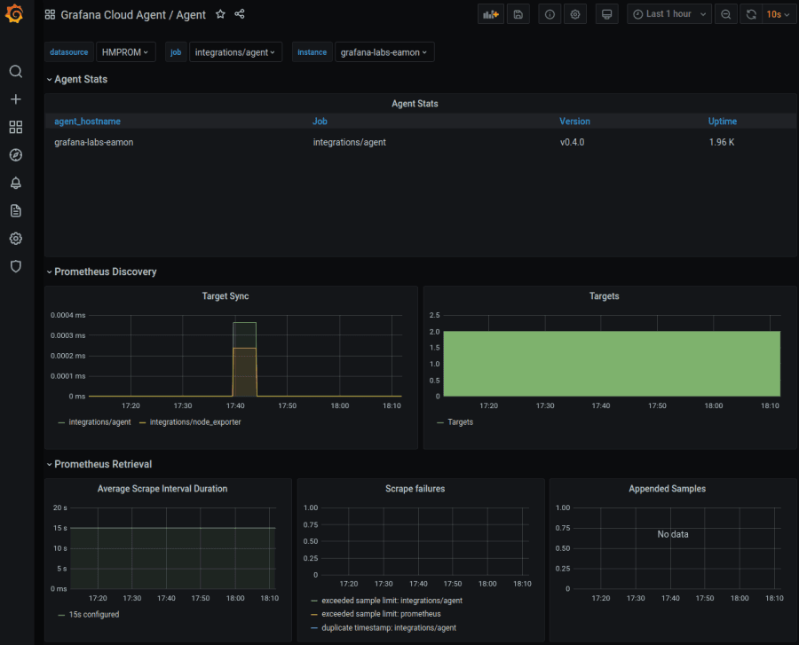

So now that I know my metrics are being served locally, I want to check to see if I can see them on Grafana Cloud.
For the Agent metrics, I’m using a slightly modified version of the example dashboard from Robert located here. I’ve just changed instance to agent_hostname, as this shows the true machine hostname instead of a localhost address. We’ll get a more finalized version of this dashboard placed on the https://grafana.com/grafana/dashboards site once we do a bit more work on it, but you can use this for now if you’d like to try it.
Here is how mine turned out:
Embedded image
From here I can tell that my Agent is working and I’m receiving metrics from it.

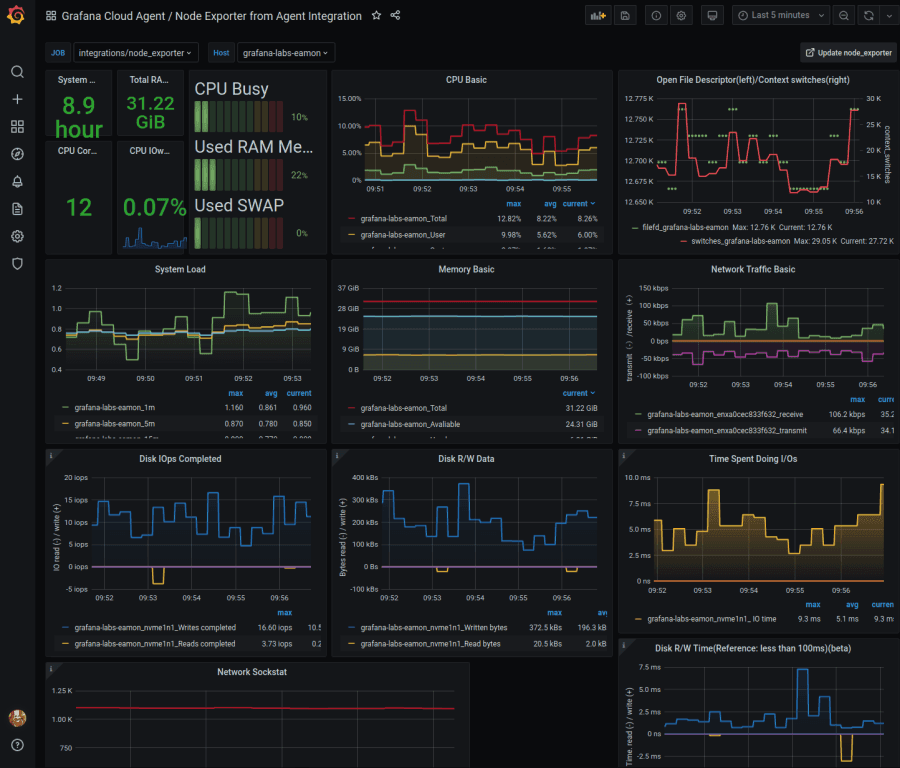

Now onto the node_exporter.
I’ve taken one of the many “Node Exporter for Prometheus” dashboards for this and modified the panels and dashboard variables to use agent_hostname. Ideally, of course, it would be a bit easier to have both Agent and non-Agent node_exporter metrics in the same view. We’re going to look at solutions for that internally, but for now this works pretty well.
Let’s take a look!
Embedded image
Excellent! With an extremely minimal config file, I’ve now configured the Grafana Agent to send metrics both about itself and my machine via automatically setting up the node_exporter integration for me.

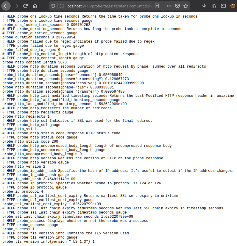

I can see that so far, there have been no probes, so I’ll force one manually by visiting http://localhost:9115/probe?target=grafana.com&module=http_2xx.
The result:
Embedded image
Notice the probe_success 1 near the bottom. So I know my probe worked!

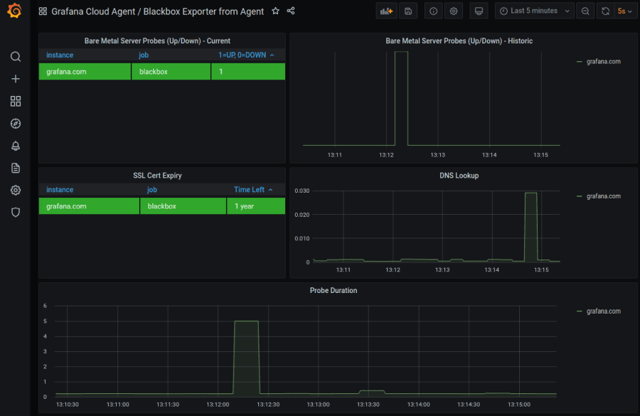

Finally, I import the Blackbox Exporter Quick Overview dashboard, and here we are:
Embedded image
