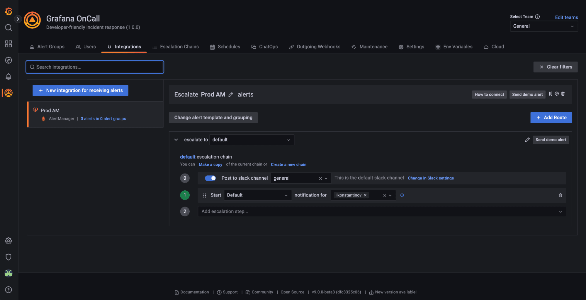

Check if everything was set up correctly by applying your Terraform configuration. You should see it show up in the UI like below.
Screenshot of Grafana OnCall UI with Terraform configuration.
Please note: Pay attention to the default_route block. This is the place where all your alerts go by default.

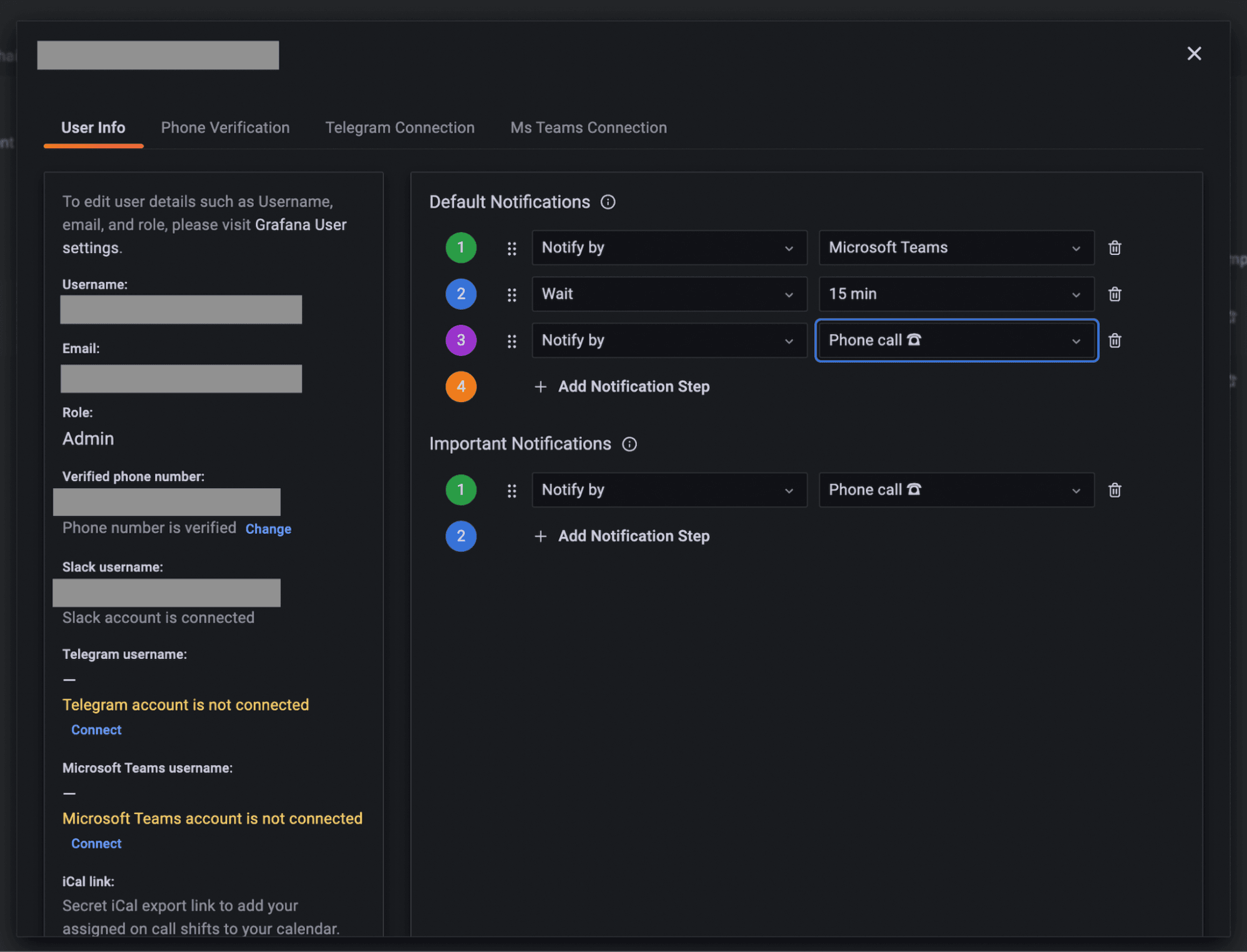

User settings
OnCall users can control how they are notified via their user settings page within Grafana OnCall. (This is separate to the Grafana user settings page.) You can see the setup below in which a Grafana Cloud user is notified via Microsoft Teams notification first for default notifications and via a phone call for important notifications.
Note: Microsoft Teams is only available in Grafana OnCall in Grafana Cloud.
Screenshot of Grafana OnCall in Grafana Cloud UI showing user settings configured for Microsoft Teams.

Once this is complete, apply this updated config. Once it’s run, you should see something similar to what you see in the screenshot below in your OnCall web UI integrations page with a newly created Prod AM integration.
Screenshot of Grafana OnCall UI with Prod AM integration.
For now, we have a very simple but working Grafana OnCall setup.

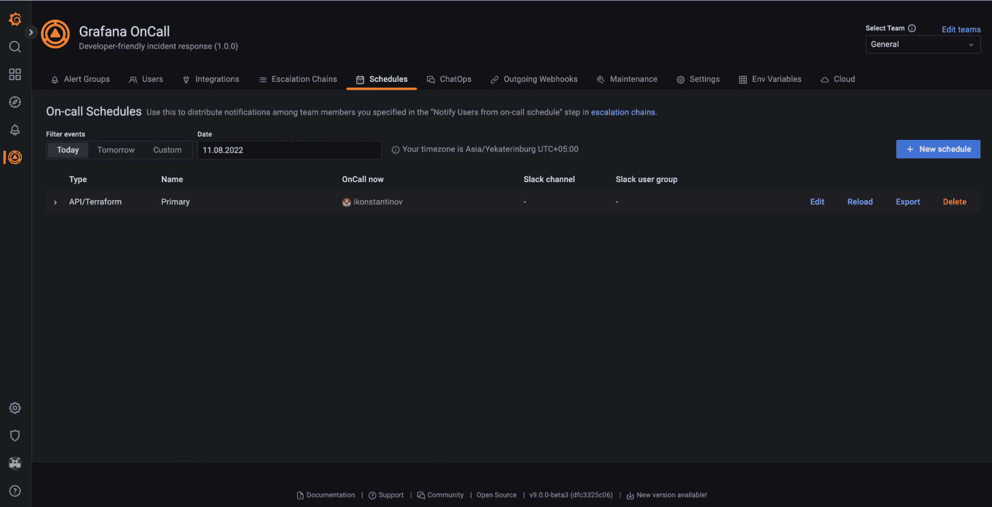

Again, apply config. Go to the Schedules tab in Grafana OnCall. There you can validate your schedule in the web UI or get the iCal link via Export and check the schedule in a calendar such as Google Calendar.
Screenshot of Grafana OnCall UI with schedules configured.
You can see the setup described in the create a schedule section in this tf file.

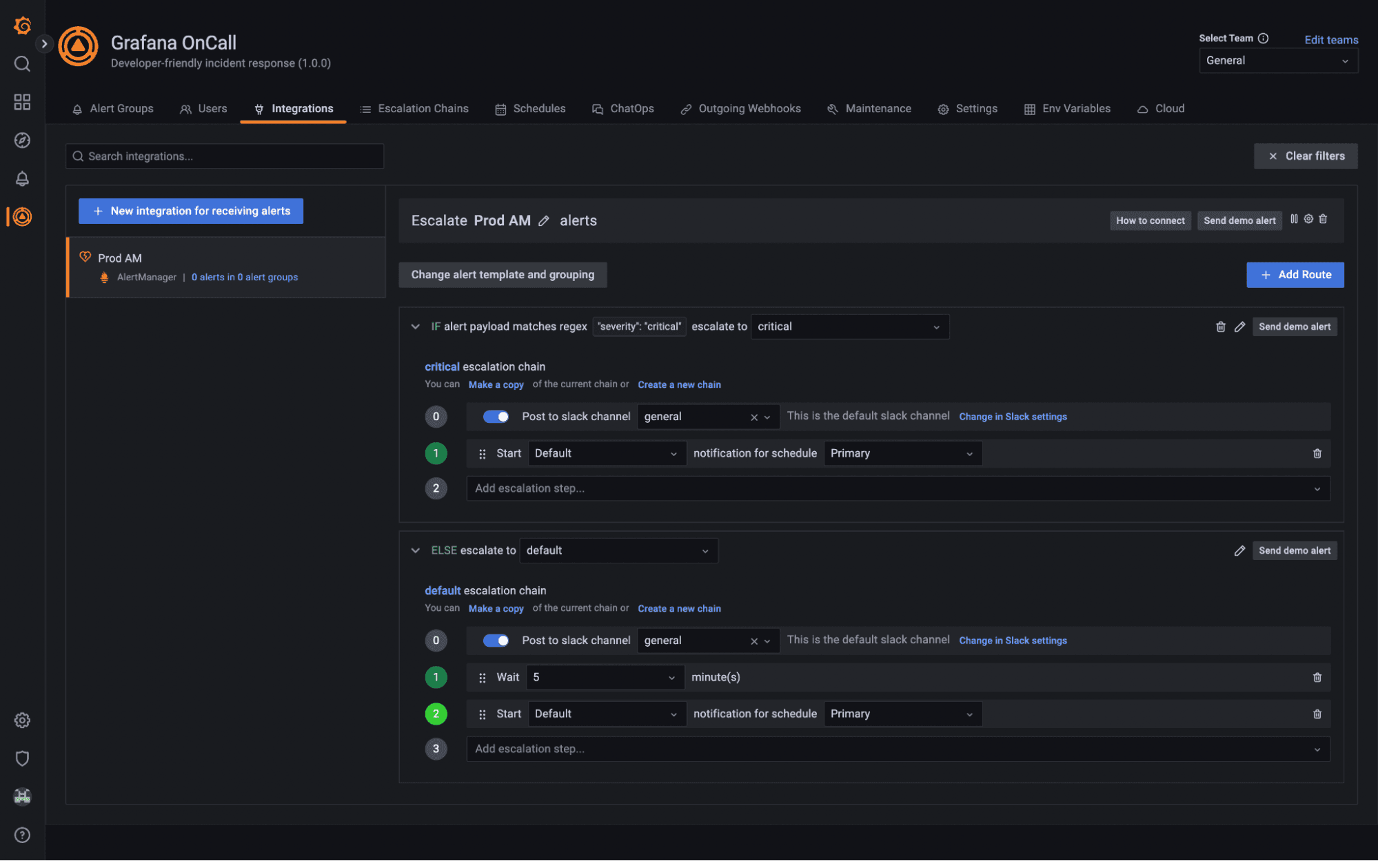

That’s it! Apply config, and validate that everything was set up correctly in the UI.
Screenshot of Grafana OnCall UI with route configured.
You can see the setup described in the create a routes section in this tf file.
