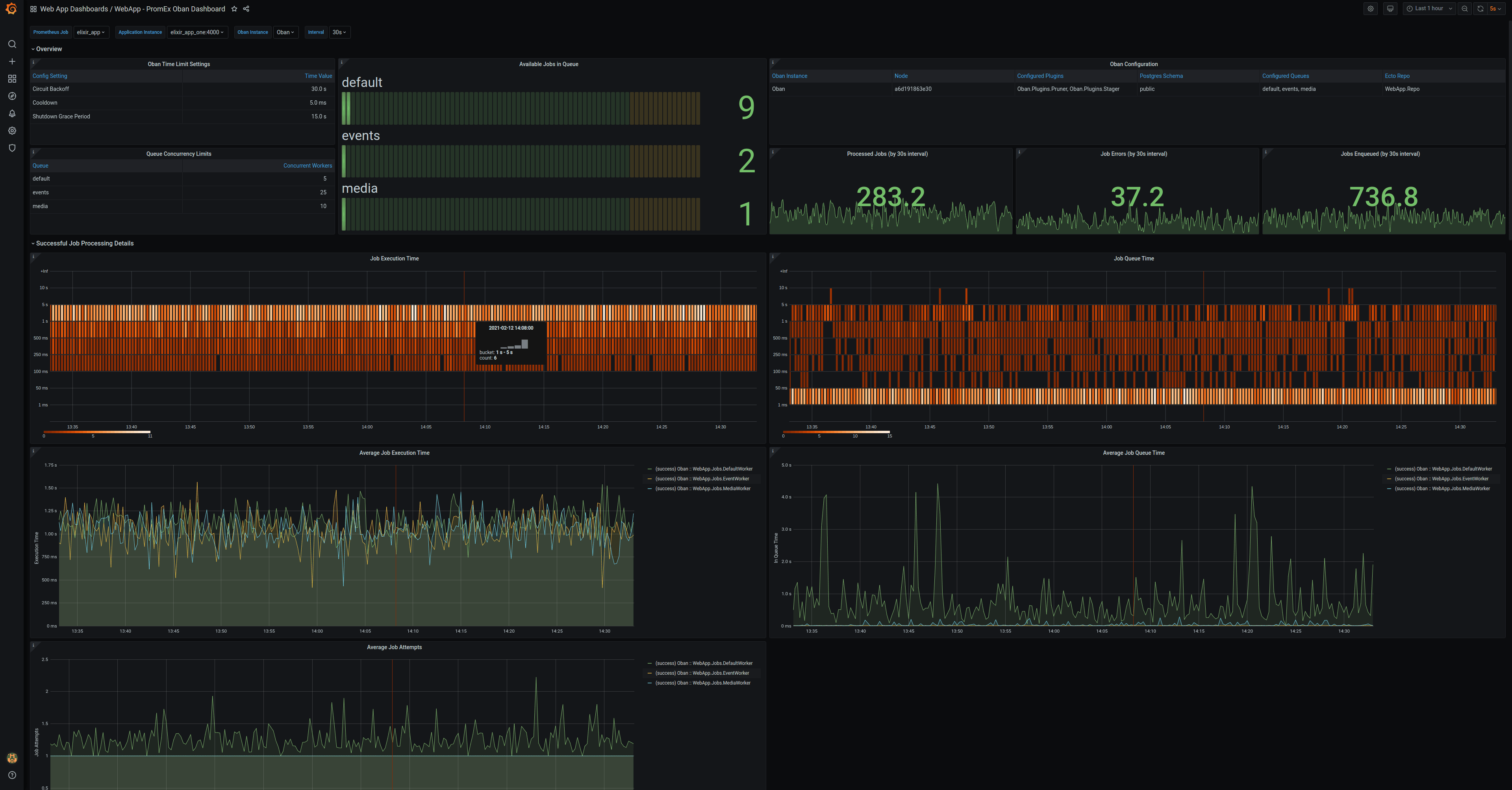

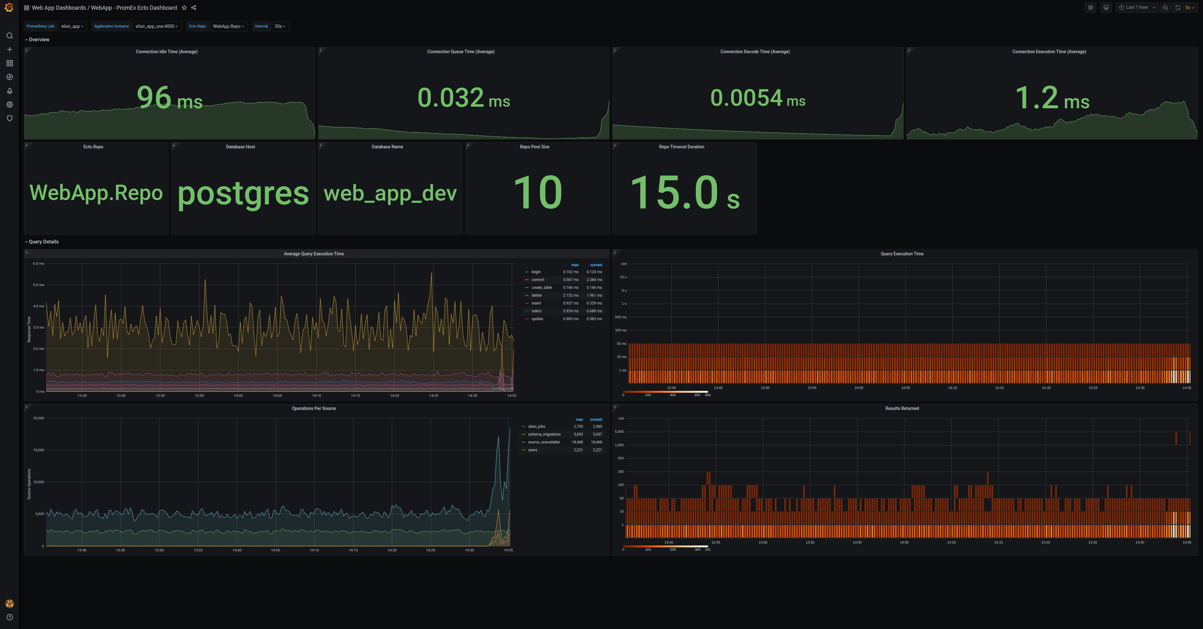

To fix these pain points, PromEx ships with the corresponding Grafana dashboards to visualize the metrics captured by each of the plugins (you can also write your own plugins/dashboards and leverage PromEx the same way that the first-party plugins/dashboards do). As a result, as new versions of PromEx are published, you automatically get new Prometheus metrics and Grafana dashboards without having to do anything. Under the hood, PromEx leverages the Grafana Dashboard API to upload dashboards on application init so you never have to worry about uploading or editing dashboards ever again. In addition, via the Annotations API, PromEx will also annotate the dashboards so you can have lifecycle markers for when an application instance started and when it stopped. That means you can have dashboards like this with zero effort from your end:
Embedded imageEmbedded image
