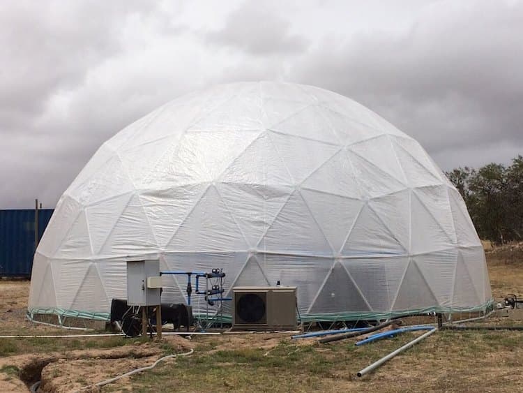

The first challenge I had to overcome was how to house the tanks and grow areas. Most greenhouses or agricultural tunnels are square or rectangular, but I had round fish tanks, approximately 32 feet (~10 meters) in diameter. I didn’t want to waste space so I looked for round structures. There were none to be found.
Square tanks were a no-go because of the flow characteristics — the water would stagnate in the corners and debris would build up. So I turned to Burning Man — obviously. Though I’d never been, I’d seen pictures of geodesic domes at the annual festival, and it became the inspiration for my aquaponics space.
A geodesic dome with accompanying utilities.
I built a production line where I cut and drilled several hundred meters of steel tubing to build a round home for my round tanks. These tanks would house the Nile tilapia (Oreochromis niloticus) we were growing.

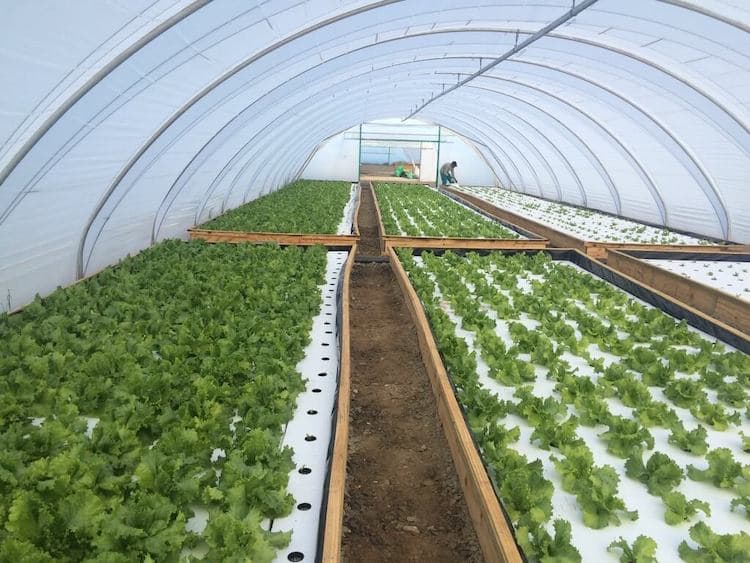

The greenhouse tunnels came next. The troughs for the plants to grow in were pretty simple — plastic-lined with a board of styrofoam floating on top. This allowed the roots to dangle in the nutrient-rich solution flowing through the system.
Rows of lettuce grows inside a tunnel
I quickly realized that to attempt a project like this, I needed to be somewhat proficient in a bunch of different skills: plumbing, welding, electrical engineering, tree-felling, and construction — not to mention the actual farming stuff. But I was bullish and headstrong, so I thought I could do it all. And honestly, it was a great way to learn; it was a time in my life where I developed skills that still serve me to this day. And I figured the bits I couldn’t do would be augmented by the occasional YouTube tutorial.

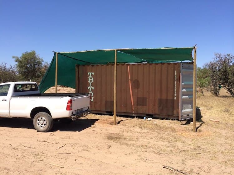

I slept in an uninsulated shipping container — yes, an actual shipping container, not to be confused with the containers we’re more accustomed to in tech — right next to the tanks until I got it sorted, doing patrols of the farm every two hours. Eventually, I didn’t even need an alarm to go check if something was wrong; I could hear the change in pitch of an air blower or a pump stopping when it shouldn’t, and that would wake me in a panic. I still dream of those sounds.

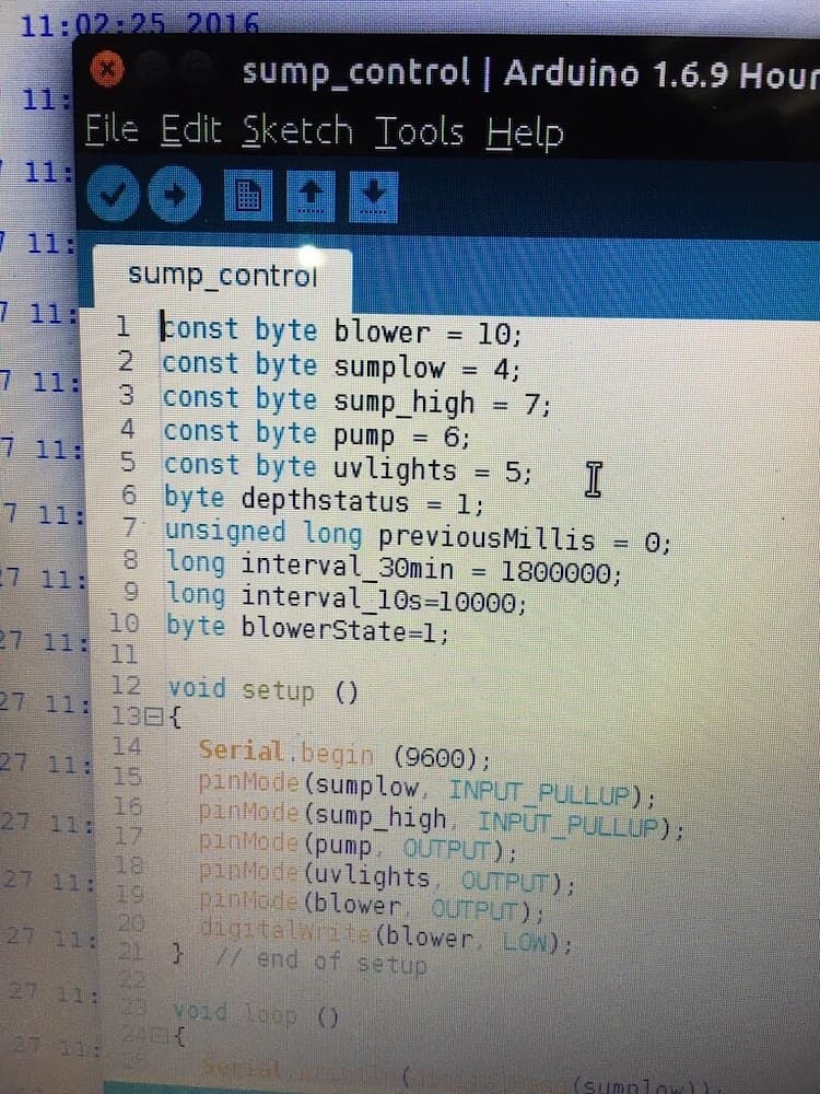

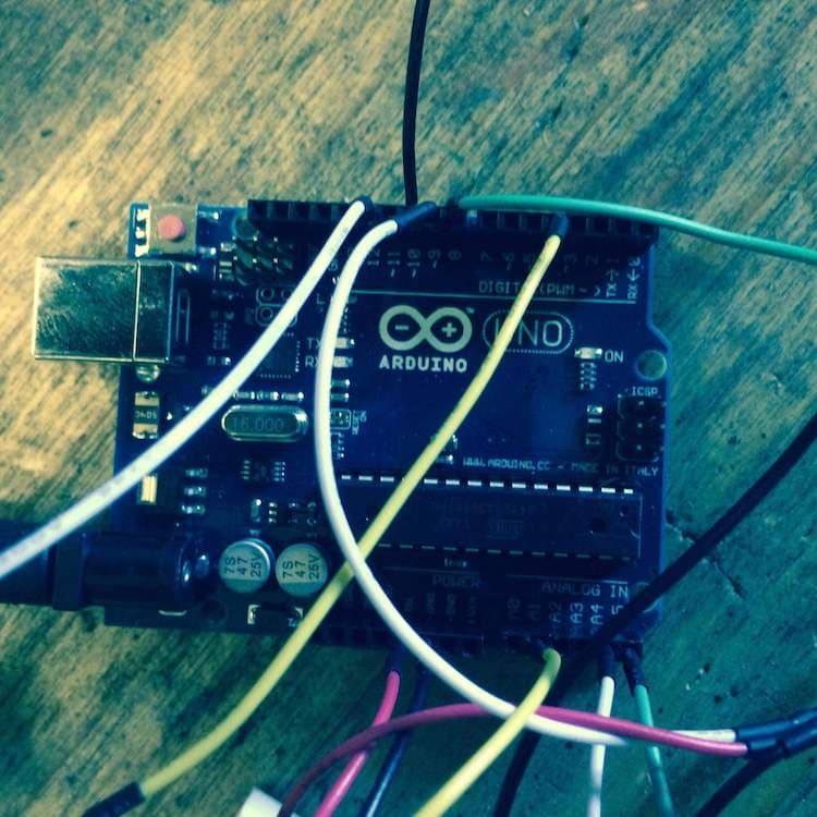

I devoted a large part of my day to fixing my mistakes. There were off-the-shelf solutions for automating pumps and other elements, but I was pretty much broke at that point. I had to build my own.
I had zero knowledge of IoT at this point, and very little coding knowledge, but I was fairly computer literate. I sat and I learned. But wow, that was a steep learning curve. Still, after all that, I finally had a working device, a small Arduino board to turn a pump on and off, and it changed my world.
A screenshot of code used for the aquaponics monitoring system.
I went mad with power. Every single piece of machinery on the farm got a microcontroller. Every tank and trough got multiple probes, checking parameters like salinity, pH, temperature, dissolved solids, O2, and nitrogen content. Pumps had multiple in-line flow meters installed. Water levels were checked with float switches and double-checked with ultrasonic sensors. (In hindsight, getting sub-millimeter water levels was perhaps a little bit too much resolution, but to paraphrase Jeff Goldblum in “Jurassic Park,” I was only preoccupied with whether I could, and didn’t stop to think if I should.)
A picture of a microcontroller with wires attached.

I spent hours each day learning and coding these little devices, networking them together, and pulling the data out. Then I spent hours each night with my laptop balanced on the rim of a fish tank trying to debug what I had done wrong during the day.
The boards I used were Arduino and Raspberry Pis, as well as a variety of off-the-shelf sensors for the environmental parameters. Over time a control and monitoring system evolved on the farm. I wrote an iOS app for my phone that alerted me if there was an error anywhere. (No more night patrols!)

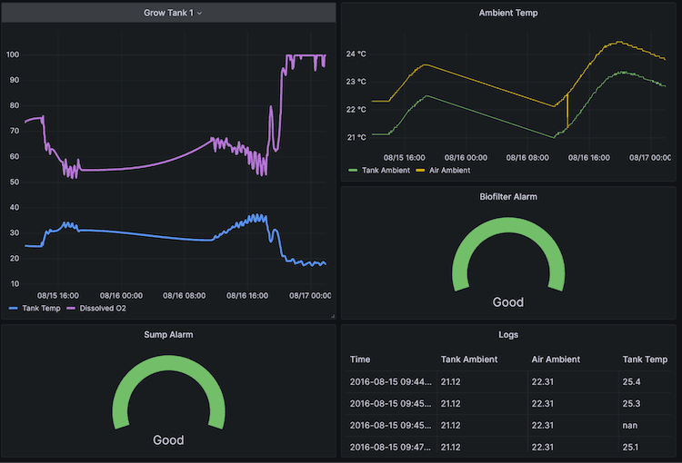

I used PubNub to query all the boards and then dump that data to a PostgreSQL database running on a central server (an old laptop in, again, a shipping container). At first I would just print this data to a terminal but I stumbled across a visualization tool called Grafana, and it was like walking out of the dark cave and into the light. I could see my data!
A Grafana dashboard circa 2016.
And this wasn’t just about making things look pretty. Because I could visualize the data from multiple sources from around the farm in one dashboard, it helped me see patterns that I hadn’t even noticed before. It challenged assumptions I’d made about the relationship between certain variables and parameters because now I could see more than one data series, not just a wall of numbers printed out to the terminal.
How does pump velocity affect the dissolved oxygen in a tank? Does the pH change with temperature? These were questions I could answer quickly and easily with Grafana. I finally had visibility into the entire system, and I could explore what was happening within each data stream. There was a direct correlation between visualizing my data in a cohesive manner and improving how I farmed.

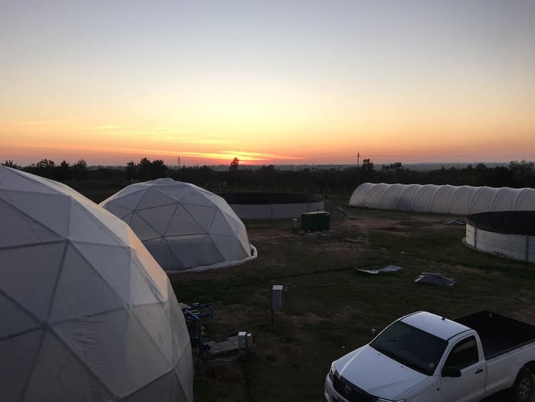

A picture of domes and tunnels on the farm at sunset.
