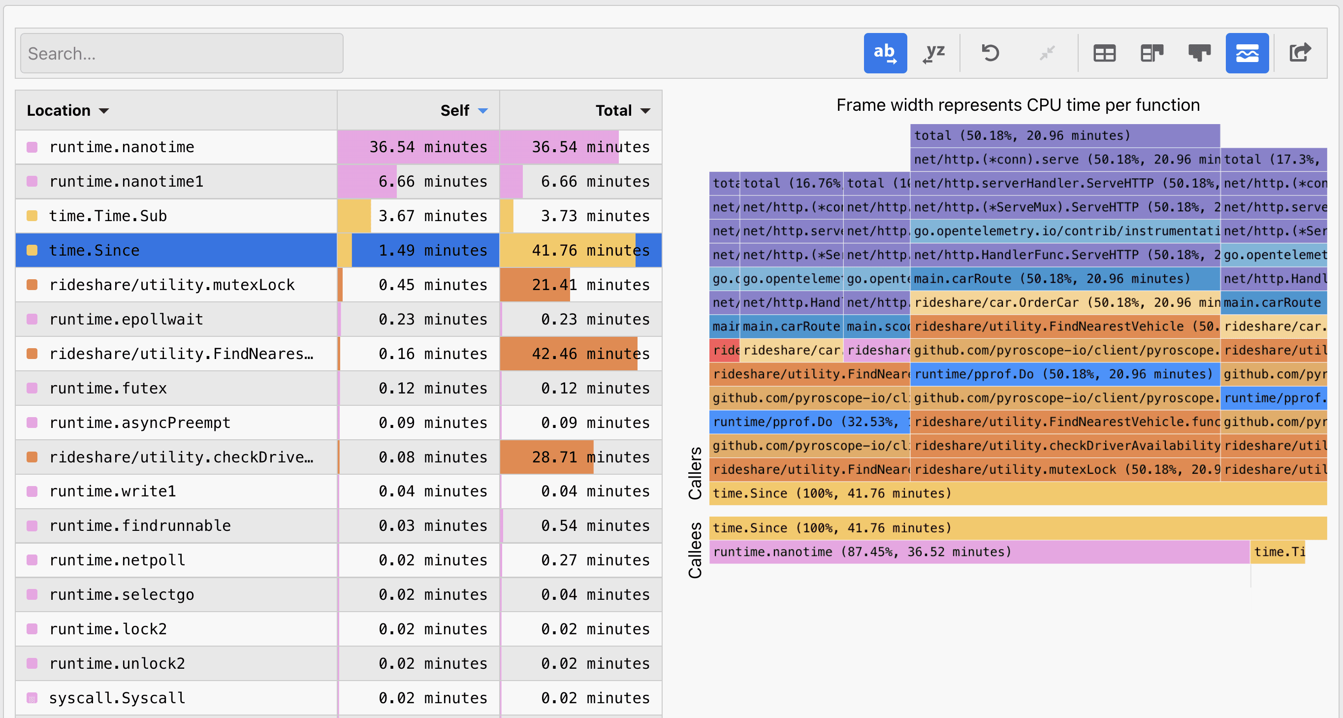

However, you’ll also notice that Time.Since() shows up frequently towards the end of almost every path.
Sandwich view helps you focus in on functions like this to analyze your application and determine if it’s easier to optimize:
Time.Since(): A node with a shorter width that gets called frequently across many code paths discovered with sandwich view.rideshare/car.OrderCar: A node with a longer width, that gets called infrequently in a single code path discovered with standard flame graph view.

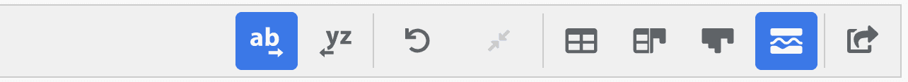

If you want to try it out simply go to your Pyroscope UI or upload a flame graph to flamegraph.com and select the “sandwich view” icon in the new flame graph toolbar:
Then you can select a function to see its callers and callees. We have many more view modes planned for the future, so stay tuned or let us know what you’d like to see!
