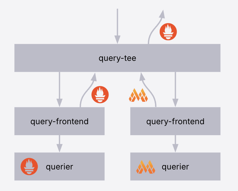

Second, we ran a parallel query path in Grafana Cloud’s staging environment using Mimir query-tee to compare the results from real, live queries. This helped us catch possible correctness issues and edge cases that might be missed from the unit tests alone.
The diagram above shows how the parallel query path works. The same query comes to query-tee which is fanned out to a Prometheus read path and MQE read path. Each query-frontend will forward the request downstream and return each result back to query-tee, which will perform a comparison, alerting us to discrepancies between the two engines.
