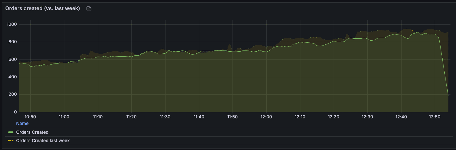

One of Glovo’s most important metrics is used to track orders created. The volume changes throughout the day, with more orders around lunch and dinner times. And as you can imagine, incidents that occur during those busier times have an outsized impact. So going back to our example from the beginning, this is not what you want to see as you close in on 1 p.m.:
Grafana dashboard shows a big drop in orders created
“As SREs, we are kind of in the dark when such incidents happen because any part of our distributed system could fail causing the order loss,” Deepika said. “So we built many custom dashboards and metrics in Grafana, which helps us during such incidents.”
In this example, engineers dug deeper into a RED metrics dashboard and learned it was a downstream dependency that failed because it was rate limiting checkouts. From there, they learned that it was tied to a code change and quickly rolled back the deployment. In under five minutes, they were back to normal.

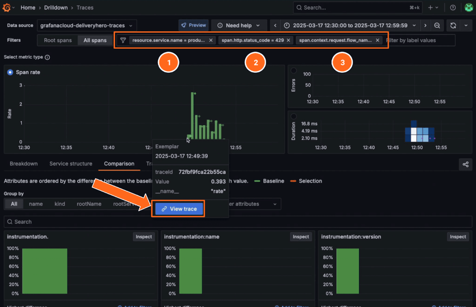

With few options left, they turned to Traces Drilldown, which, at the time, was a new feature they had early access to. They ultimately opted to work backward from the product-catalog API traces, which was as easy as selecting the service name and filtering from there. And since they wanted to focus their search on rejections from the product catalog, they also filtered by HTTP status code.
“Drilldown shows you very nicely that you can select one of the status codes that appears in the spans,” Alex said. “The next step was very useful because we didn’t know exactly what attributes to look for, so the comparison tab gives you insight on what attributes are having different values from the baseline.”
Next, they identified a client with much higher values than the rest, and filtered by that as well.
Filters applied in Traces Drilldown UI
“Here we knew that this was a cascading failure. We knew that the database issue was caused by something else, so we wanted to check some exemplars from the beginning of the incident to see what caused this. So that’s exactly what we did here. We checked one of the first seconds of the incident, opened a trace, and looked inside the trace.”
From there, they were able to go deeper and find longer running spans tied to request times and also began looking at how it all connected to their database issue. Ultimately, this led to them quickly discovering the root cause: The checkout API was calling the product catalog, which was getting rate limited. There were retries and long wait times between retries, and at the same time they were holding connections from the thread pool for the database and new connections to the checkout API. As a result, new requests could not fulfill their processing because the connection was being held.
