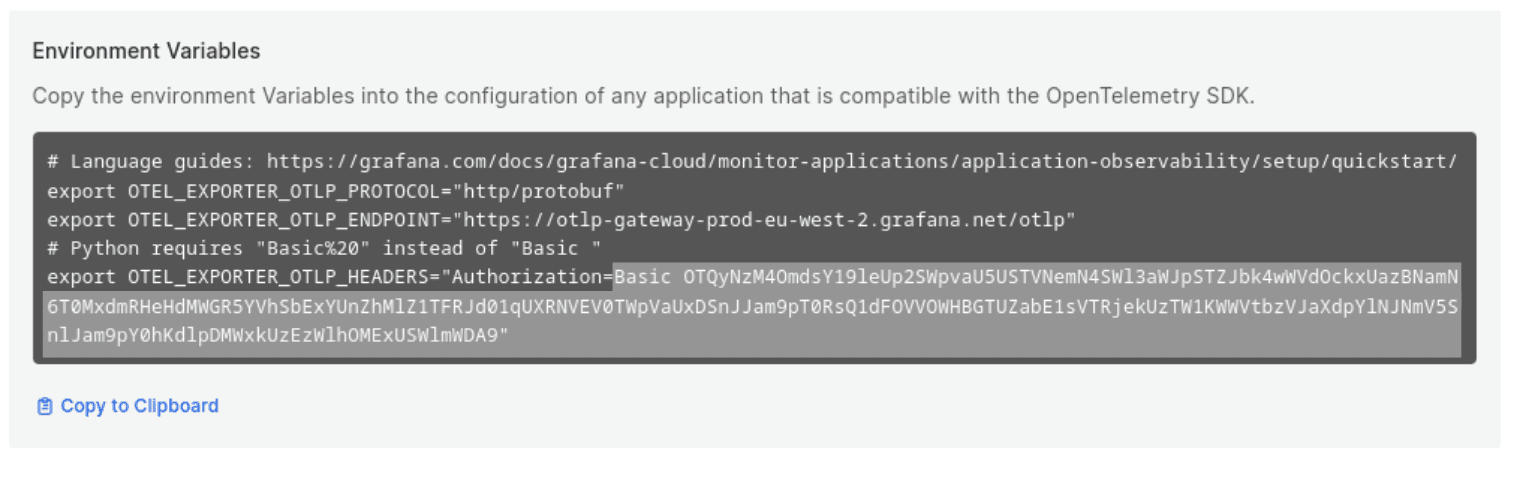

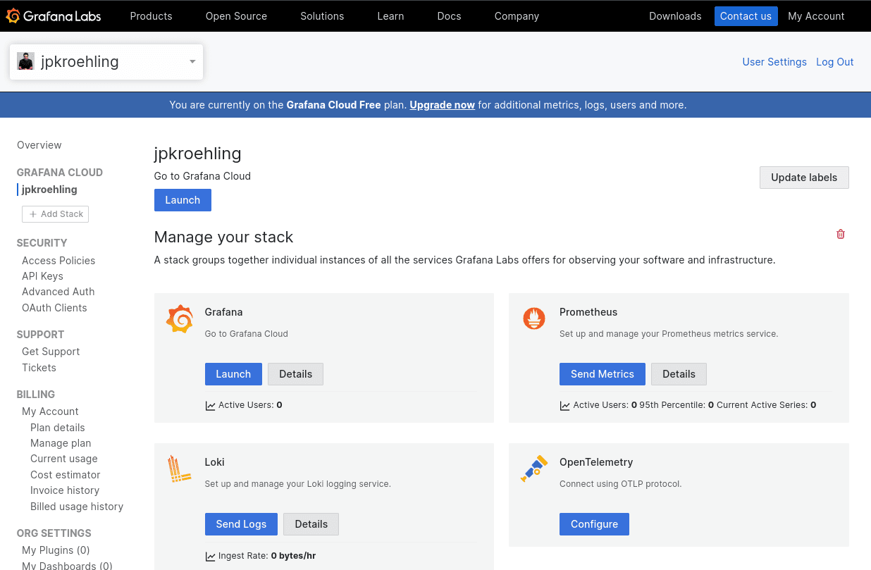

Manage your stack page in the Grafana Cloud UI
Also on that page, we can look at the environment variable OTEL_EXPORTER_OTLP_HEADERS that is shown after generating a token. Keep this handy, as we’ll need the value of the Authorization header later.
A screenshot of Environmental Variables code

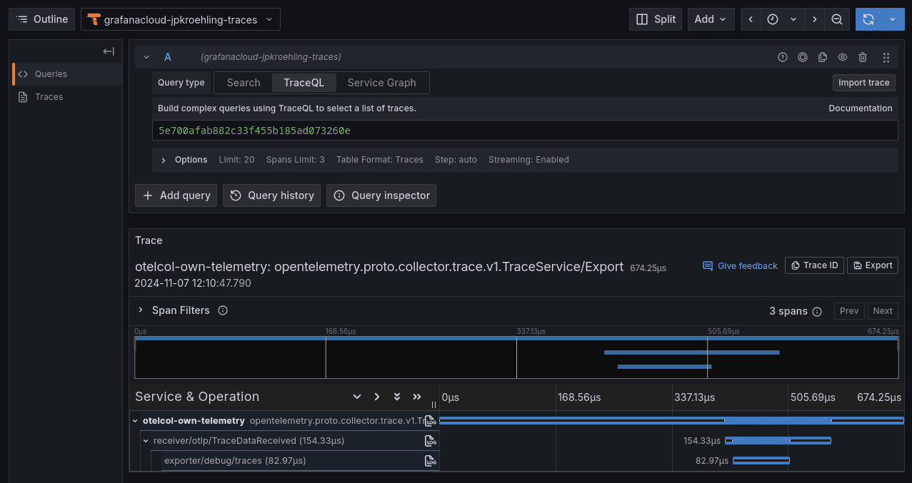

  3. Send some telemetry to the Collector. By default, each trace reported by telemetrygen comes with two spans. Note that this telemetry will be discarded with the configuration provided, but the actions the Collector performed will be recorded:
    telemetrygen traces --traces 1 --otlp-insecure --otlp-attributes=‘cookbook=“own-telemetry”’
  4. On Grafana Cloud, select the traces data source and you’ll be able to find a trace that represents the Collector processing of the telemetrygen call:

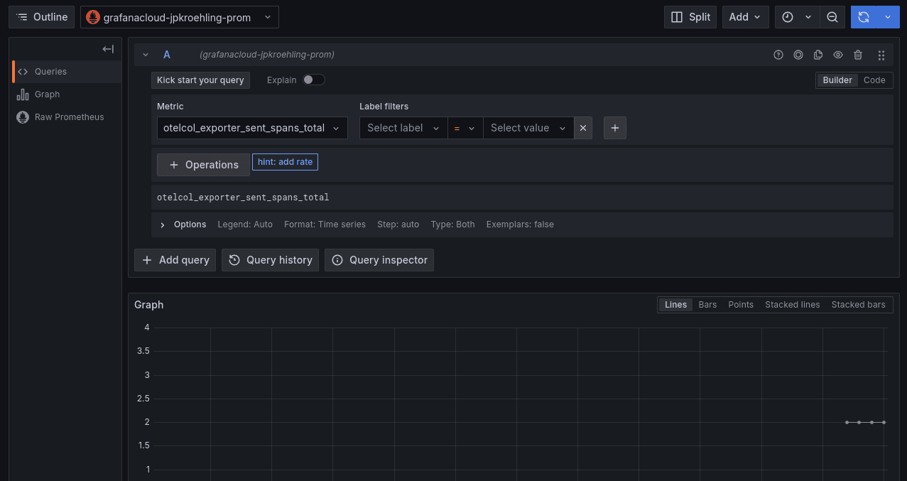

  1. Now, change to your metrics data source, and select the metric otelcol_exporter_sent_spans_total. We can see that our Collector reported that it received the two spans.
A screenshot of the query UI in Grafana Cloud

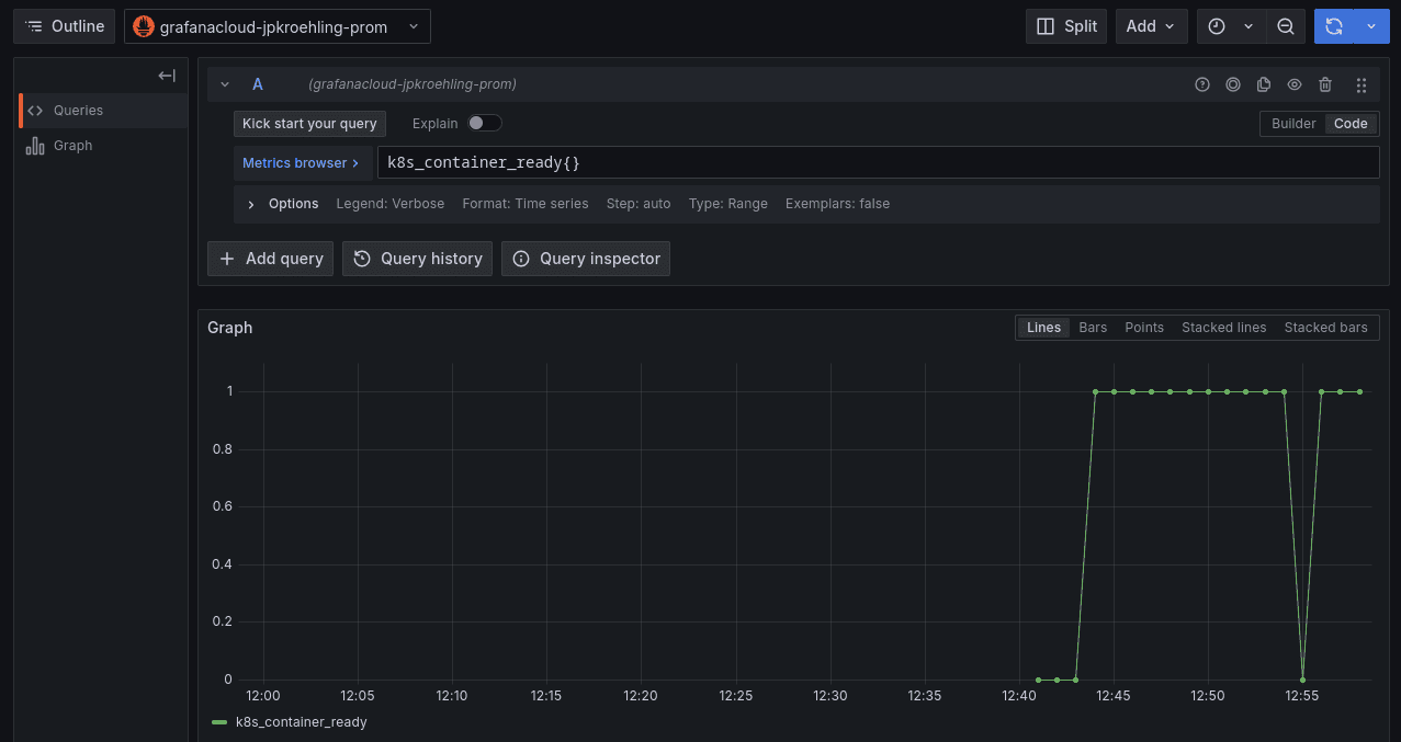

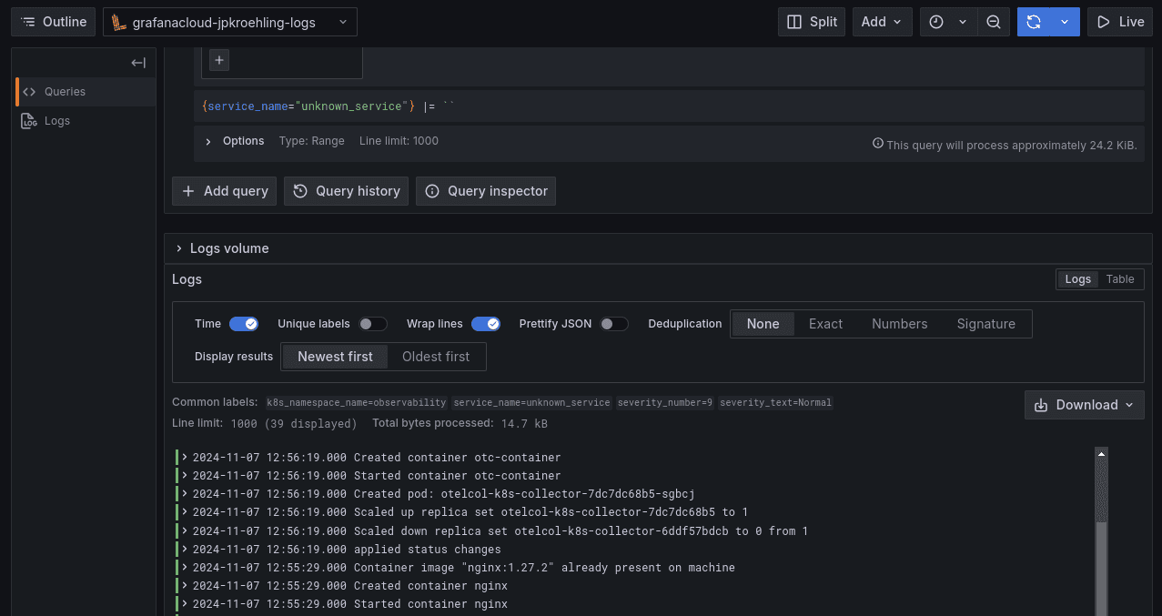

  1. At this point, you should have received a few events in your Grafana Cloud instance.
Events populating in Grafana Cloud

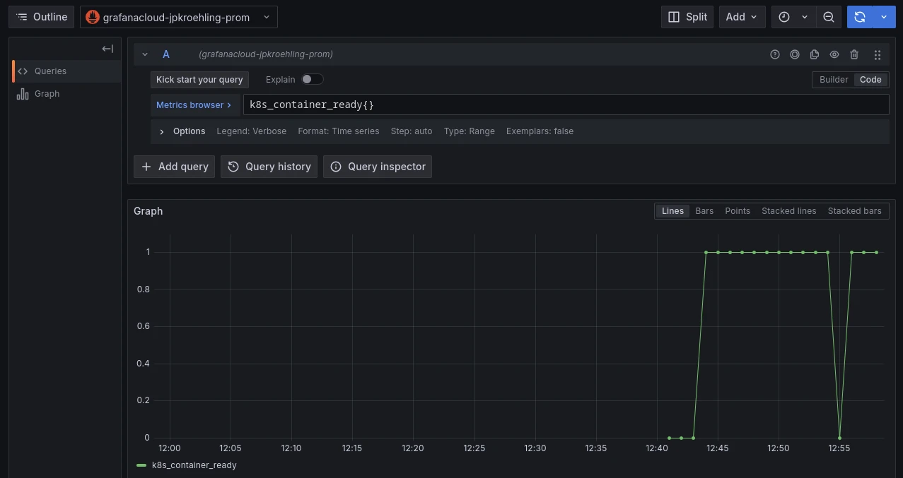

  • Kubernetes metrics, such as k8s_container_ready, should also be available.
Metrics populating a graph in the Grafana UI

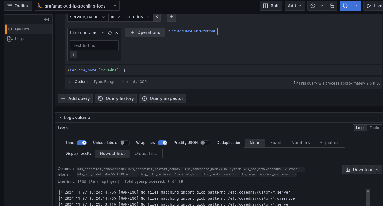

  3. After a few moments, you should start seeing logs from the containers in the cluster.
Grafana Cloud Logs query

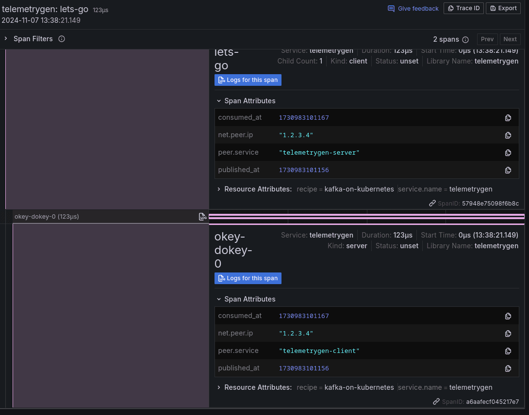

For dessert, we present a sophisticated configuration involving a Kafka buffer with two layers of Collectors—appreciated in highly scalable scenarios for its ability to handle a spike in telemetry volume without stressing the backend or affecting the ingestion layer.
The first layer collects telemetry from business services running in Kubernetes and publishes it to a Kafka topic. The second layer consumes these events and sends them to the telemetry storage.

  7. Now, we need to send some telemetry to our “pub” Collector. If we don’t have a workload in the cluster available, we can open a port-forward to the Collector that is publishing to Kafka and send data via telemetrygen to it:
    kubectl port-forward svc/otelcol-pub-collector 4317 telemetrygen traces --traces 2 --otlp-insecure --otlp-attributes=‘recipe=“kafka-on-kubernetes”’
  8. You should now see two new traces in your Grafana Cloud Traces view, like the following. Note that we are adding new attributes to the spans, recording the timestamp when they were placed at topic (published_at) and retrieved from it (consumed_at).
Grafana Cloud Traces UI
