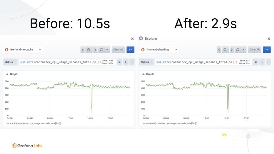

…executing each of the “partial” aggregations on a different worker. Early results from a test and staging environments show this can results in ~5x reduction in query latency for high-cardinality queries.
There is a lot of subtlety here: ensuring labels are propagated correctly between the partial aggregations; ensuring things like binary operations are not sharded; translating queries that cannot easily be sharded into ones that can (such as translating an average into a sum divided by a count). The Cortex query frontend is starting to look a lot like a query planner with a healthy dose of MapReduce thrown in…
This is still an active work-in-progress, and I want to give a big shout-out to Owen Diehl and Cyril Tovena for this amazing work. Once we have this in production with Cortex, we’re really excited about making this technique available to things like Thanos, where it will allow us to push the partial aggregations out to the edge Prometheus instances and not have to ship the chunk data across the wide area network.
