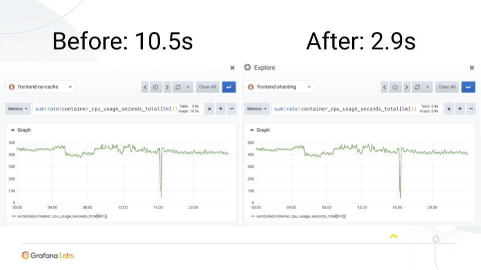

New to the KubeCon talk was the concept of aggregation sharding. This is where we effectively take queries that look like this…
sum(rate(foo{bar=”baz”}[1m]))
…and turn them into queries that look like this…
sum(
sum(rate(foo{bar=”baz”, shard=”1”}[1m]))
sum(rate(foo{bar=”baz”, shard=”2”}[1m]))
sum(rate(foo{bar=”baz”, shard=”16”}[1m]))
…executing each of the “partial” aggregations on a different worker. Early results from a test and staging environments show this can results in ~5x reduction in query latency for high-cardinality queries.
There is a lot of subtlety here: ensuring labels are propagated correctly between the partial aggregations; ensuring things like binary operations are not sharded; translating queries that cannot easily be sharded into ones that can (such as translating an average into a sum divided by a count). The Cortex query frontend is starting to look a lot like a query planner with a healthy dose of MapReduce thrown in…
