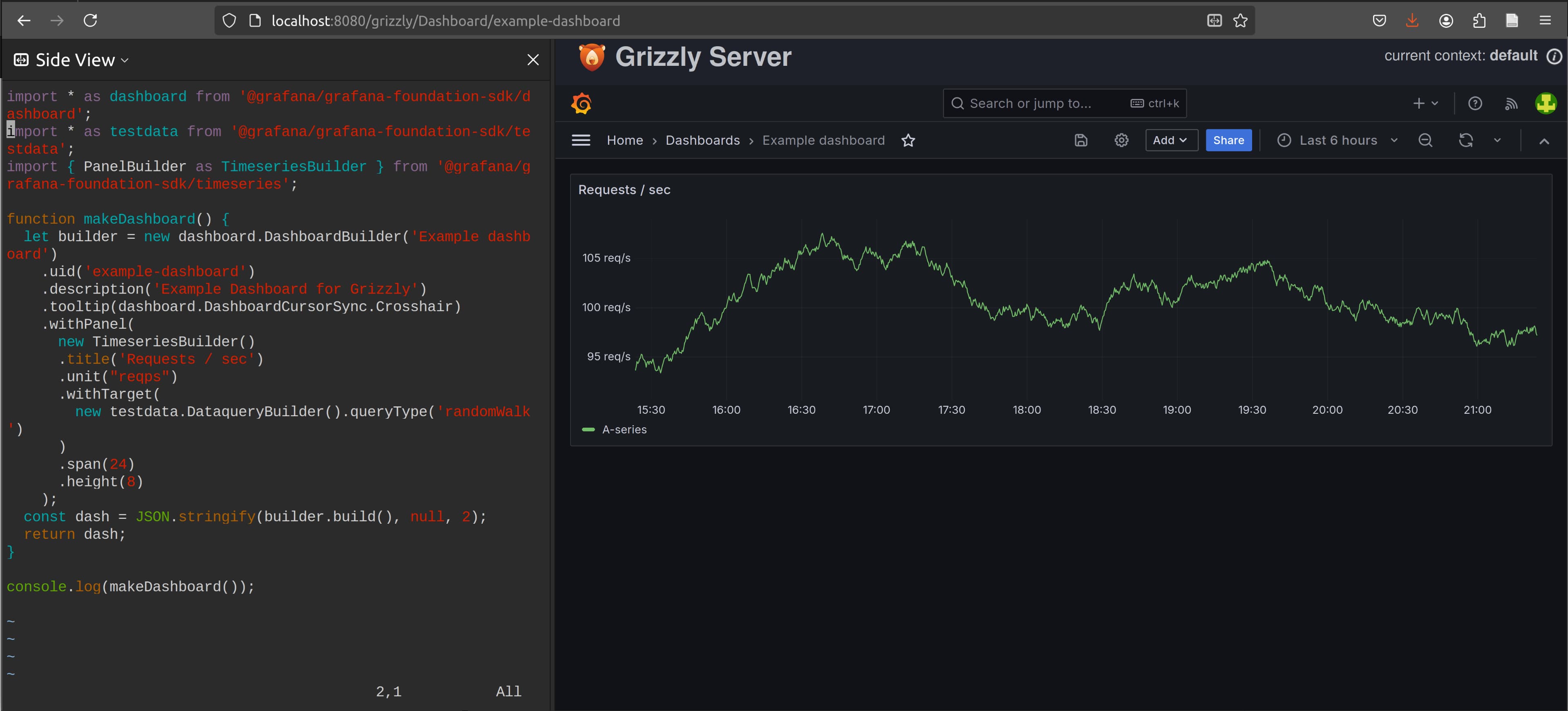

Then we can review and edit this dashboard with:
grr serve my-dashboard.json
This will open a web server (by default) at http://localhost:8080. Visiting that URL in a browser will show the name of our dashboard within the Grizzly serve UI. Clicking on the link to our dashboard, we’ll see our dashboard in the configured Grafana instance.
Note: This dashboard DOES NOT exist in our Grafana instance. Grizzly runs client-side, intercepting requests to Grafana and reading your dashboard JSON from disk.

Now, let’s say we run our code with npx ts-node main.ts. Then we can tell Grizzly to watch for changes in our main.ts file, and then execute our npx command to regenerate the dashboard:
grr serve -w -S 'npx ts-node main.ts' main.ts
We can then visit the Grizzly server at http://localhost:8080, and select our dashboard. Now, when we change main.ts (e.g., change the dashboard title) and save it, we can reload the dashboard and see the changes in our Grafana instance. Requirements: Golang

Now we can tell Grizzly to watch for changes in our main.php file, and then execute our code to regenerate the dashboard:
grr serve -w -S 'php main.php' main.php
We can then visit the Grizzly server at http://localhost:8080, and select our dashboard. Now, when we change main.php (e.g., change the dashboard title) and save it, we can reload the dashboard and see the changes in our Grafana instance.
See Grizzly serve in action
