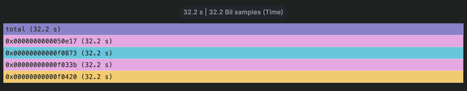

Here's what that data looks like before symbolization:
Flame graph with five horizontal sections, each labeled with hexadecimal codes and "32.2 s", representing time distribution.
Raw memory addresses. Long strings of hexadecimal with no obvious meaning.
Which function is actually consuming CPU? Where in your code should you even start looking? To make sense of this, you'd need to manually map each address back to your binary, assuming you have the exact version that’s running in production. In many cases, that’s slow, error-prone, or simply impossible.

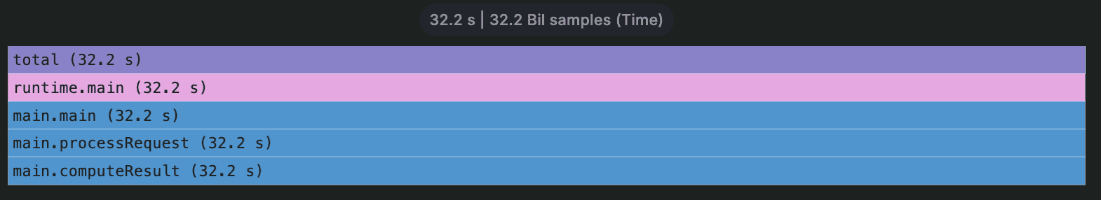

Now, you look at the same profile with symbolization enabled:
Flame graph with a timeline in purple, pink, and blue bars, all showing a duration of 32.2 seconds.
Suddenly, everything clicks. You can see exactly what's consuming CPU: main.computeResult is your bottleneck. You know which function to investigate, and can jump straight to the source code to start optimizing.
This transformation from useless hex addresses to actionable function names is symbolization. And for eBPF profilers, making this happen is far more complex than it might seem.
