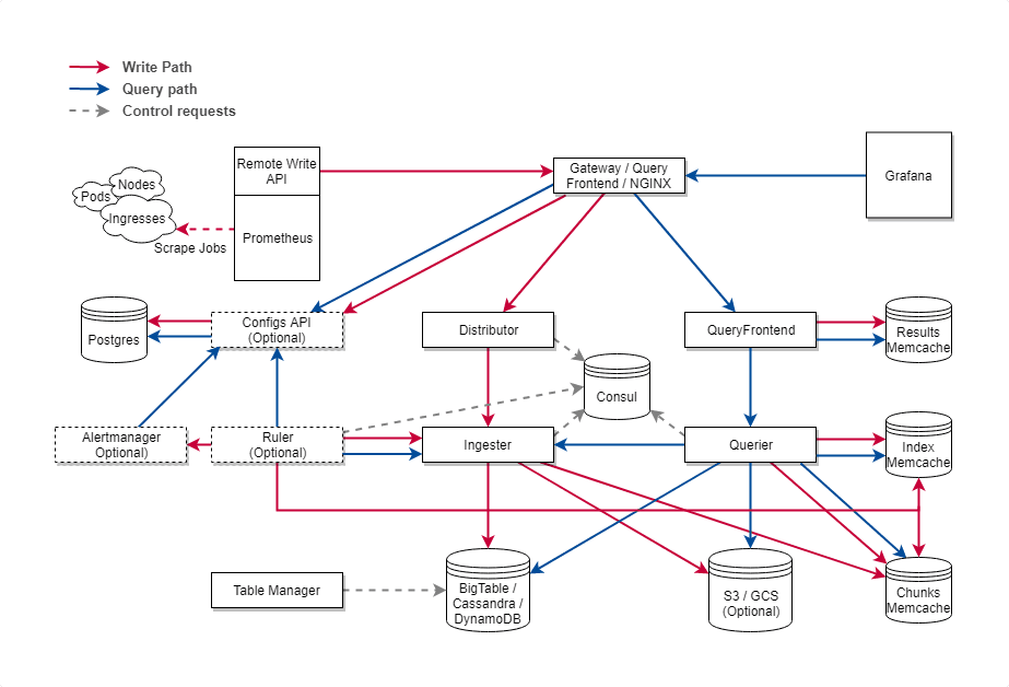

To accomplish this we rely on the client-side configuration of unique external labels for each HA instance to deduplicate before storage. The reserved labels, such as prom_ha_cluster and prom_ha_instance, are used to differentiate between replicas and only store samples from a single replica in a Prometheus HA cluster at a time. These labels can be configured per Cortex tenant.
How It Works
HA sample handling is done in the distributor. First, we check to see if an incoming sample contains both the previously mentioned labels. If not, we accept it by default. If both labels are found, we check the distributor’s local cache for which replicas it’s accepting samples from to decide what to do with the sample. Internally these are referred to as “elected” replicas. On each successful write to the KV store for a given cluster/replica, we store the timestamp when we elected that replica.
