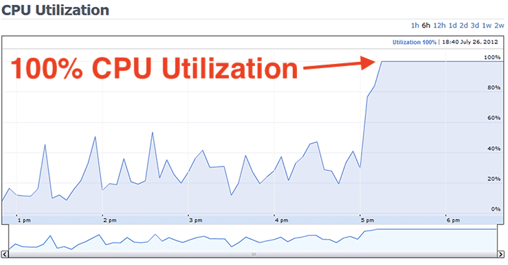

So when you see a graph of CPU utilization that looks like this:
CPU utilization graph
During the period of 100% CPU utilization, you can assume:
  • End users are having a frustrating experience (i.e., App/Website is loading slow)
  • Server costs will increase after you provision new servers to handle the additional load
The question is: Which part of the code is responsible for the increase in CPU utilization? That’s where flame graphs come in!

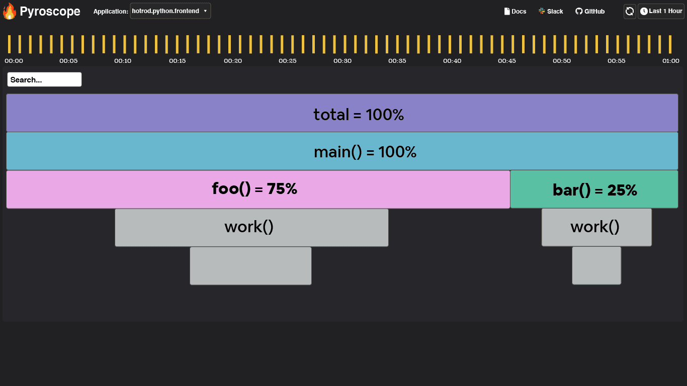

Let’s say the flame graph below represents the time span that corresponds with the “incident” in the picture above where CPU usage spiked. During this spike, the server’s CPUs were spending:
  • 75% of time in foo()
  • 25% of time in bar()
  • $100,000 on server costs
Flame graph
You can think of a flame graph like a super detailed pie chart, where:
  • The width of the flame graph represents 100% of the time range
  • Each node represents a function
  • The biggest nodes are taking up most of the CPU resources
  • Each node is called by the node above it
In this case, foo() is taking up 75% of the total time range, so we can improve foo() and the functions it calls in order to decrease our CPU usage (and save $$).

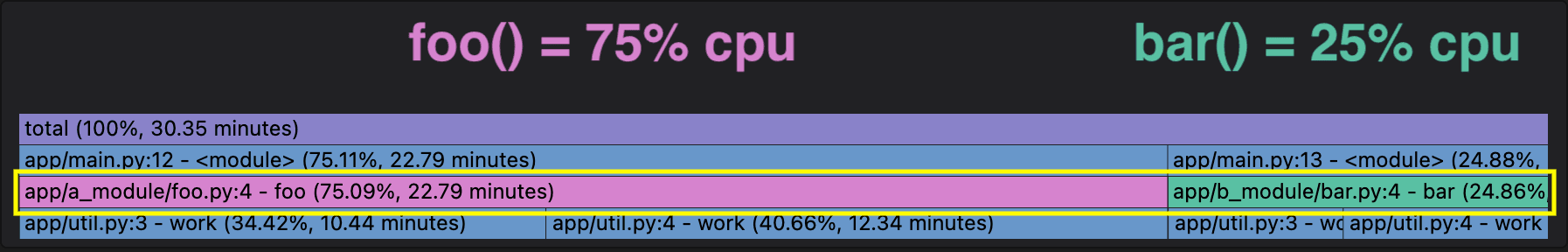

To recreate this example with actual code, we’ll use Pyroscope,an open source continuous profiler that was built specifically for debugging performance issues. To simulate the server doing work, I’ve created a work(duration) function that simulates doing work for the duration passed in. This way, we can replicate foo() taking 75% of time and bar() taking 25% of the time by producing this flame graph from the code below:
Pyroscope UI
# where each iteration simulates CPU time
def work(n):
    i = 0
    while i < n:
        i += 1
# This would simulate a CPU running for 7.5 seconds
def foo():
    work(75000)
# This would simulate a CPU running for 2.5 seconds
def bar():
    work(25000)

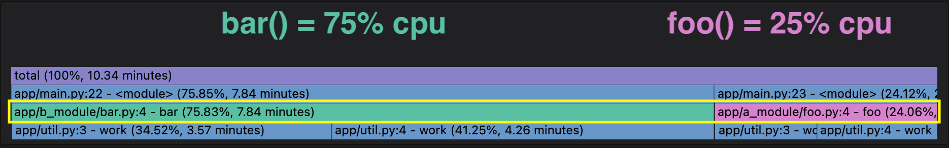

Then, let’s say you optimize your code to decrease foo() time from 75,000 to 8,000, but left all other portions of the code the same. The new code and flame graph would look like:
Pyroscope UI
# This would simulate a CPU running for 0.8 seconds
def foo():
    # work(75000)
    work(8000)
def bar():
    work(25000)
Improving foo() saved us $66,000

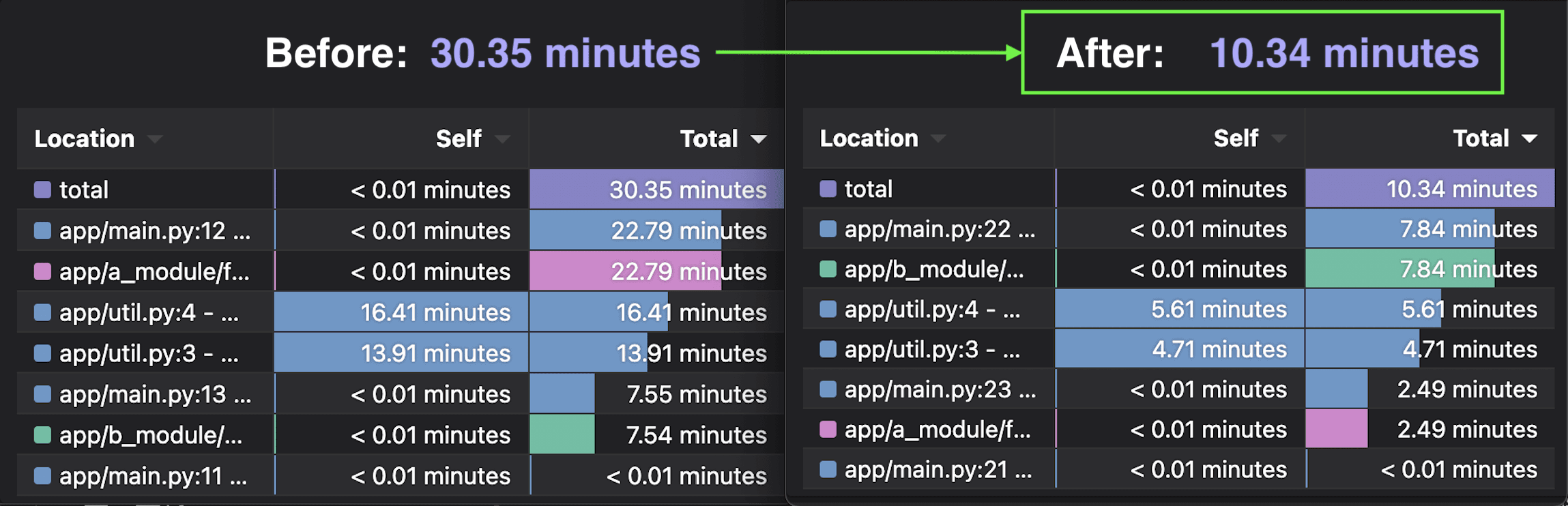

Thanks to the flame graphs, we were able to identify immediately that foo() was the bottleneck in our code. After optimizing it, we were able to significantly decrease our cpu utilization.
Before and after comparison in Pyroscope
This means your total CPU utilization decreased 66%. If you were paying $100,000 dollars for your servers, you could now manage the same load for just $34,000.
