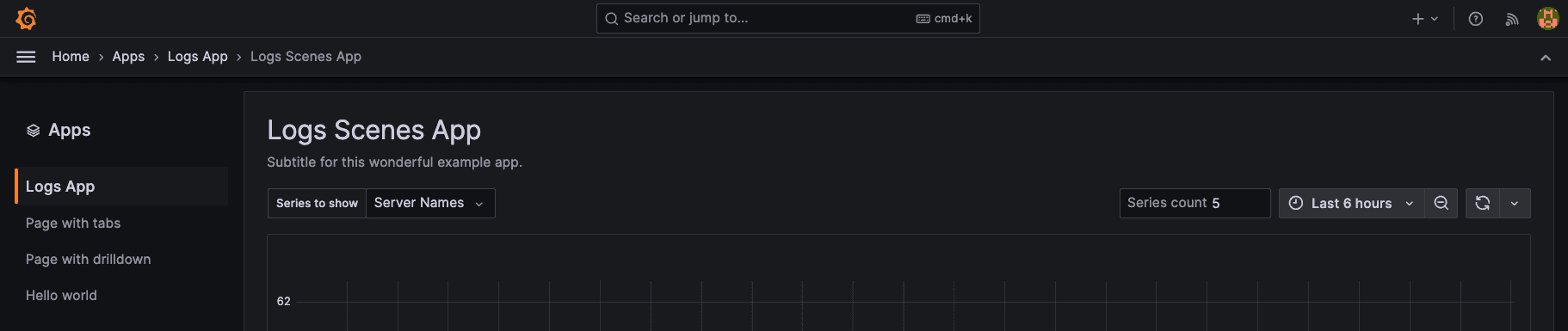

Next, customize the title and subtitle of your app, which should be reflected in your development instance.
A screenshot of the title and subtitle for the Logs Scenes App

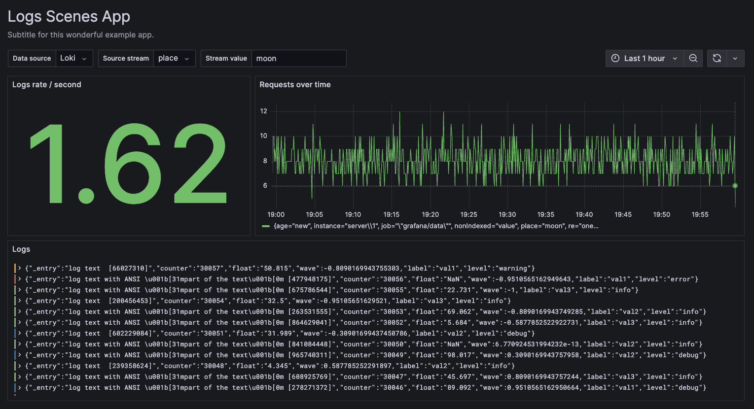

And if all went well, you should see something like this:
A screenshot of the Logs Scenes App
As a final note, don’t forget to enter a value for the stream value input, so Loki knows what data to get.
