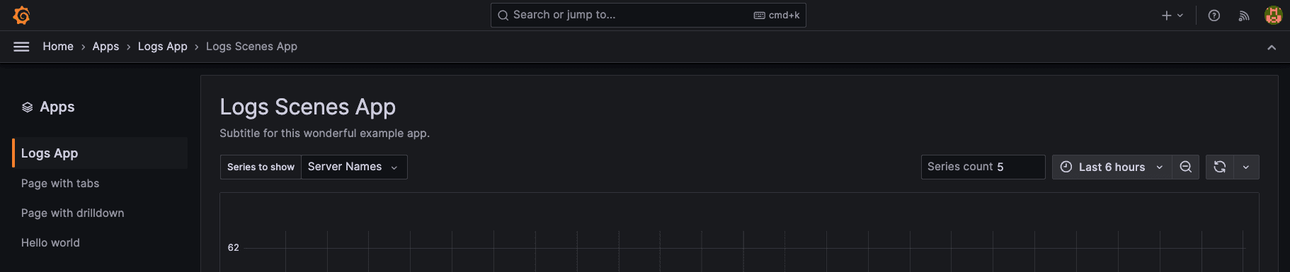

Home page of the scene
To confirm that your Grafana instance is running your project, within your instance in http://localhost:3100, go to Apps in the left-side menu. Once there, you should see a link with the name you configured when creating an empty project. The boilerplate Scenes app comes with three routes: Page with tabs, Page with drilldown, and Hello world, as seen in the screenshot below. (If you haven’t already, this would be a good time to familiarize yourself with the Scenes folder structure and the sample code that comes with it.)
For our example, we’re going to focus on the Home route located in src/pages/Home.tsx, the component that is rendered when the user browses the default page of your app plugin.
The most important objects in this component are:
  • SceneApp: Responsible for top-level pages routing.
  • scene.Component: Used in render functions to render your SceneApp.
Next, customize the title and subtitle of your app, which should be reflected in your development instance.
A screenshot of the title and subtitle for the Logs Scenes App

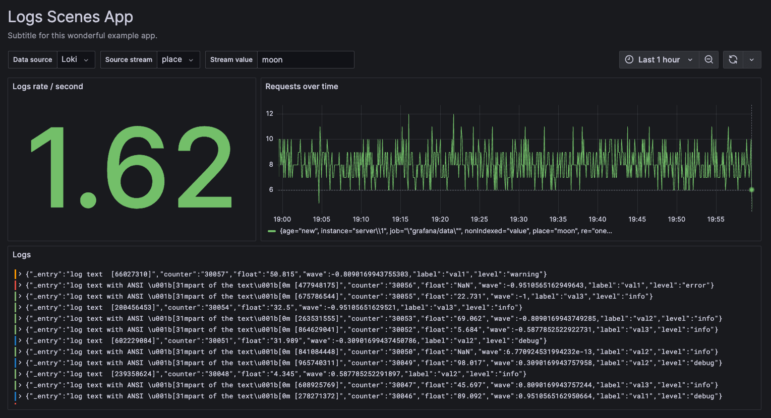

And if all went well, you should see something like this:
A screenshot of the Logs Scenes App
As a final note, don’t forget to enter a value for the stream value input, so Loki knows what data to get.
