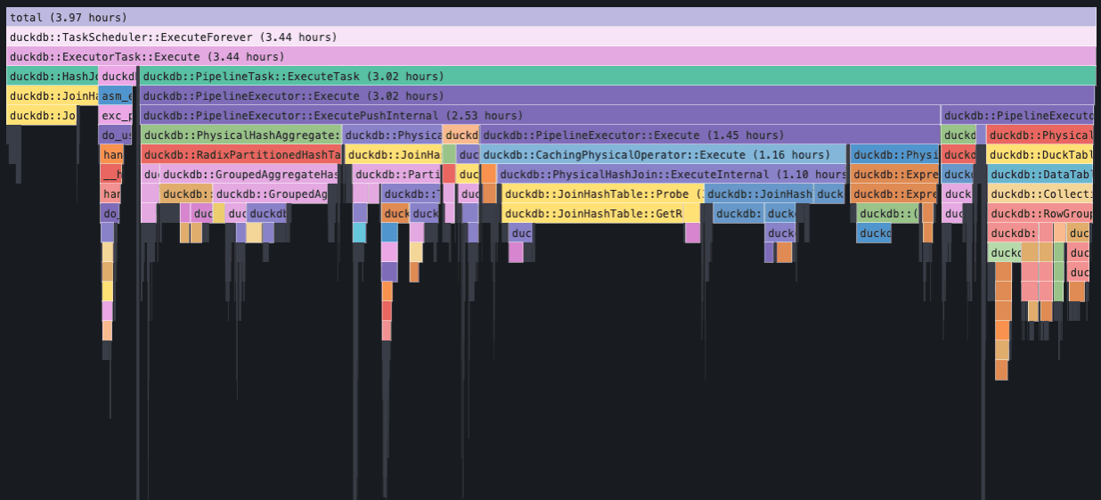

Further context is provided by the flame graph view. We can limit it to ExecutorTask::Execute function here for better visibility:
A flame graph visualizing time distribution of various tasks and processes over a total of 3.97 hours.

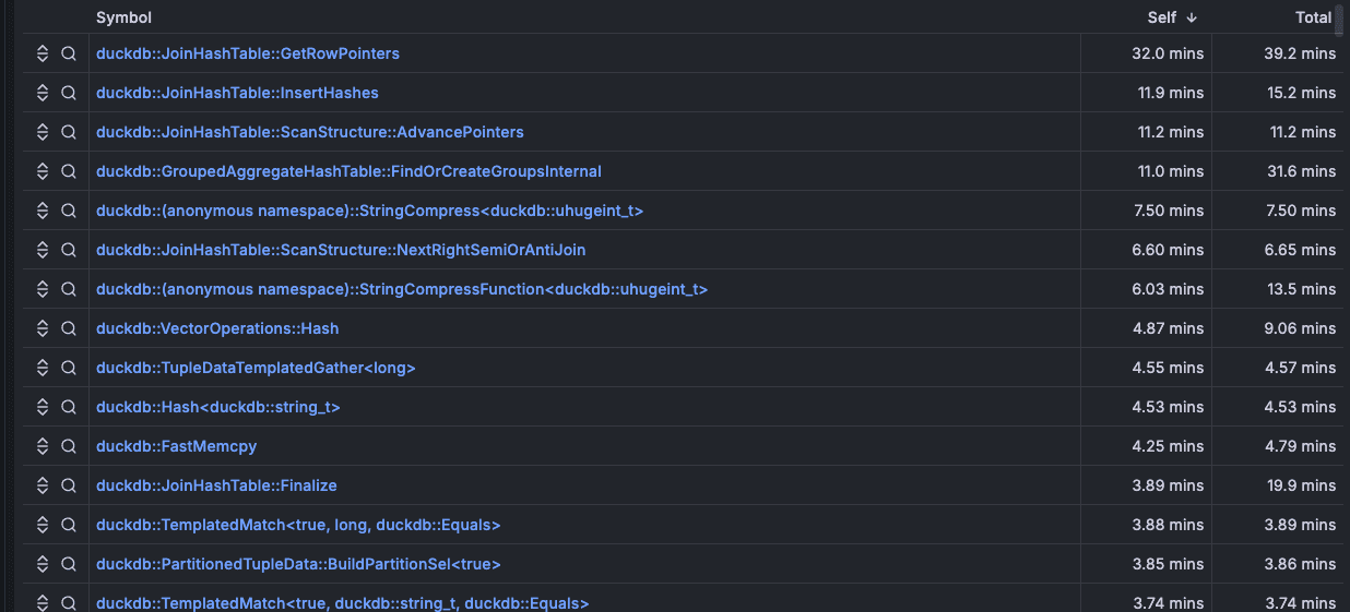

Thanks to stack walking and demangling, we see a clear list of functions that use the most CPU in our scenario. If we were to attempt to optimize the runtime of the TPC-H benchmark in DuckDB, our first candidates for optimization would be:
  • duckdb::JoinHashTable::GetRowPointers
  • duckdb::JoinHashTable::InsertHashes
  • duckdb::JoinHashTable::ScanStructure::AdvancePointers
  • duckdb::GroupedAggregateHashTable::FindOrCreateGroupsInternal
  • duckdb::(anonymous namespace)::StringCompress<duckdb::uhugeint_t>
