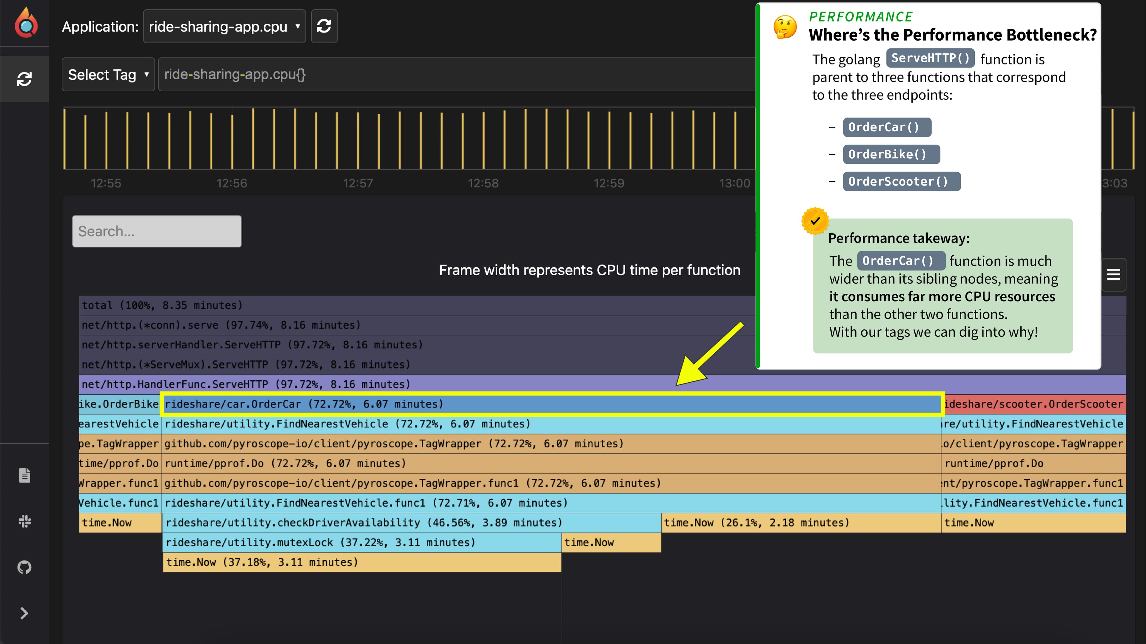

Where’s the performance bottleneck?
Performance bottleneck pointed out in Pyroscope
The first step when analyzing a profile outputted from your application, is to take note of the largest node which is where your application is spending the most resources. In this case, it happens to be the OrderCar function.
The benefit of using the Pyroscope package, is that now that we can investigate further as to why the OrderCar() function is problematic. Tagging both region and vehicle allows us to test two good hypotheses:
  • Something is wrong with the /car endpoint code
  • Something is wrong with one of our regions

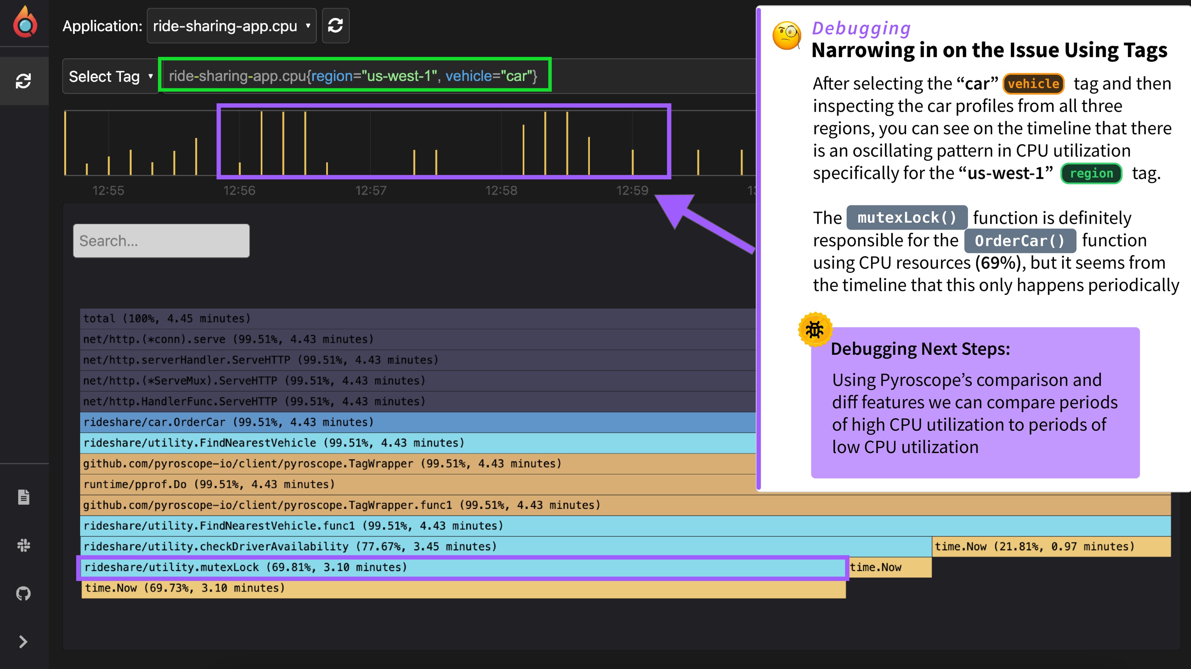

Narrowing in on the issue using tags
Knowing there is an issue with the OrderCar() function we automatically select that tag. Then, after inspecting multiple region tags, it becomes clear by looking at the timeline that there is an issue with the us-west-1 region, where it alternates between high-cpu times and low-cpu times.
We can also see that the mutexLock() function is consuming almost 70% of CPU resources during this time period.
Narrowing in on the issue using tags in Pyroscope

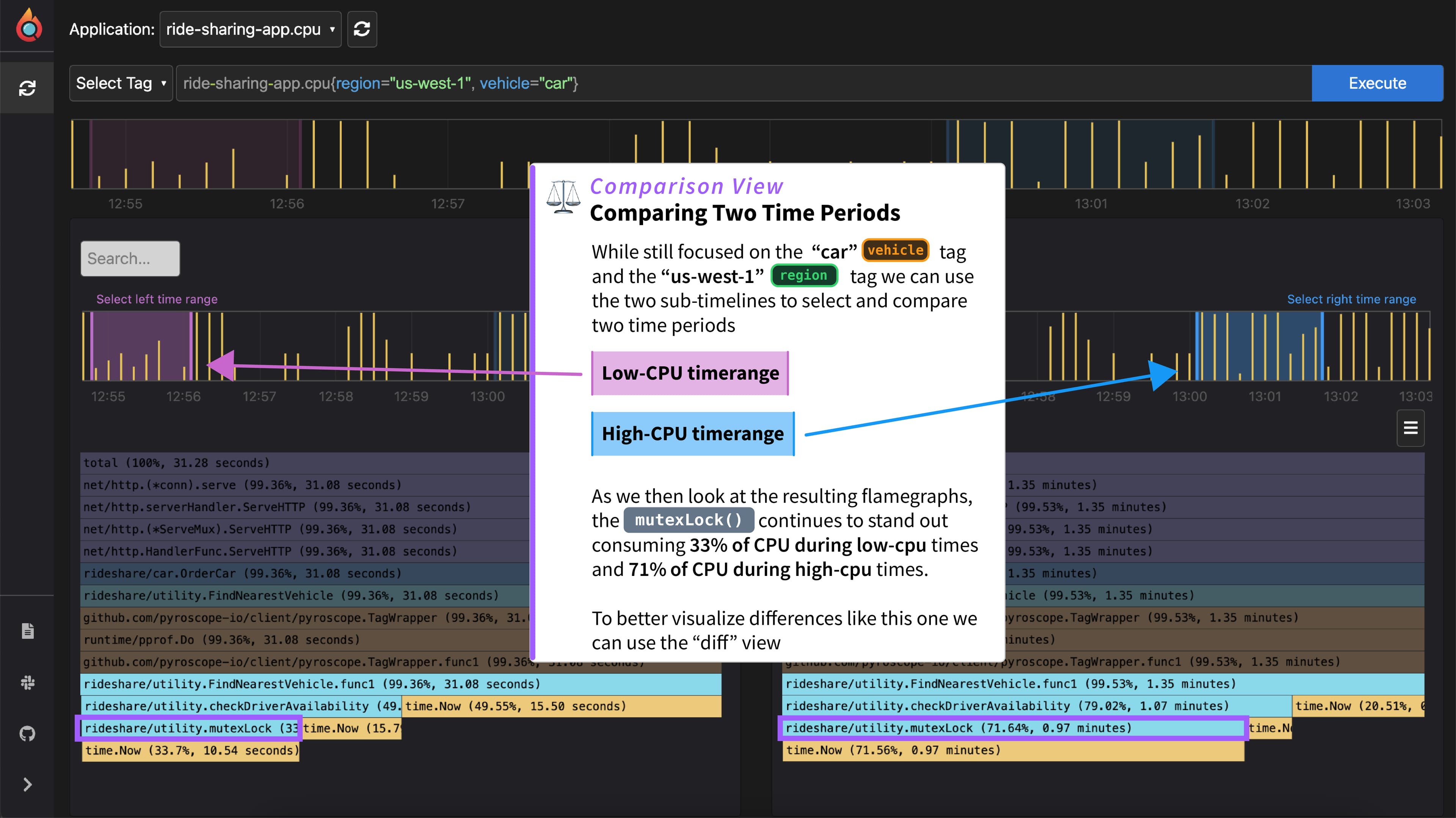

Comparing two time periods
Using Pyroscope’s “comparison view” we can actually select two different time ranges from the timeline to compare the resulting flame graphs. The pink section on the left timeline results in the left flame graph, and the blue section on the right represents the right flame graph.
When we select a period of low-CPU utilization and a period of high-CPU utilization we can see that there is clearly different behavior in the mutexLock() function where it takes 33% of CPU during low-CPU times and 71% of CPU during high-CPU times.
