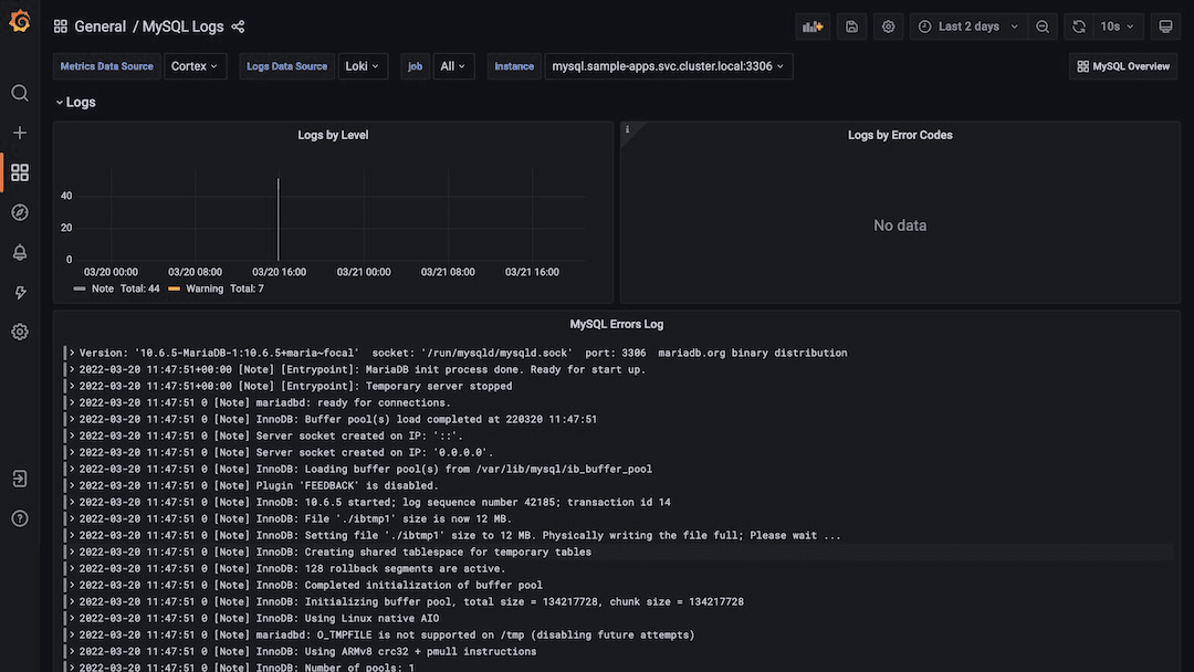

Start monitoring with the MySQL logs dashboard
Embedded image
Along with coming packaged with pre-built dashboards as well as metrics and alerts, the MySQL integration for Grafana Cloud now bundles a new MySQL logs dashboard that can be quickly accessed from the MySQL overview dashboard when you need a deeper understanding of what’s going on with your MySQL server:
The important thing to note is that if you jump from one dashboard to another, the context of the MySQL instance and time interval will remain the same.
