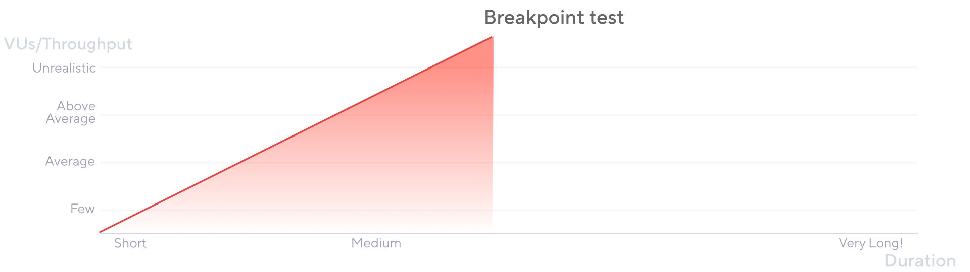

A breakpoint ramps to unrealistically high numbers. This test commonly has to be stopped manually or automatically as thresholds start to fail. When these problems appear, the system has reached its limits.
Chart showing breakpoint testing VUs and duration in Grafana k6

The breakpoint test is straightforward. The load slowly ramps up to a considerably high level. It has no plateau, ramp-down, or other steps. And it generally fails before reaching the indicated point.
k6 offers two ways to increase the activity: increasing VUs or increasing throughput (open and closed models). Different from other load test types, which should be stopped when the system degrades to a certain point, breakpoint load increases even as the system starts to degrade. That makes it recommendable to use ramping-arrival-rate for a breakpoint test.
The test keeps increasing load or VUs until it reaches the defined breaking point or system limits, at which point the test stops or is aborted.
