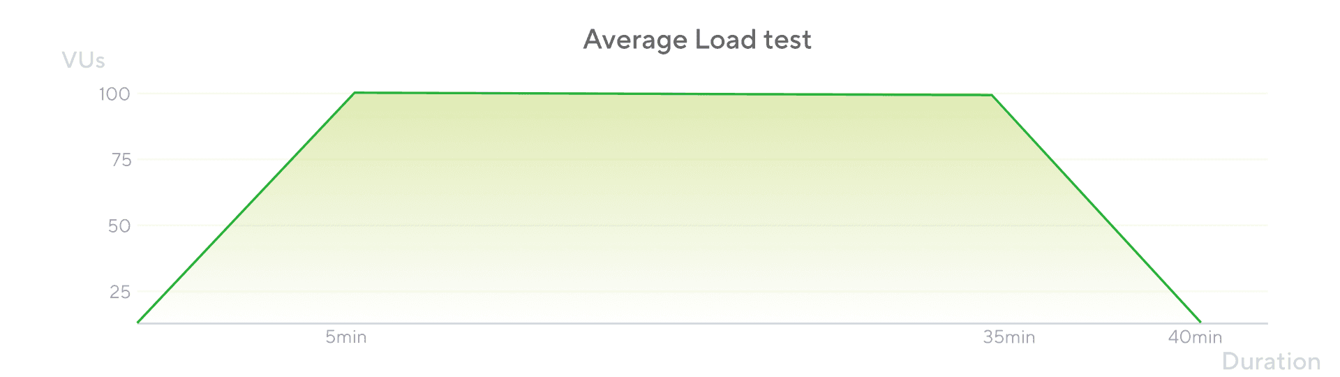

The goal of an average-load test is to simulate the average amount of activity on a typical day in production. The pattern follows this sequence:
  1. Increase the script’s activity until it reaches the desired number of users and throughput.
  2. Maintain that load for a while
  3. Depending on the test case, stop the test or let it ramp down gradually.

	stages: [
		{ duration: "5m", target: 100 }, // traffic ramp-up from 1 to 100 users over 5 minutes.
		{ duration: "30m", target: 100 }, // stay at 100 users for 30 minutes
		{ duration: "5m", target: 0 }, // ramp-down to 0 users

The virtual users (VU) or throughput chart of an average-load test looks similar to this:
Chart showing an example of an average-load test using Grafana k6
