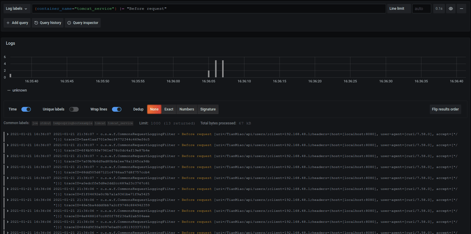

After I rebuilt the war file with maven, the following log lines began appearing in Loki:

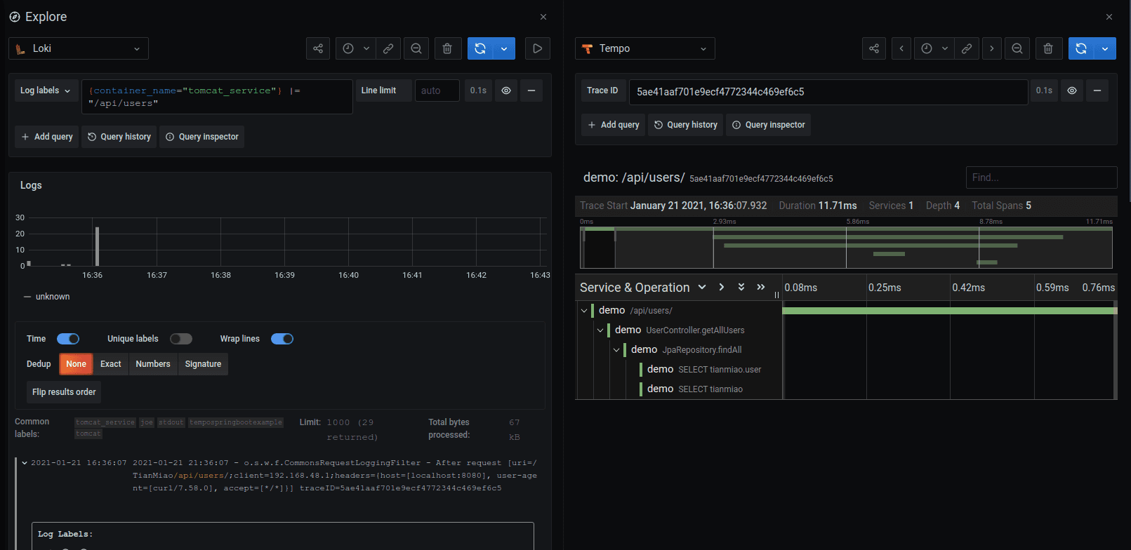

Now that we have our logs in Loki and our traces in Tempo, we can easily search for traces and then jump directly to them via a handy link in Grafana:

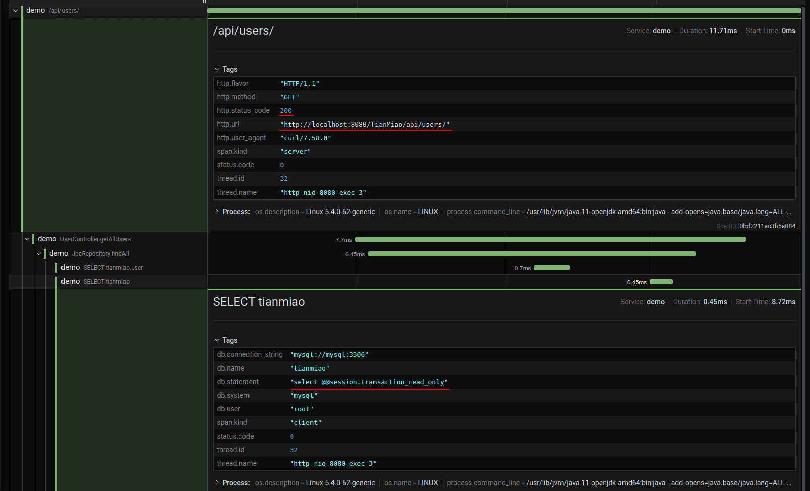

Looking closer at the trace, we can see valuable information such as the path requested and the query executed. Nice work, OTel Java folks!
