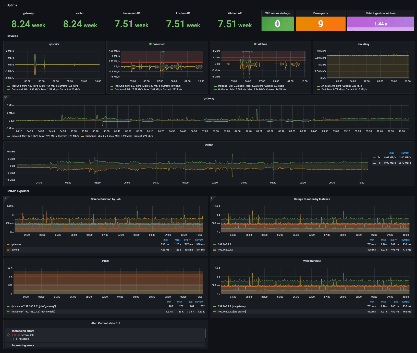

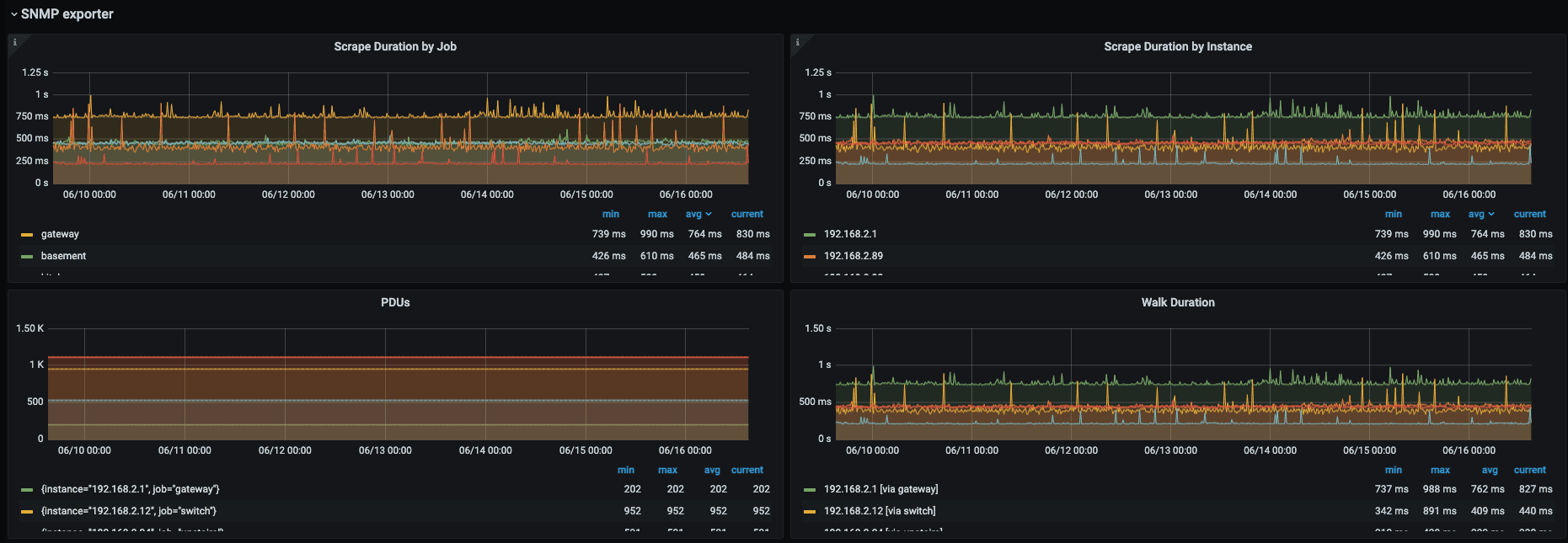

Finally, here is a Grafana dashboard example that was created with data collected from the snmp_exporter on some home devices:
Embedded imageEmbedded image
