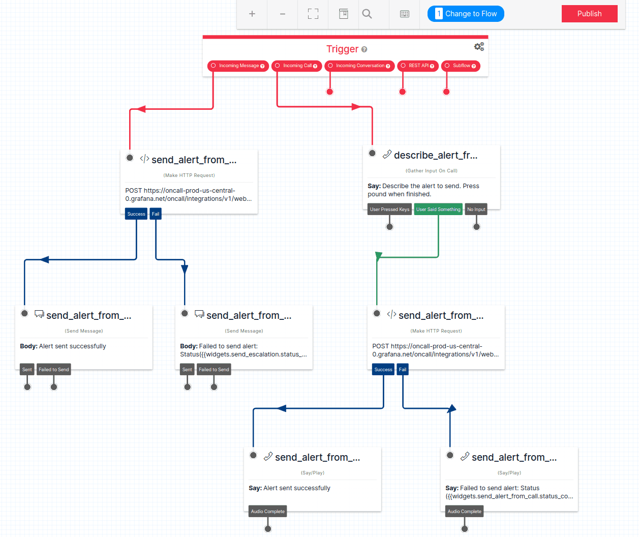

We will set up a Studio flow to handle SMS messages and handle phone calls. The goal of each is to capture alert information and send it to Grafana OnCall in a format that we can make use of.
- On the “Develop” tab, navigate to Studio -> Flows. (If you do not see “Studio,” select Explore Products and select Studio under the “Developer Tools” section. Also, pin it for easier access later.)
- On the Studio -> Flows page select Create new Flow.
- Enter a flow name and press Next.
- Select “Import from JSON”’ and press Next.
- Paste the following JSON into the dialog and replace
<YOUR_INTEGRATION_URL>at Lines 54 and 156 with the URL of the webhook integration we created earlier in Grafana OnCall. Then press Next. - After importing you should see something like this:
This flow has two paths. The first path accepts the SMS message and forwards its contents to Grafana OnCall on the webhook integration we created. The content of the message will be passed as the message field along with the phone number the message was sent from. When the request is made to Grafana OnCall, whether it succeeds or fails, it will be communicated back to the sender.
The voice call path is similar — the caller describes the alert and it will be converted to text and sent to the integration in Grafana OnCall.
- Now press Publish to make the flow available to be connected to a phone number.

Testing and troubleshooting
First we will test our setup by sending an alert from an SMS message.
- Using your mobile phone, send an SMS message to the phone number we purchased in Twilio.
- You should get a response message of “Alert sent successfully.”
- Shortly after that you should receive a notification from Grafana OnCall by whichever method you configured for your user.
- If you did not receive the “Alert sent successfully” message, you should have a message with a status code. Check to make sure you have the correct URL configured in your flow.
- Check that “A message comes in” is configured correctly for the phone number.
- In Studio -> Flows in the right side menu for your flow, you can view “Execution Logs to troubleshoot.”
- If you haven’t been notified in Grafana OnCall, check the alert groups to see if one was created. From the alert group you can view the escalation log to see what happened.
Next, test sending an alert by calling.
- Using your phone to call the number we purchased in Twilio
- You should hear instructions to describe your alert and press #.
- Next you should hear a message that the alert was sent successfully.
For troubleshooting, follow the same steps outlined in the previous section.

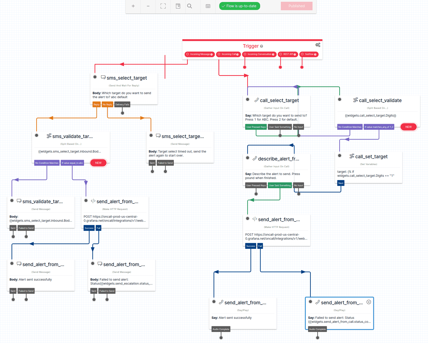

Adding routes
In this section we will set up a list of options so we can select which route we want to send an alert to and route it appropriately in Grafana OnCall. To accomplish this in Grafana OnCall we will set up another route and escalation chain and attach them both to the integration. Then we will expand the Studio flow in Twilio to present the option to the caller. This setup can be easily expanded upon to handle more routes.

Adding another Studio flow
Here we need to set up a more complex Studio flow than the one we had in the “Basic setup” section.
- In the “Develop” tab, navigate to Studio -> Flows. (If you do not see Studio select Explore Products and select Studio under “Developer Tools” section; Also, pin it for easier access later.)
- Select “Import from JSON” and press Next.
Here we have added steps that prompt the user to decide which target they want to send the alert to as well as validation steps to ensure the values are correct.
