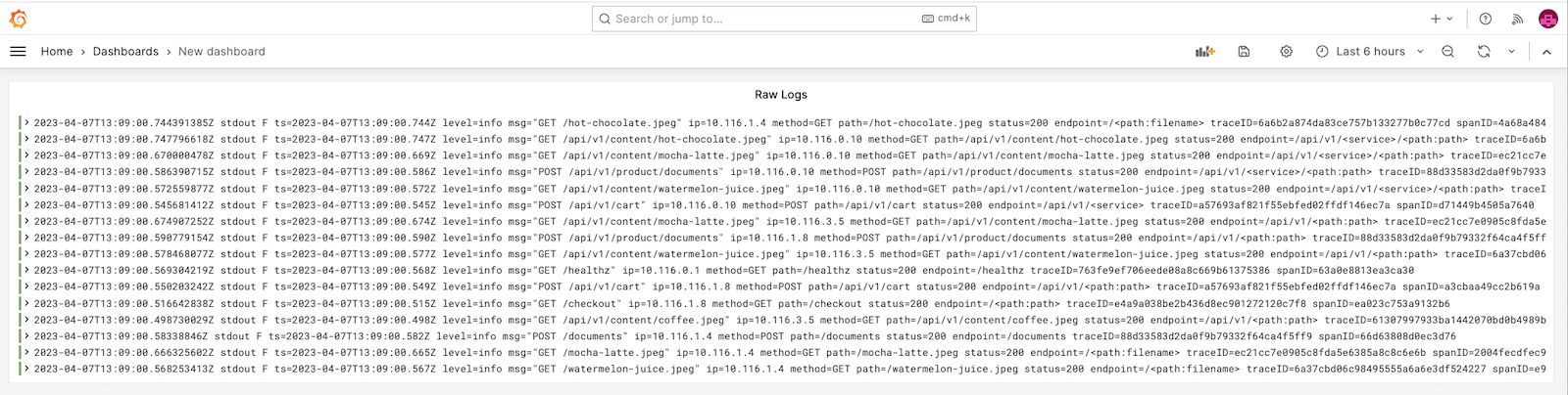

Get started with your first log panel
In this example, you’re going to start with a single log stream, perhaps one that has helped you solve an issue successfully. Don’t worry about parameterizing it yet — it’s totally fine to start from hard-coded labels and think about adding variables to the setup later. For now, let’s just use a logs panel with a super simple query that basically does nothing else but select the log streams concerning an “ecommerce” app in a “cloud” cluster.
  • Panel Name: Raw Logs
  • Query: {app=“ecommerce”, cluster=“cloud”}
  • Visualization Type: Logs
What you’ll get back will look something like this:
A screenshot of a window with a list of raw logs.
It’s pretty cool, but it won’t get you far if you’re trying to find specific log lines. You want to be able to filter it.

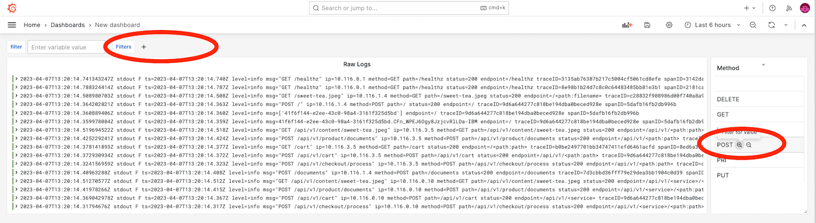

1. Add a text box variable to apply a line filter
A line filter in Loki is a very small but powerful change. It allows you to search for random strings across all logs.
Give the text box variable a generic name like “filter” and add it to the dashboard (top red circle in the screenshot below). Modify the existing panel to cater for the new filter variable (bottom red circle).
  • Query: {app=“ecommerce”, cluster=“cloud”}  |= `$filter`
A screenshot of a window with the places to enter the variable value and label filters highlighted.
2. Add a label filter and a corresponding drop-down menu

3. Add an ad hoc filter table
While label filters are easy to implement, they only work for labels, not for the actual content of the log message. Also, it’s not a good idea to transform parts of the log message into labels, because that would kill Loki’s performance. If you wanted a quick and easy way to filter key/value pairs appearing in your log messages, you could use so-called ad hoc filters.
To do that, duplicate the Raw Logs panel. That will preserve the data source and the query.
If you want to filter for a specific request method, follow this example:
  • Panel Name: Ad Hoc Filter Table
  • Query: sum by(method) (count_over_time({app=“ecommerce”} |= `$filter\</span> | <span style=“color:blue”>logfmt</span> | <span style=“color:green”>__error__</span>= <span style=“color:red”>`` </span>[`$__range])))
  • Query Type: Instant
  • Visualization Type: Table
A screenshot of a window with circles highlighting the plus sign to add filters and a magnifying glass.
Note the logfmt statement to parse the log lines in “log format”. (Another popular format that is supported by Loki’s LogQL, among others, is json.)
The __error__=~`` statement will simply filter out all log lines that cannot be parsed using the logfmt parser. This parses the log message into key-value pairs, so you can now use the field “method” to group and aggregate by it (sum by). As a result, this gives you the capability to filter for logs by “method” by just clicking on the magnifying glass (circled above on the right) next to the method you want to filter for. You can see all currently active ad hoc filters in the left upper variable area of Grafana (circled above on the left) and also revoke them from there.
Meanwhile, the $__range selector will do the aggregation over the time window in the right upper corner of Grafana (“Last 6 hours” in the screenshot above). As a result, it’s essential to use the Instant query type, since you want to do this type of aggregation only once for the current point in time and not for each interval over the time chosen frame. Misusing the Range query type for such panels will not perform very well and makes the query unnecessarily slow. As a best practice, it’s even better for the performance to create a recording rule for this use case to store this information as a metric and do metric queries to your Prometheus data source in this panel.
For this ad hoc filter to work you need to make sure you also parse the raw logs, so modify your first panel:
  • Query: {app=“ecommerce”, cluster=“cloud”} |= `$filter` | logfmt | __error__``

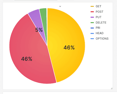

4. Add a pie chart
A pie chart gives you a great visual representation of the general distribution of certain features of your logs in the chosen time range.
To get started, duplicate the Ad Hoc Filter Table. That will preserve all the configurations and queries you’ve already done and it requires only minimal changes to the following:
  • Panel Name: Method Distribution
  • Visualization Type → Visualization Suggestion: Pie Chart
A screenshot of a pie chart showing different colored percentage areas.
This beautiful and informative pie chart makes it easy to comprehend the relative distribution of HTTP methods across all log lines.
