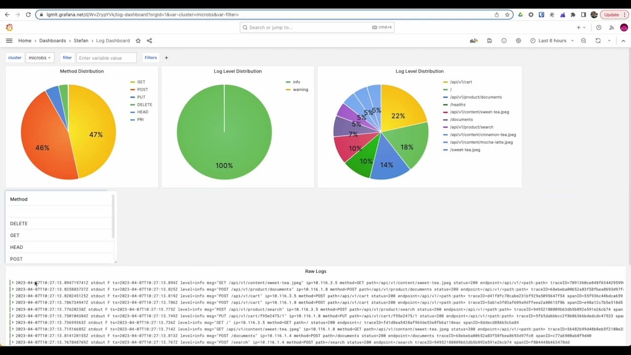

At this point, you should have a log dashboard that looks something like this:
Data links are a great way of using the results of an existing panel query in a hyperlink and can be powerful additions to the existing capabilities of Grafana to correlate all kinds of metrics, logs, and traces.
Data links provide you with the ability to enrich an arbitrary URL with (meta) data of the query result. This can be used to trigger interactive changes in the current dashboard and drill down to specific components in other dashboards in the same or external Grafana and non-Grafana instances.
A very simple use case would be if you set one of the template variables in your dashboard based on the piece of data you clicked on. To achieve that, you would edit the panel, go to Data Links, click Add Data Link, and add a string that looks something like this:
/d/WvZrypYVk/log-dashboard?orgId=1&var-cluster=microbs&var-filter=${__data.fields.path}
You can copy and paste the first part (/d/WvZrypYVk/log-dashboard?orgId=1) from your current browser window because you’ll be linking it to the same dashboard. It contains the unique dashboard I.D. as well as the dashboard name.
The next part sets the value for our “cluster” variable that we added earlier: &var-cluster=microbs
The last piece is where it becomes interesting. We’re using a variable to refer to the data we actually clicked on: &var-filter=${__data.fields.path} You don’t need to learn how to construct this variable — by just typing “$” in the data link input field, you’ll see a list of available variables for the corresponding query result.
In another interesting use case, data links refer to the Explore view with a pre-configured query. That means you can use a piece (or multiple pieces) of data from your dashboard and inject it into a query of the same or different data source in Explore mode. It allows you to easily correlate data from logs with data from traces or business data. At the same time, it gives you a great start on doing more flexible ad hoc querying from the Explore mode to combine the best of both worlds: dashboards and the Explore UI. Just modify the link accordingly, or start by copying/pasting an example query URL that you’ve performed in the Explore view already.
