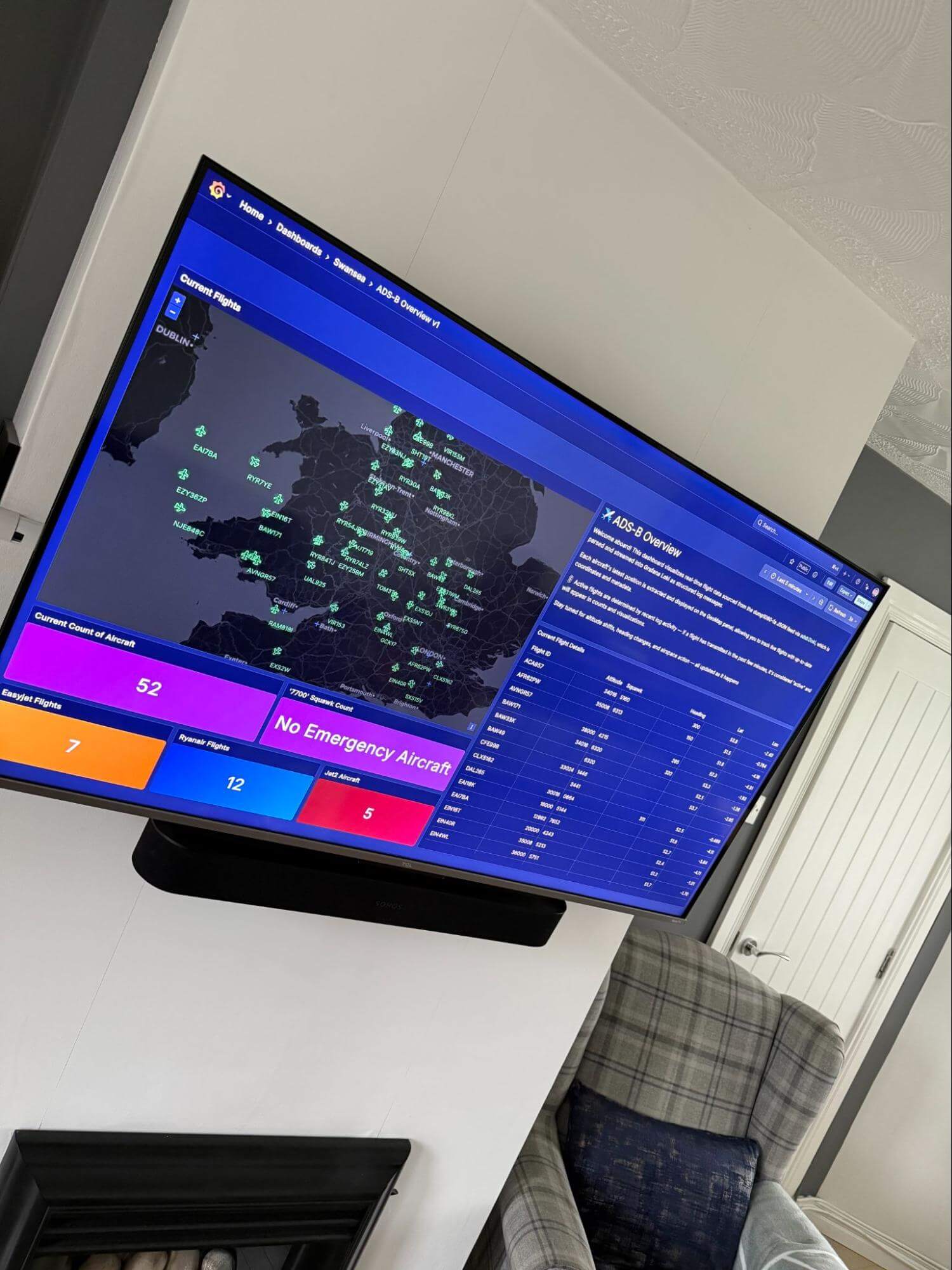

Plane tracking dashboard displayed on a TV minitor over a fireplace
As a Senior Solutions Architect on the Professional Services team at Grafana Labs, I spend my time helping people visualize all kinds of interesting data. So one evening I decided to use those skills to take on a personal project: building a Grafana dashboard that could show nearby aircraft in real time, powered by data from my ADS-B receiver and ingested into Grafana Cloud Logs. Let’s dive into how I did it.

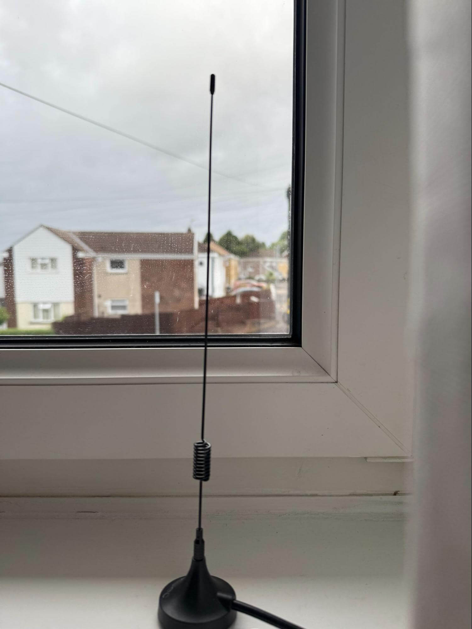

  • Antenna. You’d need an SDR Antenna that can support the 1090MHz frequency to receive ADS-B data. I have a Nooelec Indoor Aerial similar to this.

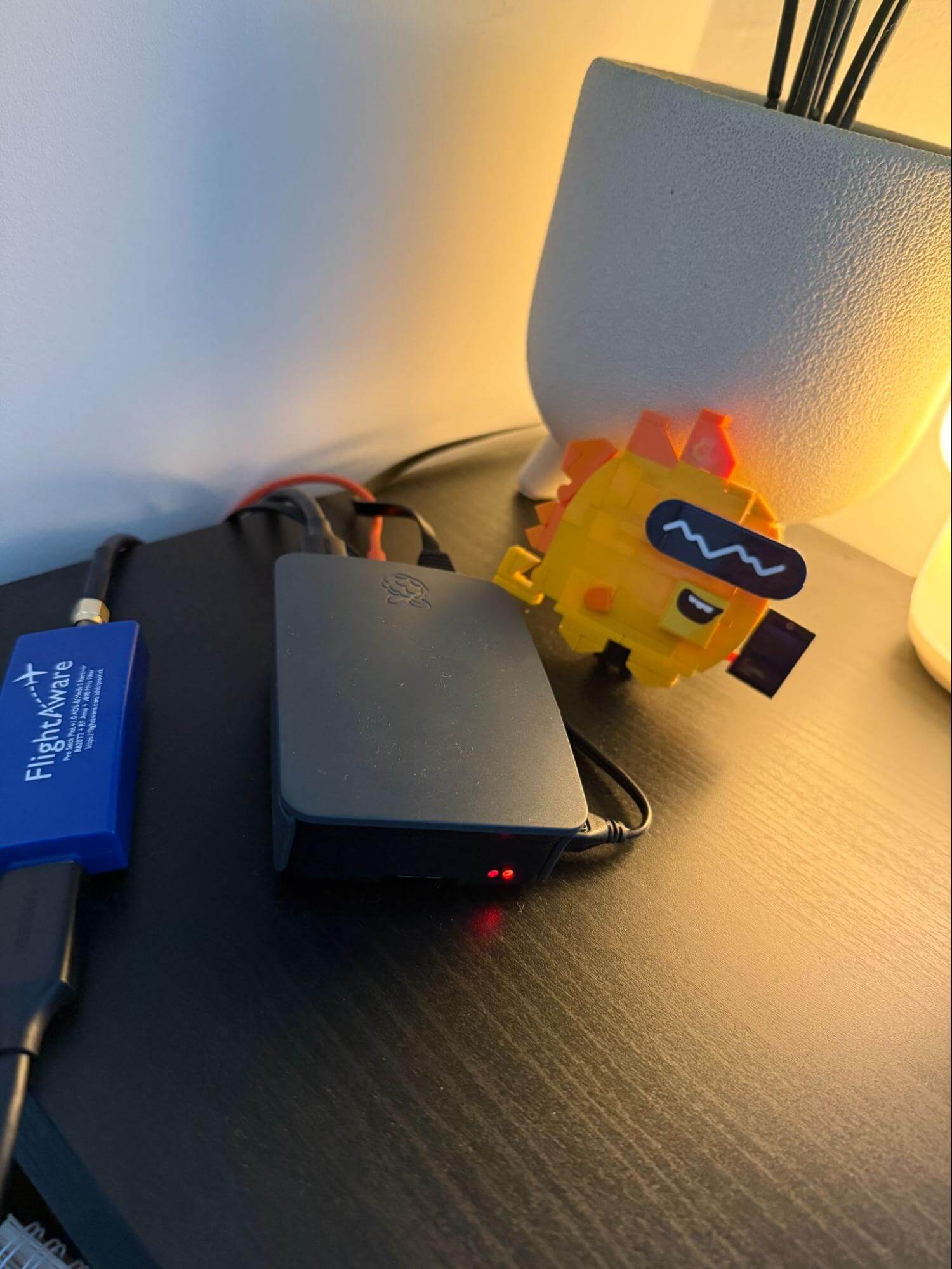

Raspberry Pi with Flightaware USB SDR
The adsb.im image on my Raspberry Pi provides a lot of cool features, such as being able to “feed” data to many different flight tracking providers. Conveniently, it also exposes a JSON endpoint that provides all nearby aircraft, which is the basis of this entire project. That gave me the perfect entry point to build a small Go script (aptly named adsb2loki) that retrieves this data every five seconds and ships it to Grafana Cloud Logs.
Aerial connected to Flightaware USB SDR

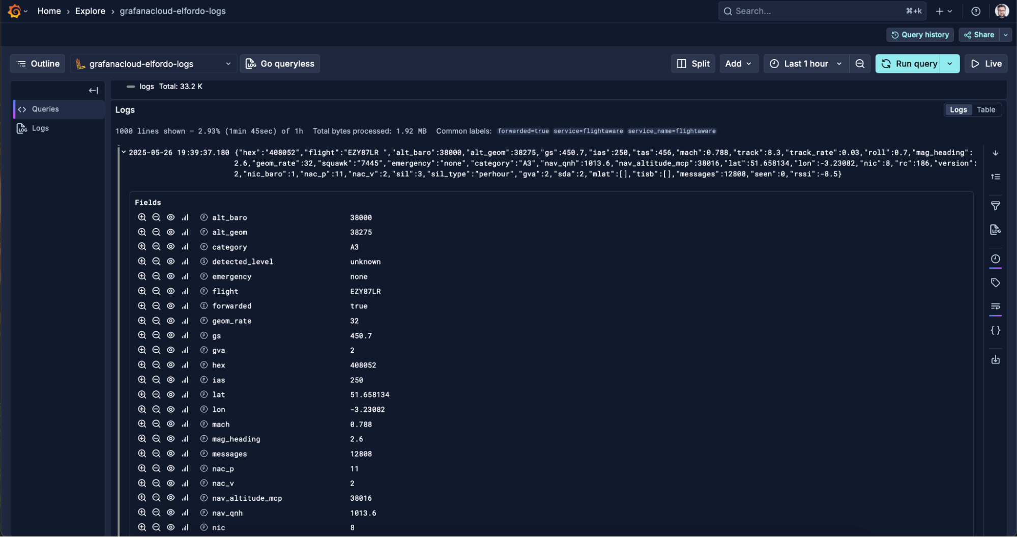

The result? Every five seconds, fresh aircraft positioning data is streamed into Grafana Cloud, ready to be queried, visualized, and explored.
Logs displayed in Grafana Cloud Logs

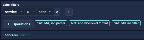

If you’re using adsb2loki, your query should look something like this:
Label filter in the Grafana Cloud UI
{service=”adsb}
However, if you’re using another way of getting the data into Grafana Cloud Logs, you’ll need to set the label filter accordingly.

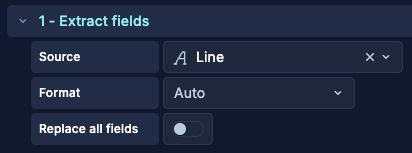

Extract the fields
Apply the “Extract fields” transformation, setting the source as “Line.” This will extract all the different fields in the log line and allow you to use them in later transformations.
Extract fields menu

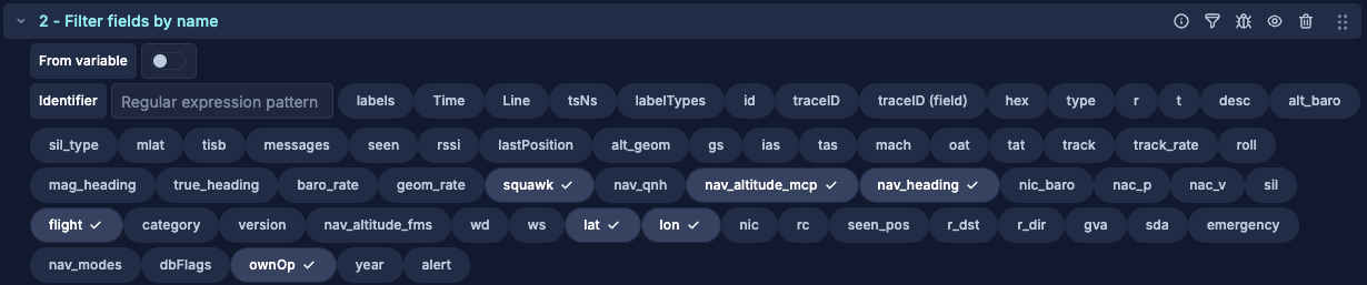

Filter out the fields you don’t need
By default there are a lot of fields in the aircraft data payloads that are unnecessary for our visualization. Therefore, the second transformation should be “Filter fields by name,” and choosing what you need. For the purposes of this project, I only have the following selected:
  • Squawk
  • Nav_altitude_mcp
  • Flight
  • Lat
  • Lon
  • Nav_heading
  • ownOp
Filter fields by name menu

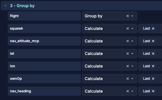

Setting the ‘Group by’
Finally, I only want to expose the last data point on the Geomap so that all aircraft have only one position on the map (the latest one uploaded).
Apply the “Group by” transformation, and then set the “flight” field to “Group by” and the other fields to “Calculate” and “Last.” This ensures that only the last log entry will be considered for visualization.
Group by menu

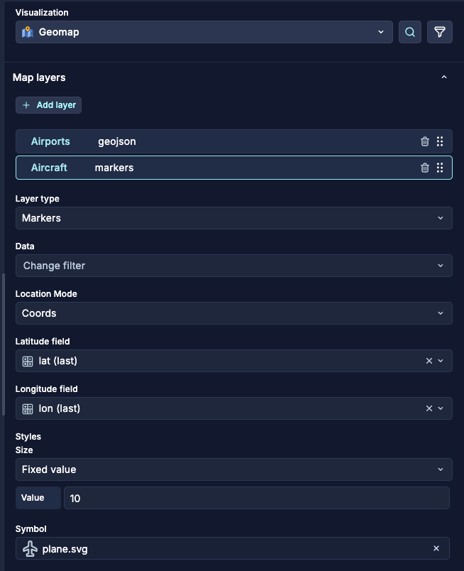

Apply the map layer configuration
Next, configure the “Map layer” settings in the geomap panel. Set the “Location Mode” to “Coords” and map your latitude and longitude fields to the appropriate data columns. Under “Style,” you can customize the marker appearance, choose markers (naturally, you’d want the plane one), adjust size based on altitude, or use different colors to represent aircraft types or speeds.
Geomap menu
For real-time updates, enable the “dashboard auto-refresh interval” and set it to match your data ingestion frequency (in this case, every five seconds). This ensures that as new aircraft data arrives, the map automatically updates to show the latest positions overhead.

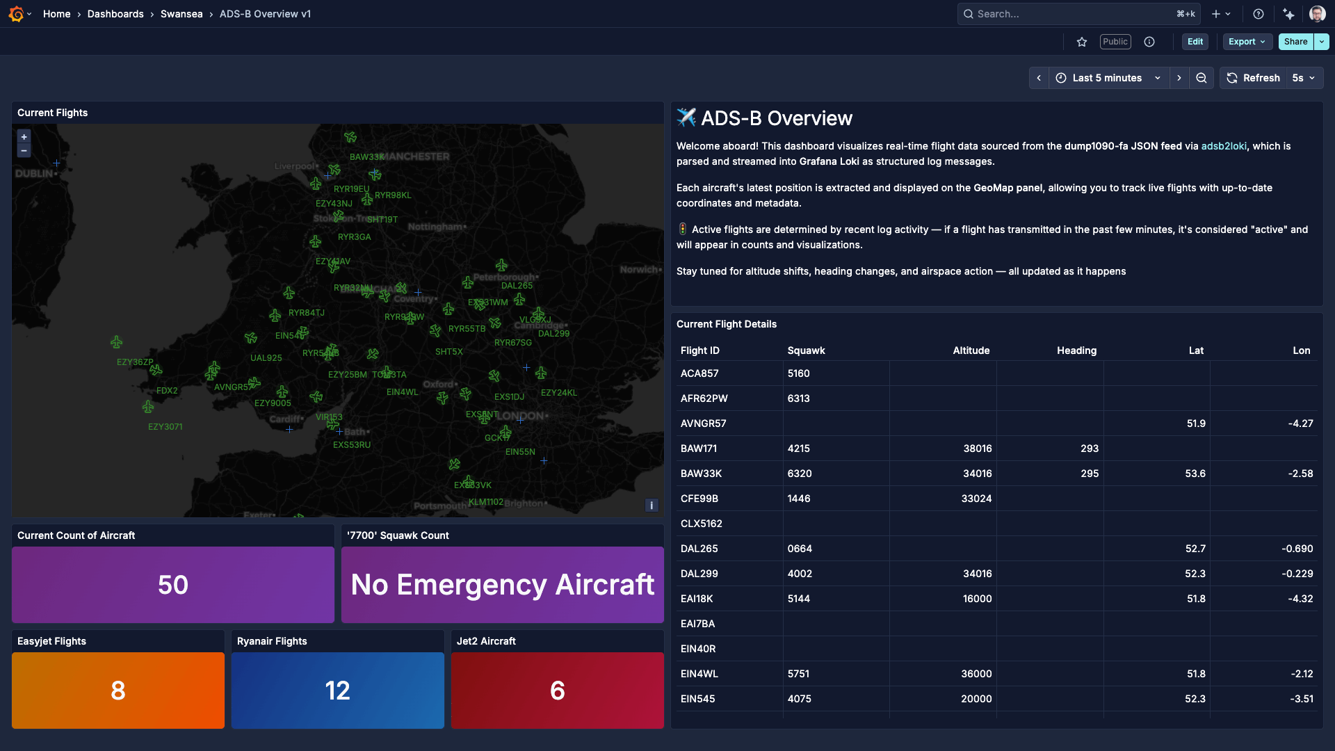

The result is a dynamic, real-time map displaying the aircraft your receiver can see along with their flight paths and details all rendered directly within Grafana’s familiar interface.
I will say that there seems to be something quite therapeutic about watching it refresh and having it on in the background while I get on with work. If you want to try it out yourself, visit my live dashboard here.
A dashboard visualizing plan locations across the UK, as well as other data
Bonus: If you want to take it a step further, Grafana has the ability to plot out airports on the map, too. Simply add another layer in “Map layers,” set the layer type to “GeoJSON” and set the URL to “public/gazetteer/airports.geojson”.
