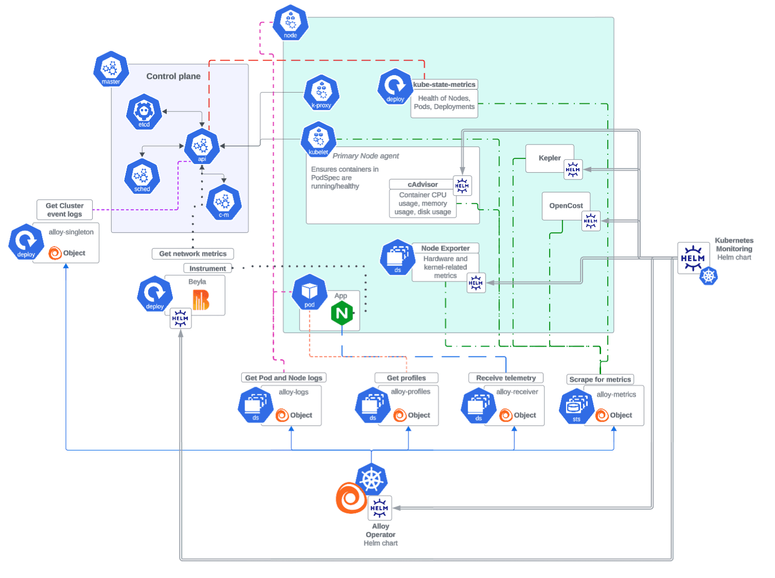

Alloy Operator is a Helm-based, small-footprint operator created using the Operator SDK. Instead of requiring an Alloy instance and a Helm chart, Alloy Operator acts on kind: Alloy objects. When an Alloy object is deployed to the cluster by the Kubernetes Monitoring Helm chart, the Alloy Operator:
  1. Creates the components needed by the object (such as file system access, permissions, or the capability to read secrets)
  2. Performs a Helm install of the Alloy object and its components
To view what’s been installed, you can use the Helm list command. This diagram shows all available Alloy objects installed as of 3.0.
Embedded image
Helm chart 3.0: same best practices as before
Helm chart 3.0 follows the same best practices as previous versions, and ensures encapsulation to maintain modularity and security. That means each object, whether Alloy, Node Exporter, or cAdvisor, is restricted to the permissions required for it to perform its function.
