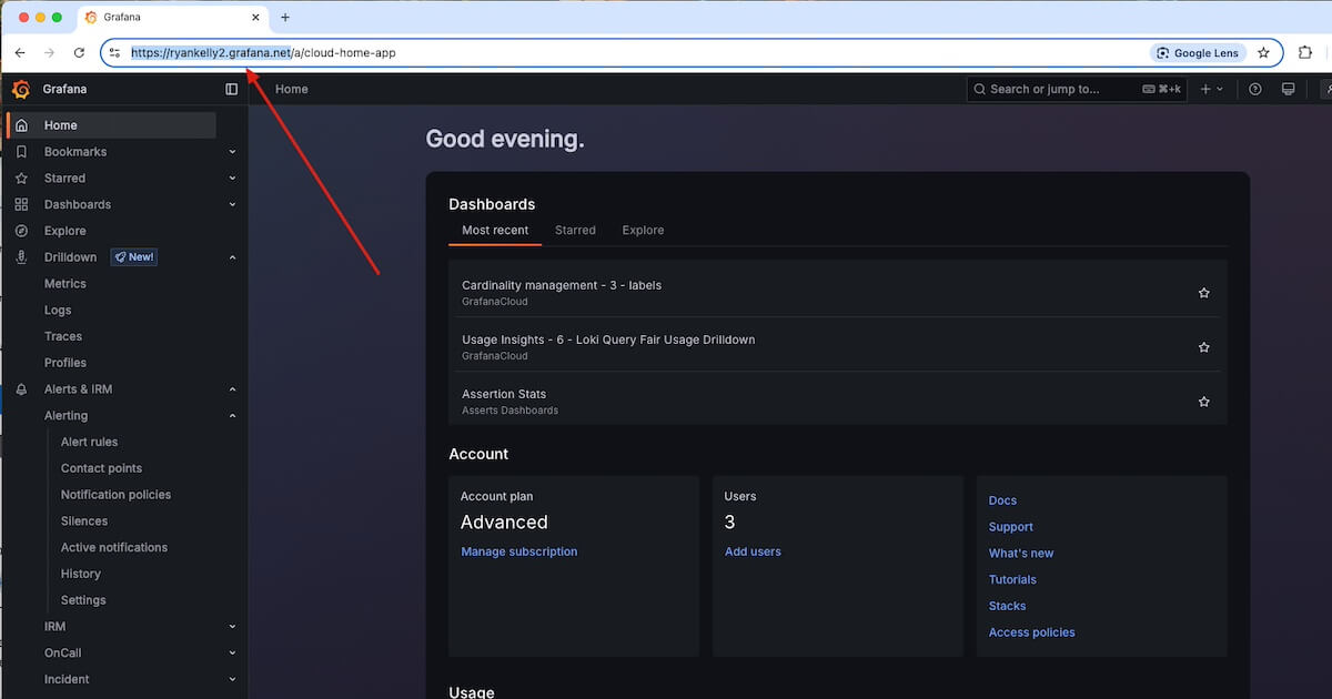

Note the URL name belonging to your Grafana Cloud stack — mine is https://ryankelly2.grafana.net. You will use yours to configure the client application in Keycloak or your idP.
A screenshot of a Grafana Cloud homepage

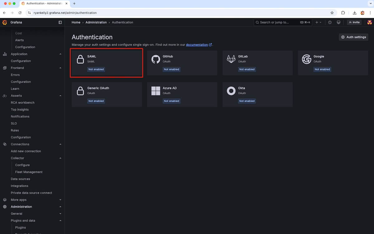

Once you’re in go to Administration > Authentication > then select SAML.
A screenshot of a Grafana Cloud Authentication page with the SAML option highlighted

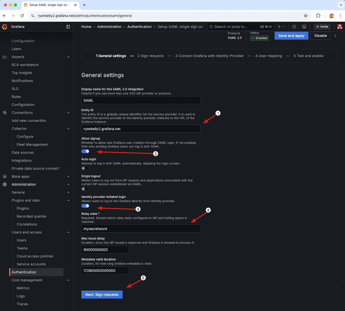

In the next window you see (screenshot below), you will need to:
  1. Make the Entity ID your stack name, minus the http://. (This is so it is less confusing for your SAML admin if you have multiple Grafana stacks.)
  2. Toggle to allow signup.
  3. Toggle to allow the idP initiated login.
  4. In the Relay state box, type a word of your choosing — I’m using mysecretword as an example — with a trailing space. (This can be any string less than 80 bytes long. It will make sure Grafana Cloud and the idP agree this is a valid login. Be sure to have this word handy when you configure the idP.)
  5. Before you click Next, go to the next step in this blog post to configure your idP. (Don’t worry if you’ve already moved on — you can always go back.)
A screenshot of Grafana Cloud general settings with arrows pointing to toggles and boxes where text should be entered

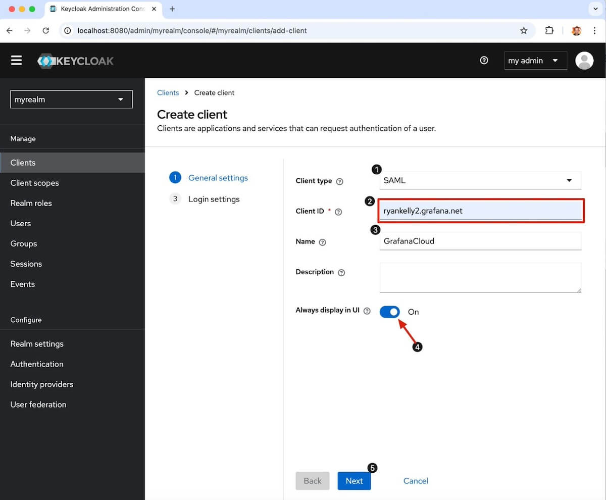

Log in to your identity provider and create the client by following what I did in the screenshot below.
A screenshot of a the Create client window in Keycloak

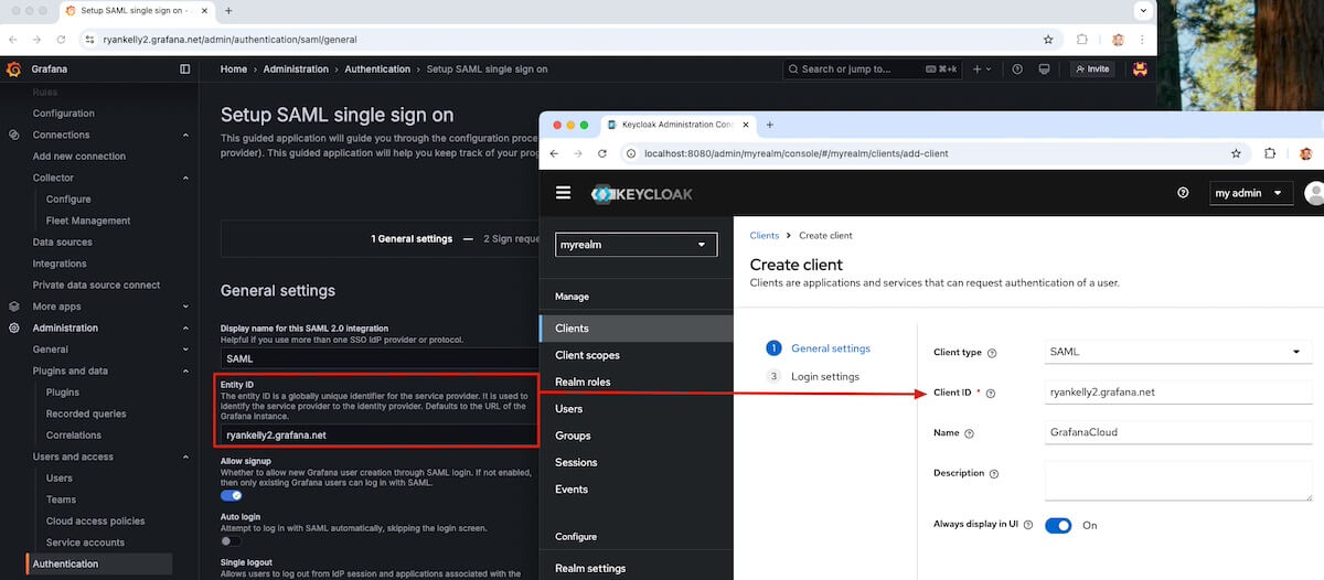

  1. Client type: SAML
  2. Client ID: the Entity ID from Grafana Cloud you set earlier
  3. Name: GrafanaCloud (or whatever name you want users to see in their Login Portal)
  4. Always display in UI: toggle On
  5. Click Next.
Note: Your Entity ID and Client ID must match or SAML login will fail.
A screenshot of an Entity ID in Grafana Cloud and a matching Client ID in Keycloak

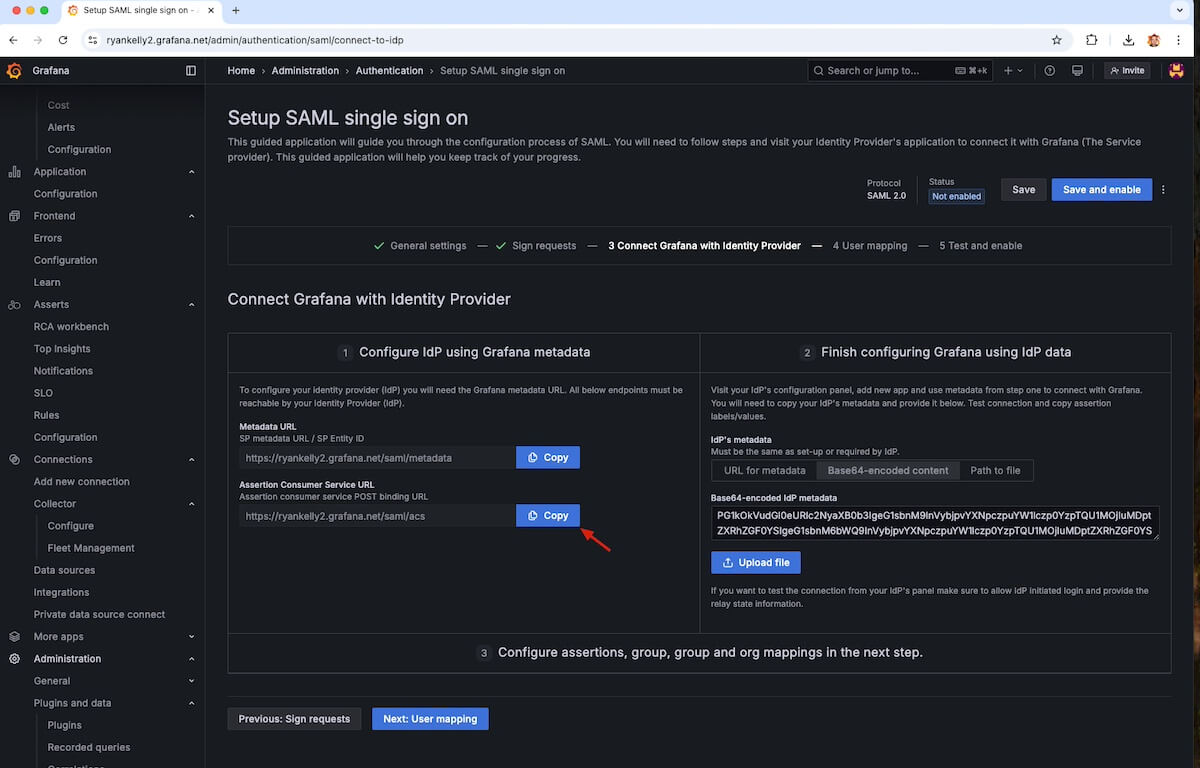

Now, go back to Grafana Cloud and click Next to go to Sign requests. I am not covering signing requests in this guide, so you can just click Next: Connect Grafana with Identity Provider.
A screenshot of the Setup SAML single sign on window in Grafana Cloud with an arrow pointing to the Next button

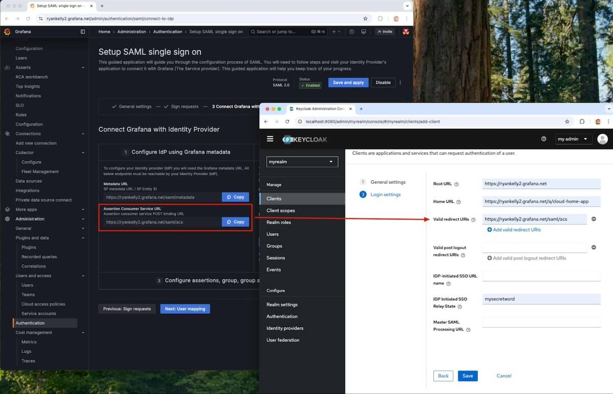

Copy the Assertion Consumer Service URL to your clipboard for the next step in your idP.
A screenshot with an arrow pointing to the Copy button in the Configure idP using Grafana metadata window

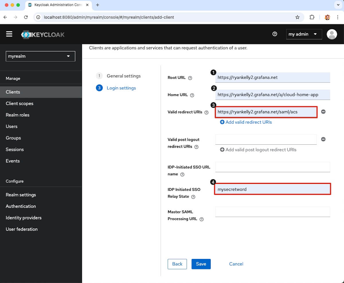

Back in the idP, configure the Login settings.
A screenshot of login settings in Keycloak
  1. Root URL: Your Grafana Cloud Stack URL
  2. Home URL: Your Grafana Cloud Stack home URL
  3. Valid redirect URIs: Paste the Grafana Cloud stack redirect URL you copied earlier
  4. idP Initiated SSO Relay State: mysecretword (i.e. whatever you created earlier in Grafana Cloud)
Before you click Save, make sure you confirm what you have pasted into the boxes in steps 3 and 4 above or the SAML login will fail.
In your Grafana Cloud window, the Assertion Consumer Service URL should be the same as the Valid redirect URIs.
A screenshot highlighting the Assertion Consumer Service URL copy button in Grafana Cloud window and the Valid redirect URIs box in Keycloak

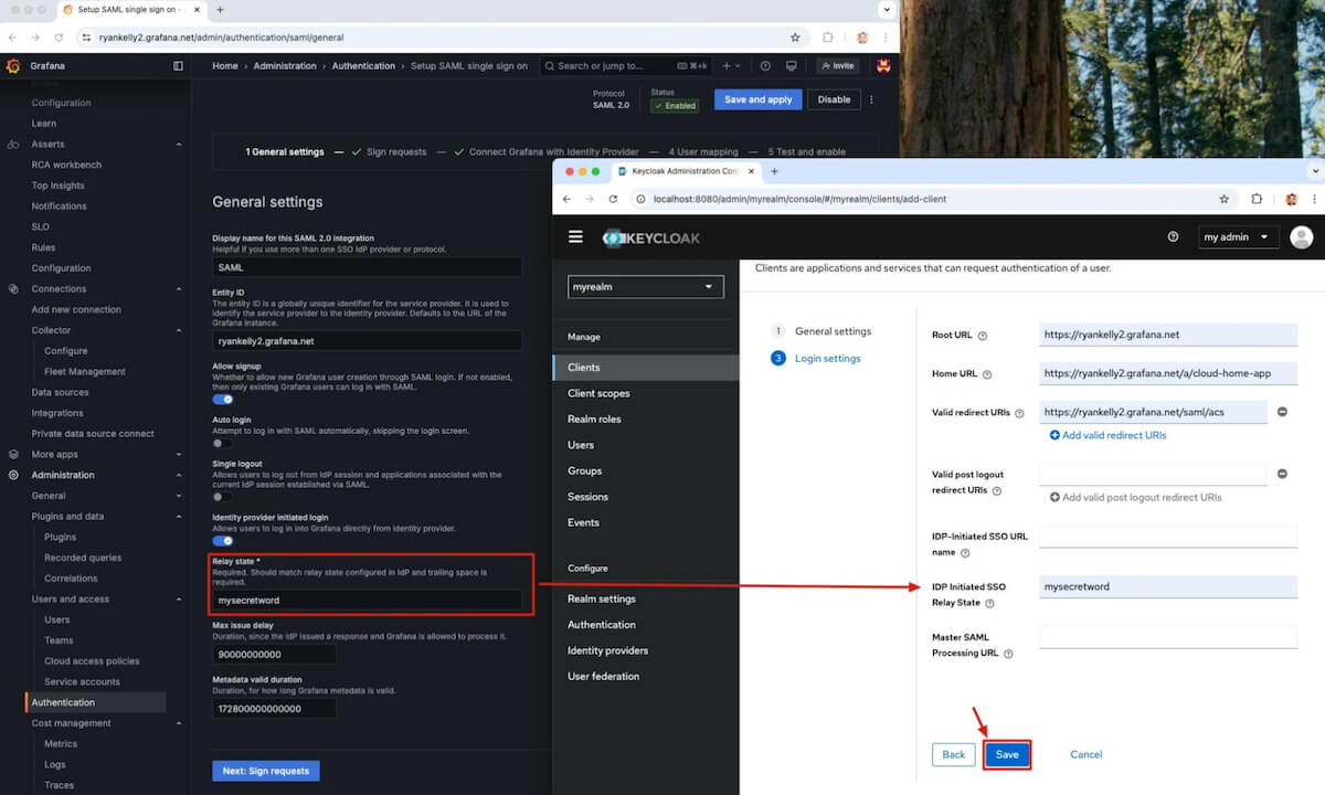

Now, go to General Settings in Grafana Cloud and confirm the Relay state matches the idP Initiated SSO Relay State.
If they match, click Save in the idP.
A screenshot showing the Grafana Cloud relay state matching the idP initiated SSO Relay State in Keycloak

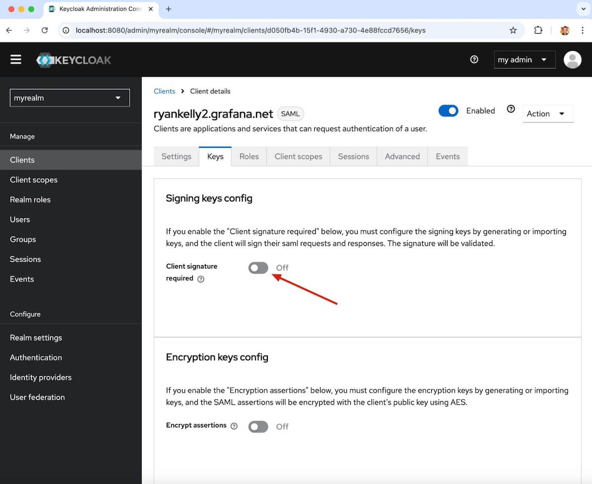

Now that you have the client set up, there are a couple of steps you need to complete to make sure logins work correctly. Since you are not signing requests in Grafana Cloud, go back to the client you’ve created in your idP and click the Keys tab, then toggle the Client signature required button to Off.
A screenshot of the signing keys config option in Keycloak with an arrow pointing to the off toggle

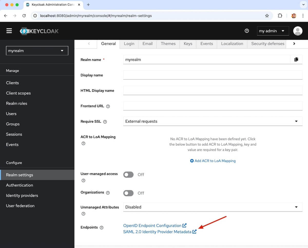

You’ll need to grab the MetaConfiguration from your idP to upload to Grafana Cloud, so navigate to the current Realm settings and click SAML 2.0 Identity Provider Metadata.
A screenshot of a Keycloak window with an arrow pointing at the SAML 2.0 Identity Provider Metadata link

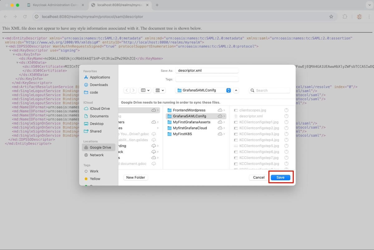

An XML file will open in a new window. Save this file somewhere handy.
A screenshot of a window showing an XML file being saved

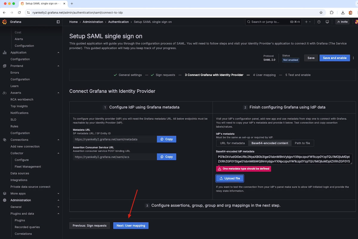

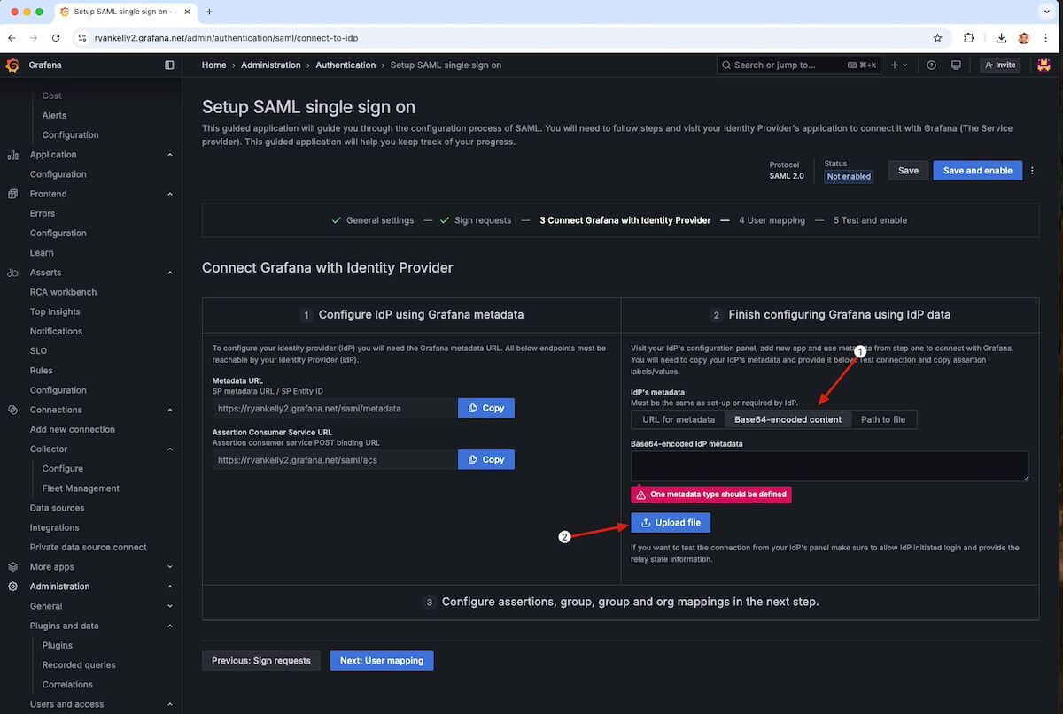

Go back to Grafana Cloud and upload the file you downloaded earlier so Grafana knows about the idP you are using.
  1. In the Finish configuring Grafana using IdP data section, select Base64-encoded content.
  2. Click Upload file.
A screenshot of a Grafana Cloud setup window with arrows pointing to Base64-encoded content and the Upload file button
In the window that opens:
  1. Select the XML file referenced above.
  2. Click Open.
A screenshot of an XML file in a file menu and an arrow pointing at the open button
Back in the Grafana window, click Next: User mapping.
A screenshot of a Grafana Cloud window with an arrow pointing at the Next: User mapping button

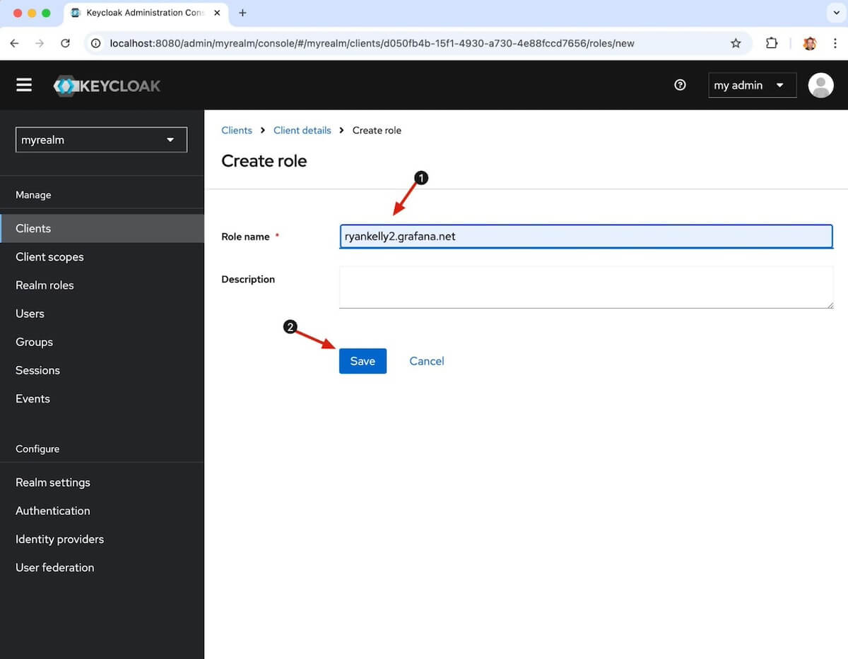

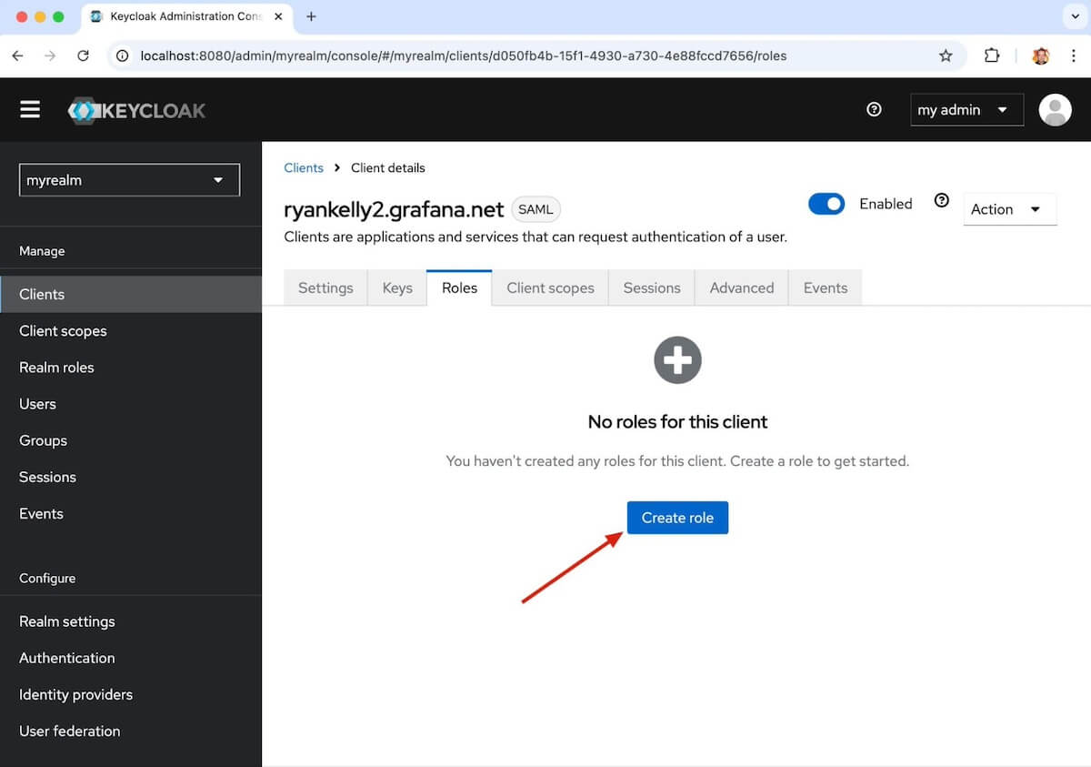

In your idP, create a role for the client you created earlier to add users to it.
Click Create role.
A screenshot of a Keycloak window with an arrow pointing at the Create role button
  1. In the Role name box, enter your Grafana stack name.
  2. Click Save.
A screenshot of a Keycloak window with arrows showing the Role name box and save button

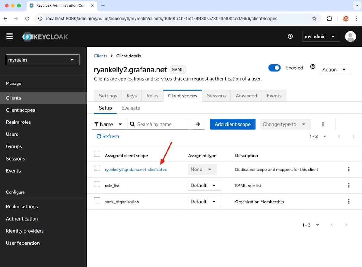

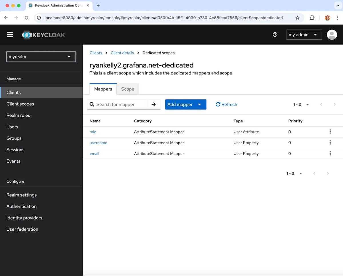

Creating Client scopes to map user attributes to assertions
Your first step is to select the Dedicated scope and mappers for the client.
A screenshot of a Keycloak window with an arrow showing the Dedicated scope
Set up the mappers you see in the screenshot below (role, username, email). The username and email are coming from the user properties; the role you will map with a group membership in the next few steps.
A screenshot of a Keycloak window showing the role, username, and email mappers

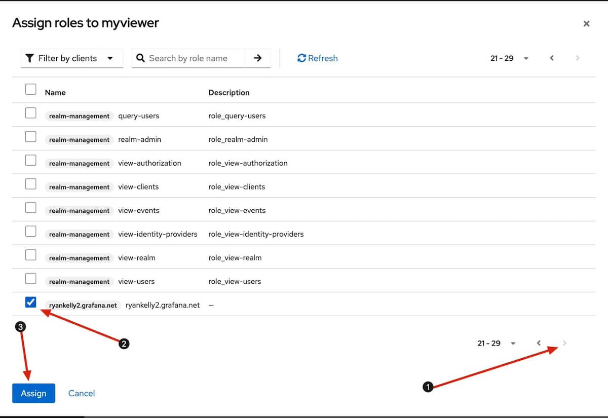

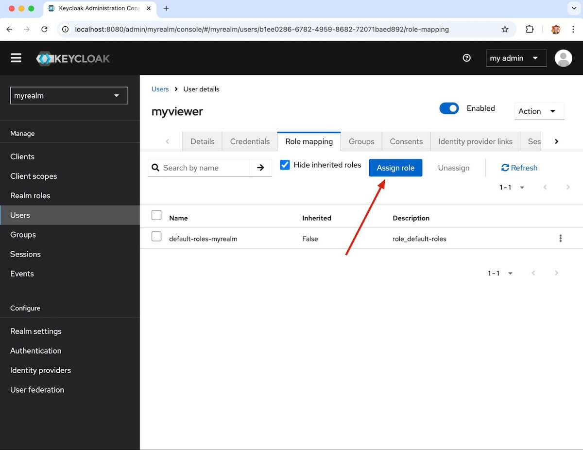

Now you’re going to add users to the role so they can log in to Grafana Cloud from the idP.
In the Role mapping tab, click Assign role.
A screenshot of a Keycloak window with an arrow pointing to the Assign role button
  1. Use the arrow on the bottom right to scroll and find the role options.
  2. Select the role you created earlier in the client settings.
  3. Click Assign.
A screenshot of a Keycloak window with arrows showing where to scroll, a previously created role, and the Assign button

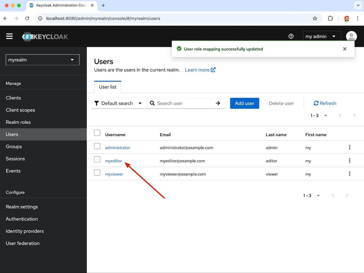

Do the same as above for your editors. (In the screenshot below and going forward in this guide, administrator, myeditor, and myviewer are stand-ins for real usernames.)
A screenshot of a Keycloak window with an arrow pointing to myeditor
Now both users will have access to the Client application, but if they log in they will both be viewers by default. Let’s add a group to make one of them an editor in Grafana.

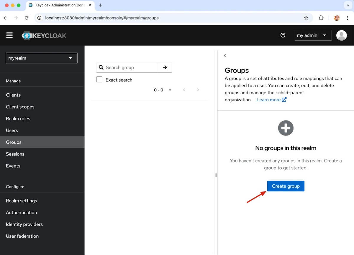

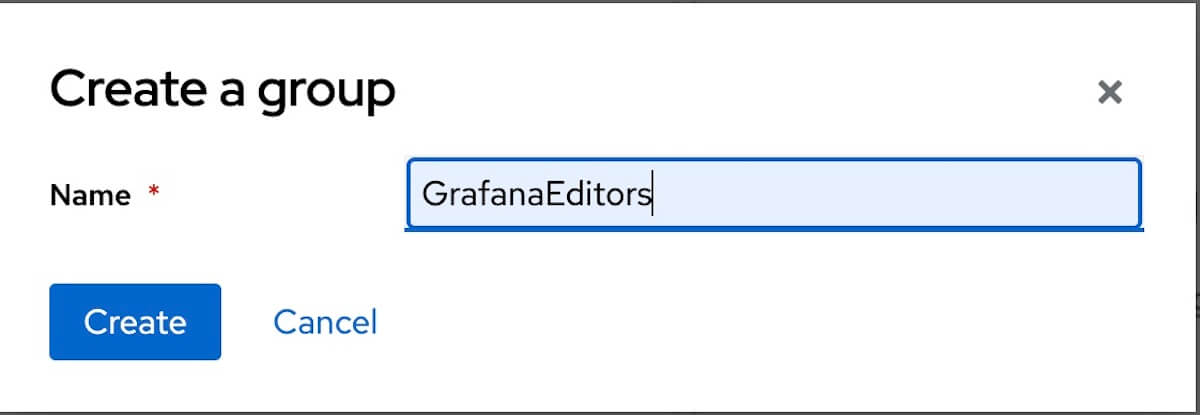

Navigate to Groups in your idP then Click Create group.
A screenshot of a Keycloak window to create Groups
Name the Group GrafanaEditors.
A screenshot showing the name GrafanaEditors in the Create a group box

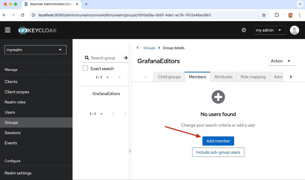

In the next window you see, click Group details, select the group name you just created, click Members, and then click Add member.
A screenshot of a Keycloak window for GrafanaEditors with an arrow pointing to the Add member button

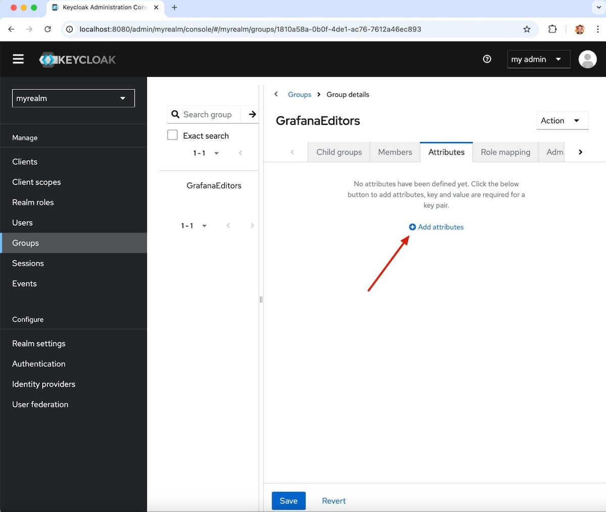

Now you can add an attribute that you will hand off to Grafana Cloud to set their role as editor.
Go to the Attributes tab, then click Add attributes.
A screenshot of the Attributes tab in the GrafanaEditors window in Keycloak with an arrow at the  Add attributes button
  1. In the Key box, type role.
  2. In the Value box, type editor.
  3. Click Save.
A screenshot of the GrafanaEditors window showing the Key and Value text boxes filled in

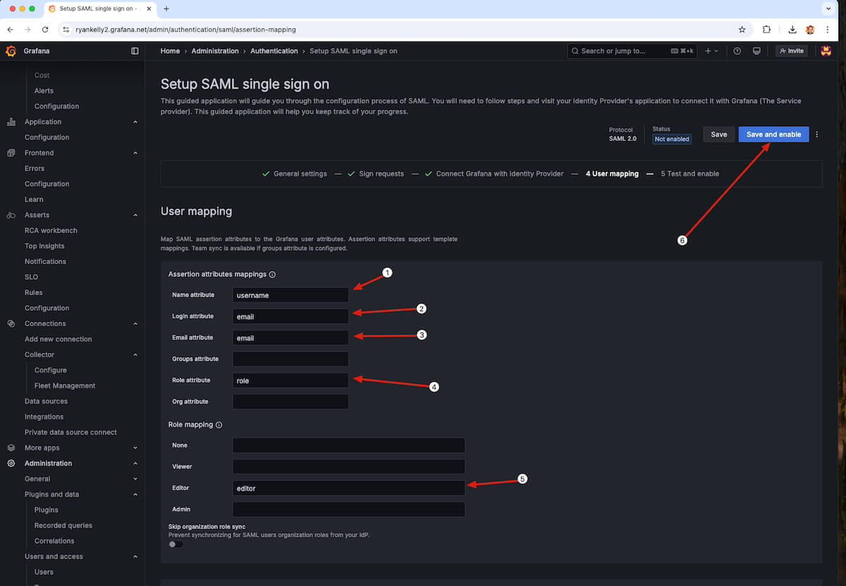

You’re done setting up the SAML idP, so go back to Grafana Cloud to finish setting that up and enable SAML logins.
In the screenshot below, I’ve highlighted what you need to input to configure mappings from the key pair values you set up in Keycloak. These must match and the SAML provider needs to be sending these correctly or login will fail.
A screenshot of the User mapping page in Grafana Cloud's SAML single sign on setup, with arrows showing boxes to fill in
Earlier, you setup username, email, and role in your idP, and you’ll just match up those key pairs here.
  1. Name attribute: username
  2. Login attribute: email
  3. Email attribute: email
  4. Role attribute: role
  5. Editor: editor
  6. Then click Save and enable.

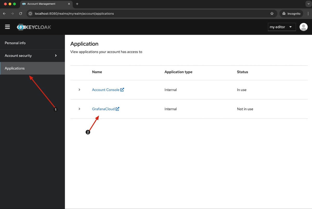

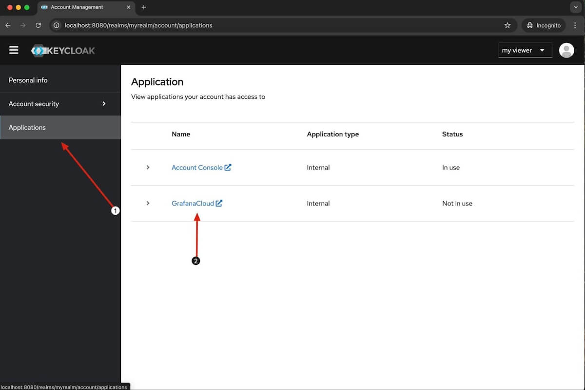

  1. Once you’re logged in, click Applications.
  2. Then click GrafanaCloud.
A screenshot of the Applications window in Keycloak with arrows at Applications and GrafanaCloud

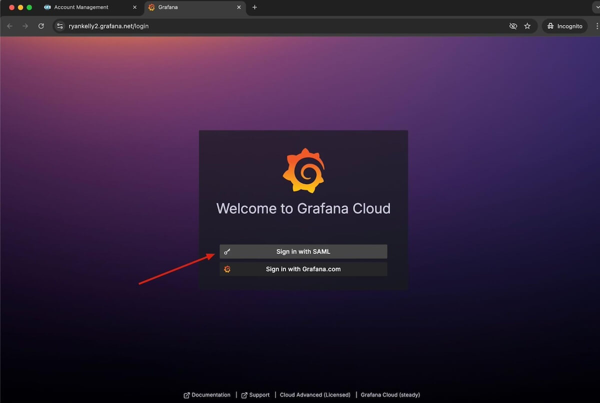

In the new window or tab that opens, choose Sign in with SAML.
A screenshot of a Grafan Cloud sign-in page with an arrow pointing to the Sign in with SAML option

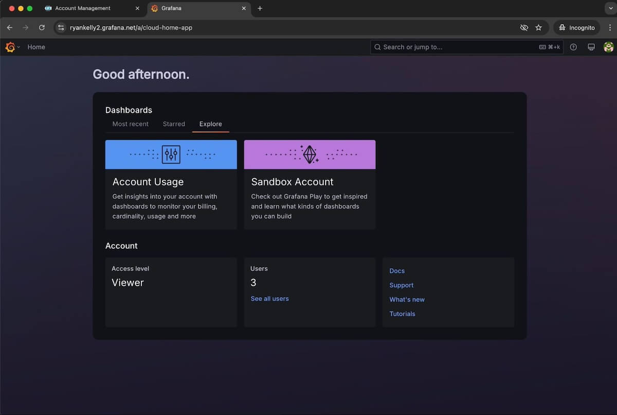

Once you’re in, look at the Account info and make sure the Access level is Viewer.
A screenshot of a Grafana Cloud homepage showing the Access level is Viewer

  1. Select Applications in the sidebar menu.
  2. Click GrafanaCloud.
A screenshot of the Application window in Keycloak window with arrows at Applications and GrafanaCloud
Choose Sign in with SAML.

Check that the access level is Editor.
A screenshot of a Grafana Cloud homepage showing Access level is Editor
