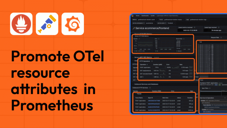

Lightweight APM for OpenTelemetry dashboard, with panels highlighted to illustrate the functionality

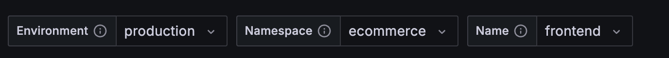

The dashboard filter is placed on the OpenTelemetry service.namespace and service.name attributes:
Screenshot of filters on the OpenTelemetry service.namespace and service.name attributes
