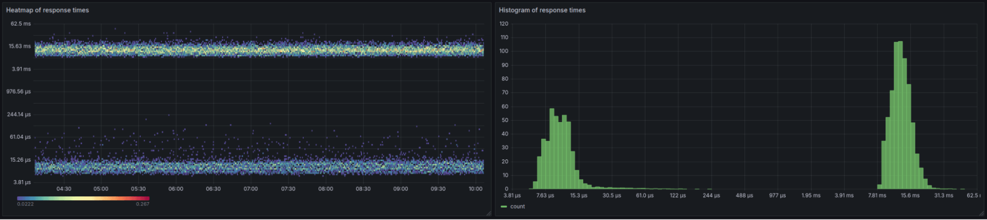

Introduced in Prometheus in 2022, native histograms are a data type intended to eventually replace classic histograms.To illustrate the difference in how they’re visualized in Grafana, the image below shows native histograms in action, with a view of the heatmap and histogram of the response times for a real application.

When instrumenting for native histograms with standard exponential buckets, the resulting time series looks like this:
request_duration_seconds{}
Since all information is in a single series, the way to query the data is different than querying classic histograms. To get the rate of change of the overall count of the histogram, you would write this PromQL expression:
histogram_count(sum(rate(request_duration_seconds[$__rate_interval])))
And to get the 90% quantile, you would write:
histogram_quantile(0.9, sum(rate(request_duration_seconds[$__rate_interval])))
For more information about the syntax and differences from classic histograms, see our documentation on visualizing native histograms. You can also migrate from classic histograms to native histograms.

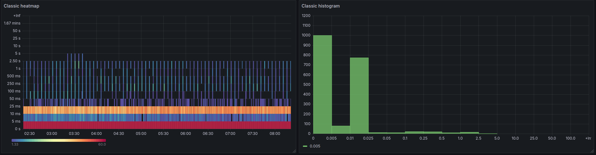

For comparison, let’s go back to the classic histogram visualization we showed before:
We can see that the system handled around 1,000 responses between 0 and 0.005 seconds (or 5ms). In other words, the bucket count for the 0 to 0.005 bucket was 1,000. With classic histograms, the bucket boundaries must be defined during the design of the application, so the boundaries might be customized depending on the use case. In this example, the custom bucket boundary definitions resulted in these time series:
request_duration_seconds_count{}
request_duration_seconds_sum{}
request_duration_seconds_bucket{le="0.005"}
request_duration_seconds_bucket{le="0.01"}
These separate time series mean that to get the rate of change of the overall count of the histogram, you could write this PromQL expression:
sum(rate(request_duration_seconds_count[$__rate_interval]))
And to get the 90% quantile, you must write:
histogram_quantile(0.9, sum by (le) (rate(request_duration_seconds_bucket[$__rate_interval])))
