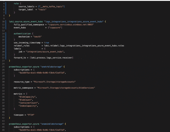

Grafana Alloy, our distribution of the OpenTelemetry Collector with native support for Prometheus, is great for all sorts of needs, including shipping your Microsoft Azure metrics and logs to Grafana Cloud. And as much as we love Alloy here at Grafana Labs, let’s face it, the amount of Alloy configuration required to observe your Azure environments is just too much:
In this example, we used Alloy with the prometheus.exporter.azure and loki.source.azure_event_hubs components to connect multiple Azure services to our Cloud Provider Observability solution in Grafana Cloud. This required over 500 lines of Alloy configuration, but afterwards the solution lit up using our service discovery and out-of-the-box experiences.

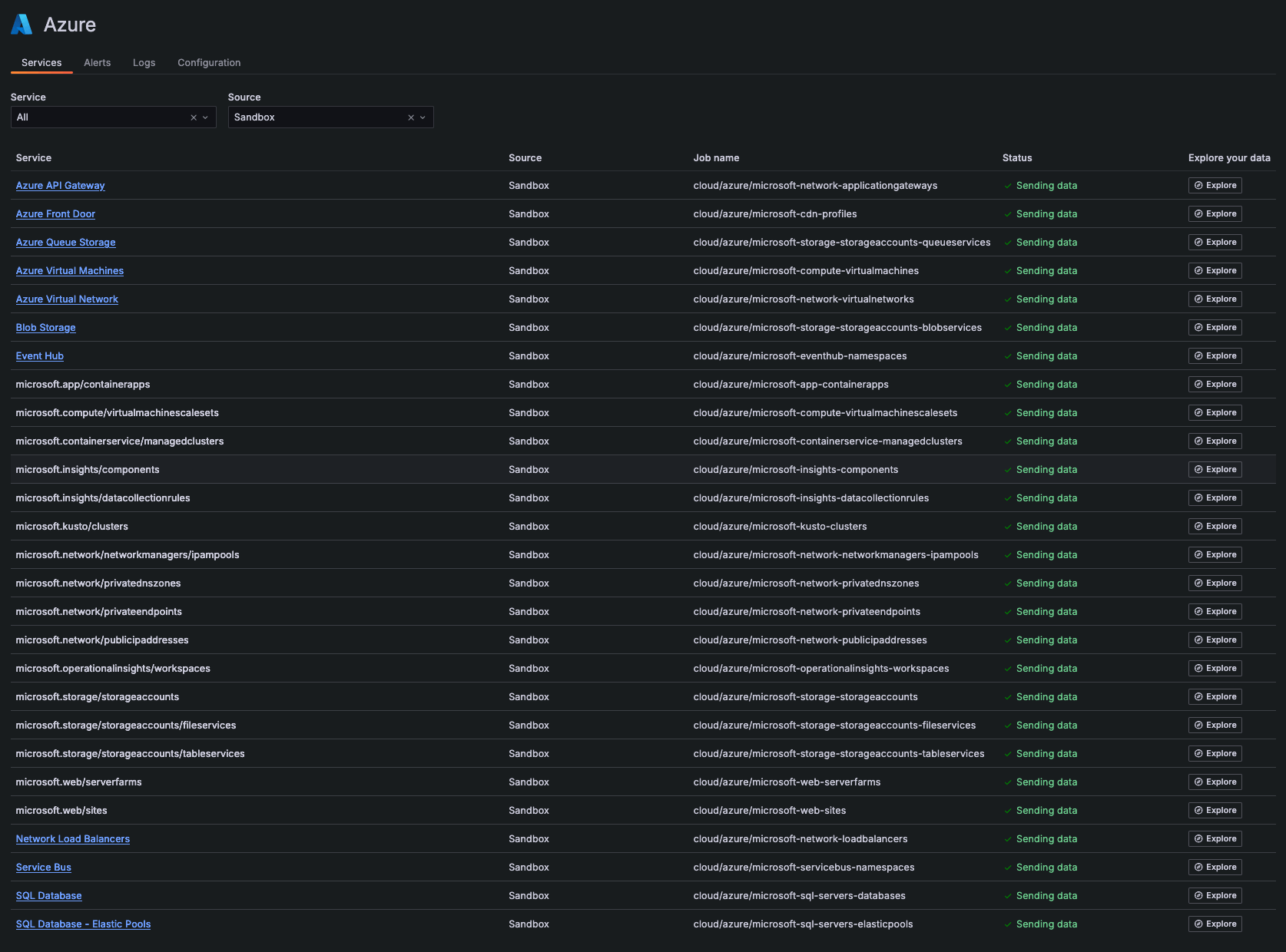

Now you can get the same results and more with our new serverless features for Azure metrics and logs. They’re designed to provide a low-friction onboarding experience so you can start observing your Azure environments in no time. On top of that, we also provide insights you can’t get out of the box with Azure Monitor, helping to ensure you never run out of IP addresses in your Azure Virtual Networks and letting you know when you need to scale your Azure Event Hubs.

The resulting flow is largely the same as running Alloy yourself, except it all happens in Grafana Cloud. You don’t need to set up or manage any additional infrastructure.
