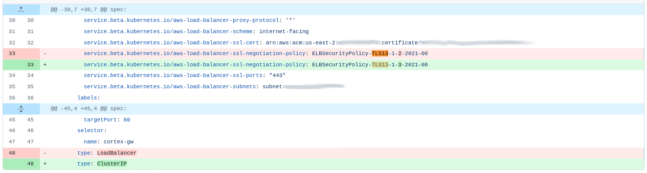

The change actually caused a default value from the base configuration to be unintentionally overridden, resulting in an undesired change in many Kubernetes services from type LoadBalancer to type ClusterIP, causing Kubernetes to destroy the load balancers.
To resolve the problem, we needed to roll back the code change, and then recreate the affected Kubernetes services in order to have Kubernetes recreate the load balancers.

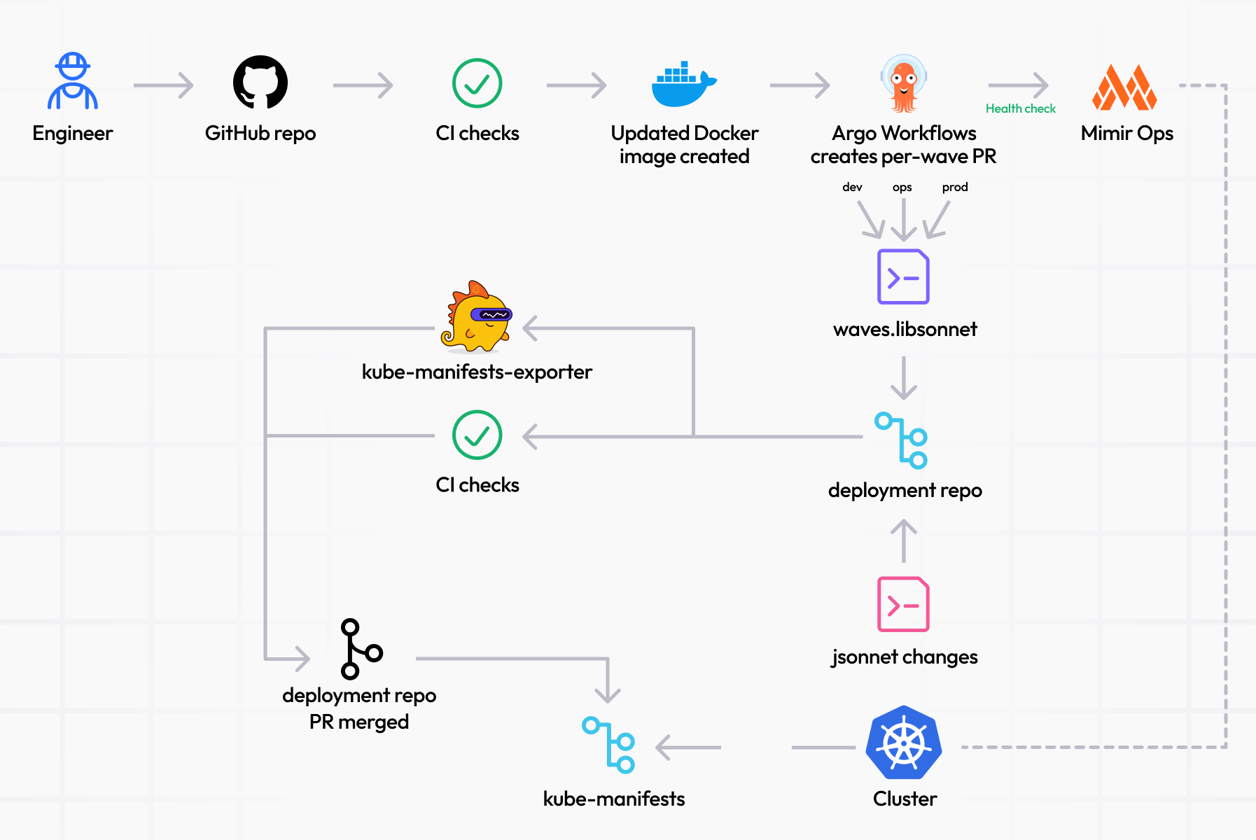

Deployment in waves through to production
At Grafana Labs, we follow good—and no doubt expected—engineering practices. This is evidenced in how we have maintained our SOC II and ISO 27001 compliance certifications. These practices include mandatory code reviews and protections against accidental merging of code in our continuous integration (CI) and continuous deployment (CD) pipeline. The code that made the problematic change on this occasion was raised in a GitHub pull request (PR) and reviewed by a qualified peer of the author before being merged and deployed.
We use the concept of waves to stagger the deployment of changes—first to our development environment, then to staging before canary deployments in production and gradually across production. After each wave we observe the systems to be assured of their health before we continue. Typically, this observation period lasts at least 24 hours. We believe and speak about reducing the blast radius of changes, and we use waves to practice this.
The diagram below illustrates how the PR to create a wave is dependent on the health of the previous wave.
Waves workflow
In a case like this TLS update, we would employ what is effectively a feature flag to conditionally apply changes to specific waves. When a library change is made, the updated version would be staggered through the waves, beginning in the development environment.
Without this flag, we would deploy without waves. This is what happened in the case of this accidental load balancers removal. We did not deploy the change as a wave into the development environment through our automated process—it was done manually—so we missed the unexpected behavior of the Kubernetes Crossplane operator and its effect on services.

Over the last quarter we have been developing a Crossplane Managed Resources exporter to help us improve change validation and visibility. This is now in beta testing within Platform engineering. When we simulate its use against the change that caused this outage, we can see a clear diff.
