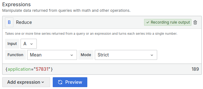

In the screenshot below, you can see a single expression that is already selected as the rule output:
A screenshot of a single expression that is already selected as the rule output.

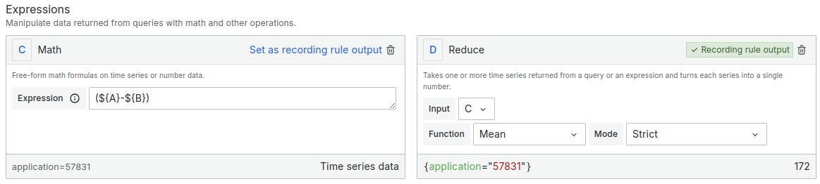

And here, the left expression is showing the Set as recording rule output action link:
A screenshot of an expression expression showing the Set as recording rule output action link.

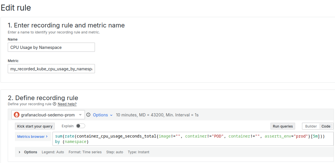

Let’s say we often want to visualize the CPU usage of several Kubernetes pods, broken down by namespace. If we make the same query in several dashboards, it makes sense to record it:
A screenshot showing how to enter a recording rule and metric name.

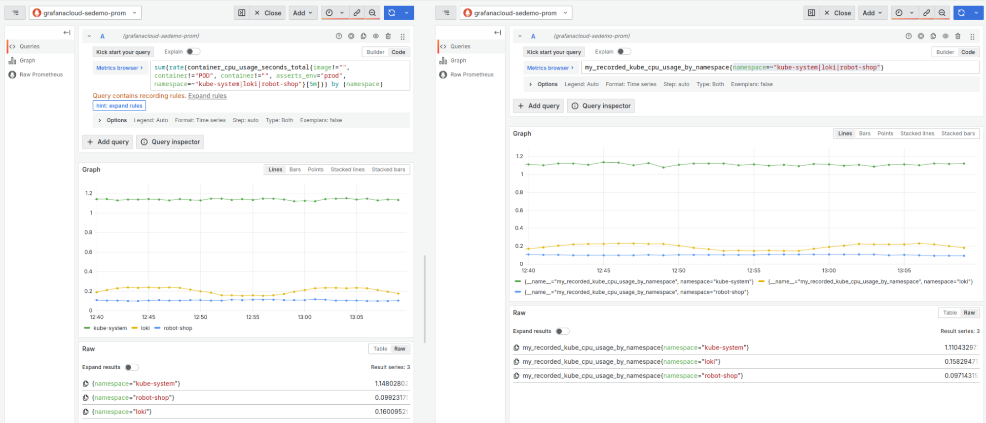

Then, we can reference that data with my_recorded_kube_cpu_usage_by_namespace. Here’s what the underlying query looks like next to the recorded series:
A screenshot showing the underlying query next to the recorded series.
You can see the recorded data following the queried data very closely. The recording rule saved every dimension from the original query — like with Alerting rules, you can query many series with just one rule.
Note how the recorded series also inherits the labels from the original query. This means you can still correlate and filter your recorded data, the same way you did before! Also notice how the same label matcher works for both the original and recorded series: namespace=~"kube-system|loki|robot-shop".
Recorded data often has a “sampling lag” when directly superimposed onto the original query. This is because the recording rule runs once a minute, which may not line up perfectly with the time that you issued the query from the browser. This is especially common for data with high variance. To reduce sampling lag, try increasing the evaluation interval of your recording rule.
