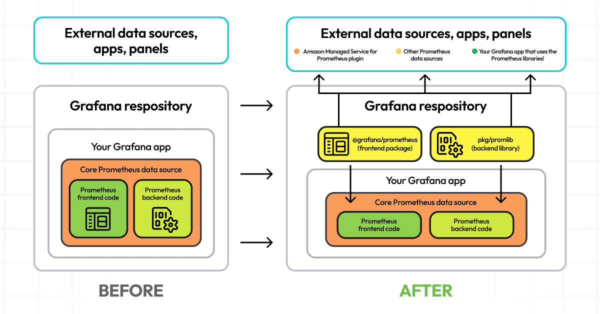

The challenge at hand
The Prometheus data source has long existed as subfolders inside the Grafana application. It included all sorts of code from Grafana, and over time the data source made its way into many features related to our OSS projects, including Grafana Loki, Explore, and Grafana Alerting.
The code, however, couldn’t be reused outside Grafana, so over time custom configurations were added to accommodate third-party vendors. For example, the code config had logic that enabled AWS users to create a Prometheus data source connection inside Grafana to query their Prometheus data in AWS. This code lived next to generic Prometheus code, even though AWS authentication was related to Amazon managed services, not OSS Prometheus.
But when the idea was first proposed a little over a year ago, there was reluctance internally because of the heavy lift and requisite code changes. In fact, Grafana Labs had never undertaken a rewrite of this scale before. There are ~70,000 Prometheus queries in Grafana every day, and we were essentially suggesting that we tear out all the guts and put them somewhere—all without impacting that high volume of people who relied on it every day.

We looked at multiple ways to separate the frontend and backend code:
  1. Create a separate repo only for backend code
  2. Move all the frontend and backend code into an entirely new repo
  3. Create workspaces
We went with the third option, as the other two would have created more problems. As a result, we introduced GoLang workspaces to the grafana/grafana repository for the first time. We started by making a small package as a module to test, then we updated our build pipeline in Grafana and our linting code. We also made a Prometheus backend as a module and iterated from there.
By having Go modules, we improved our grafana/grafana repo and allowed other engineers to have their own modules inside grafana/grafana. So while the code is still in one place, it’s separated thanks to go workspaces, giving us separate versioning and total control of our code.
