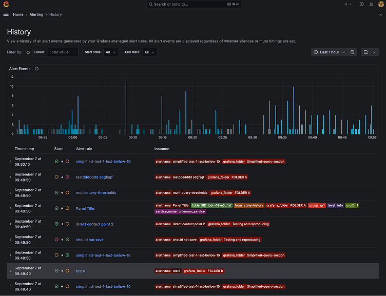

Access the page by clicking on the “History” item in the Alerting section of the Grafana main menu. The page has three parts — a filters section, an events chart, and an events table.
Use the filters at the top of the page to narrow down the displayed history events based on labels or state. You can also click on a label or a state in the table to quickly add it to the filter.
To define the time period you are interested in, either use the selector above the events chart or just drag an area on the chart itself to zoom into it.
Filtering by time range in the UI
The events chart displays how many historical events (an instance that changed its state from one to another) happened over time. This lets you easily spot trends or notice particular periods with a high number of events.

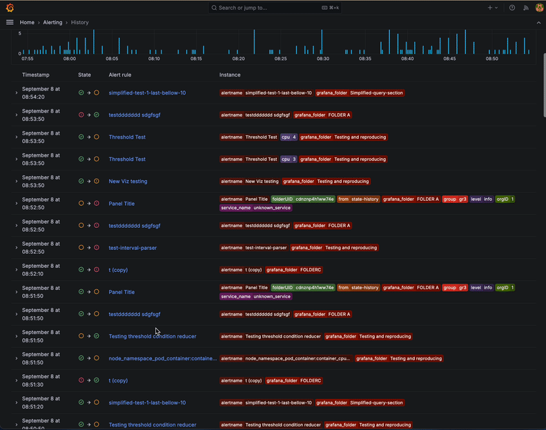

The rows in the table represent the individual events. Each row displays:
  • A timestamp
  • The start and end state of the transition
  • A link to the alert rule
  • The labels which define the instance
Found a particularly interesting alert rule and want to focus on it? Simply click on the alert rule name and you’ll be navigated to the History tab of the alert rule’s detail page. There you can continue your investigation without being distracted by other events.

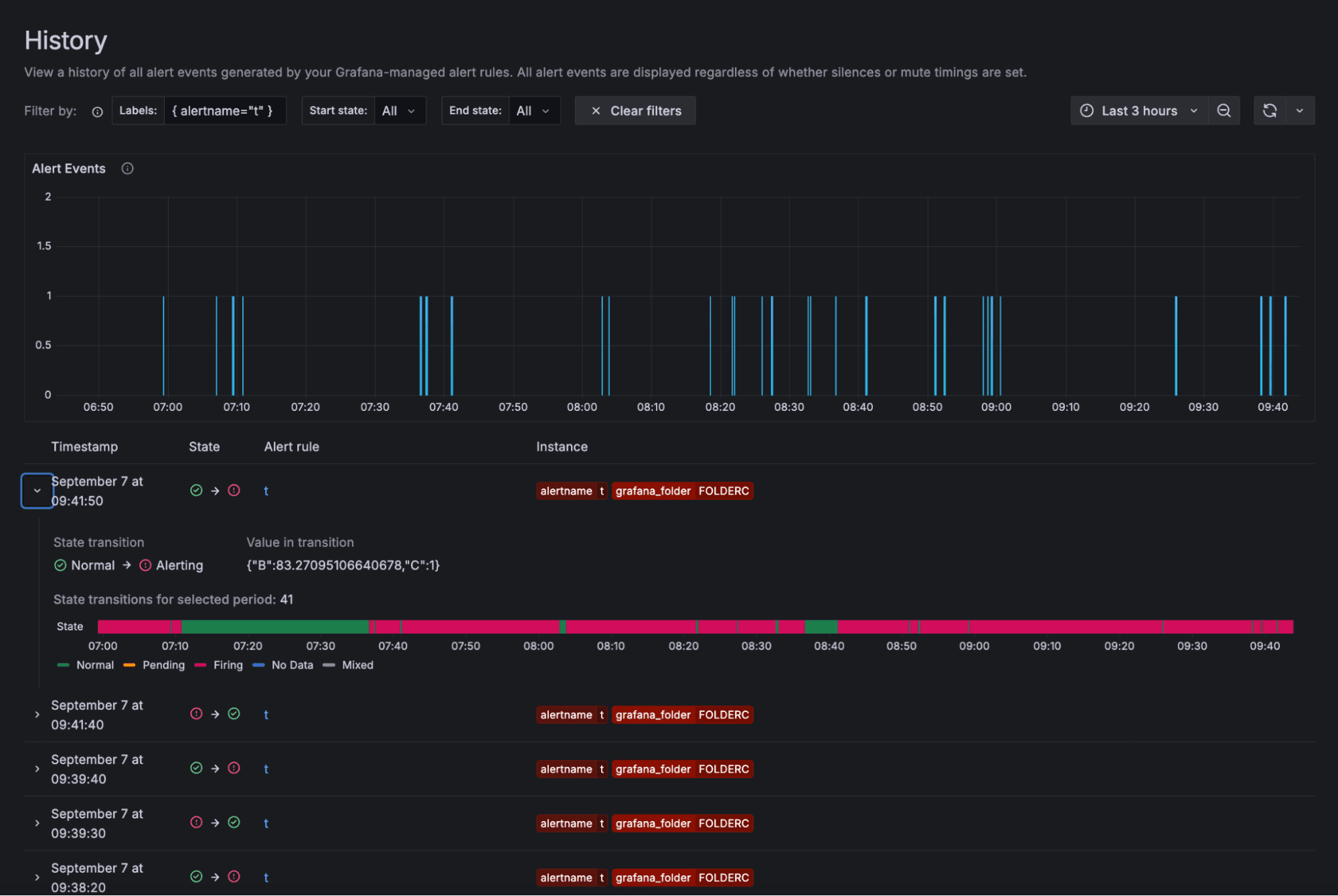

You can also expand a table row to reveal additional information — the query values and expressions of the alert rule, along with an additional chart representing the alert instance’s state throughout the entire selected time period.
For example, consider a scenario like the one below, where the chart reveals that your alert instance is frequently toggling between “firing” and “normal” during your selected period. In that case, it might be worth taking a closer look at how the alert rule is configured and then fine-tune the threshold or the pending period.
