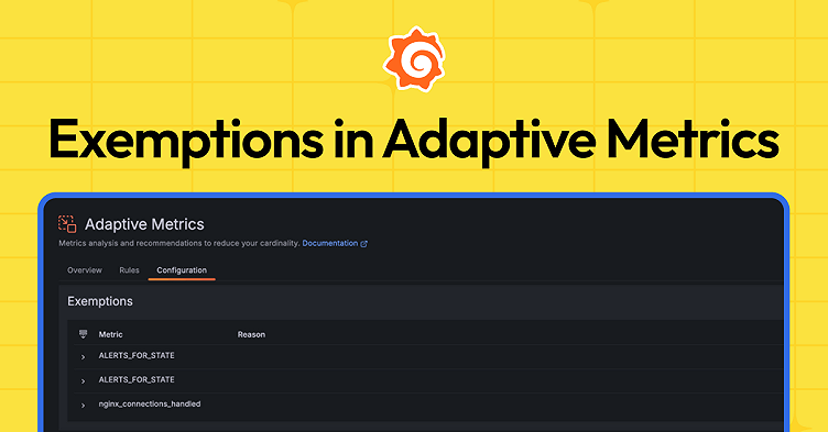

How Exemptions work in Adaptive Metrics
An Exemption is a capability in Adaptive Metrics that allows you to identify critical metrics that should be preserved, and therefore excluded, from the recommendations engine. This will provide your teams more control over your metrics and help maintain the integrity of your important data.
A screenshot of the Exemptions feature in Adaptive Metrics.
There are four types of Exemptions in Adaptive Metrics:
  1. Keep a whole metric intact: Ensure that certain metrics remain untouched by aggregation, preserving their complete data set.
  2. Preserve a specific label across all metrics: Maintain a particular label in all metrics to ensure consistent data categorization.
  3. Retain a label on a particular metric: Keep a specific label on a specific metric, maintaining detailed tracking for important metrics.
  4. Disable recommendations entirely for a specific metric: Prevent any recommendations from being applied to a particular metric, ensuring its aggregation remains in place.
By leveraging these Exemptions, you can customize how Adaptive Metrics handles your data, ensuring that essential information is always available while enjoying the benefits of reduced cardinality and costs.
